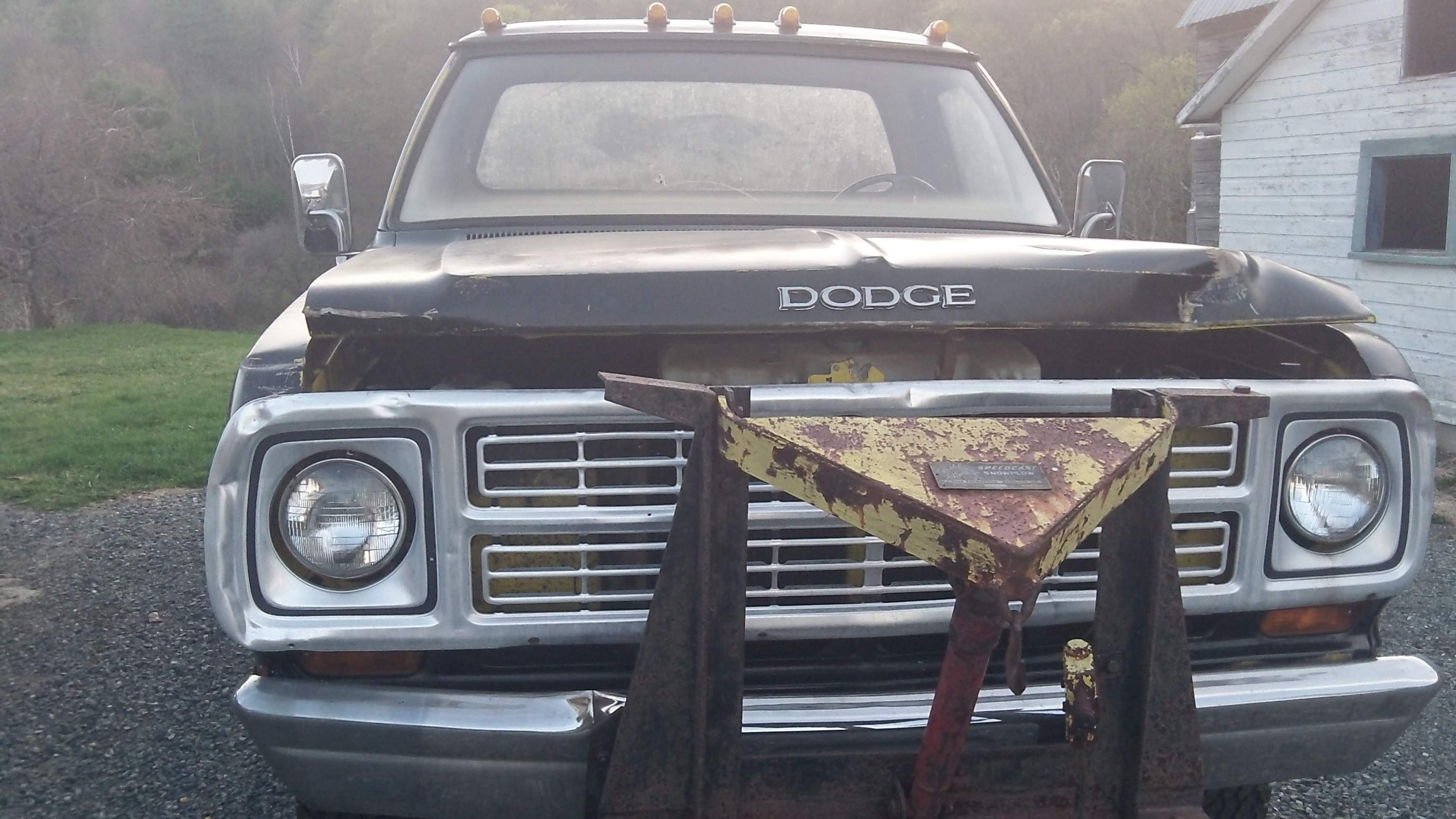

A face only a mother could love...
/ Yard truck question- Dodge #11
