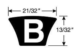

The belt is the standard B204 industry standard.
A-3492 Woods Replacement Belt - B204​
B204
Color Black
Length 207"
Material Polyester Cord
Thickness 0.45"
Type Wrapped
Width 5/8"
V-Belt Supply also sell the Kevlar belts, I couldn't find a B204 in the kevlar material. Only a 5/8x208 was close.

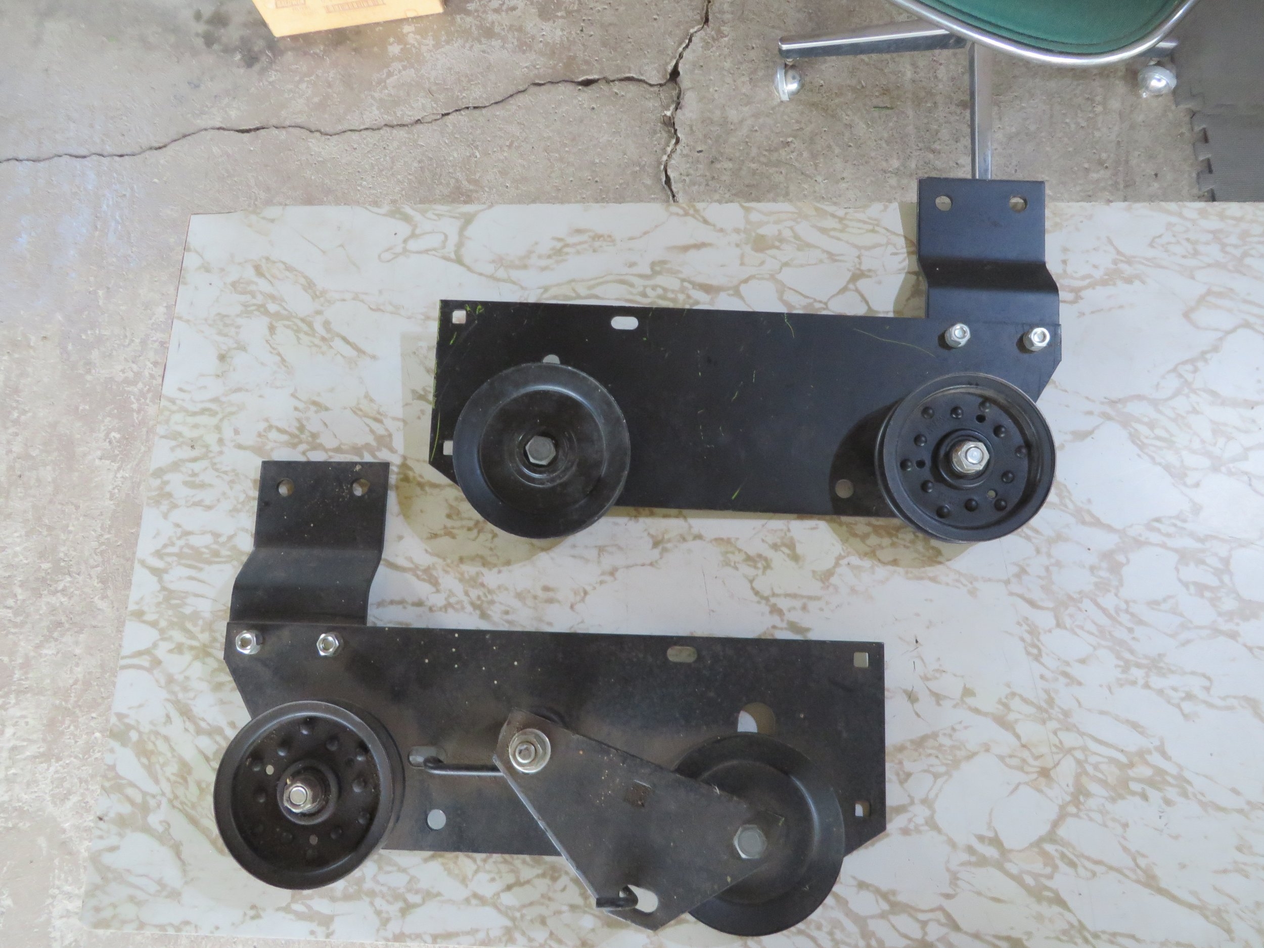

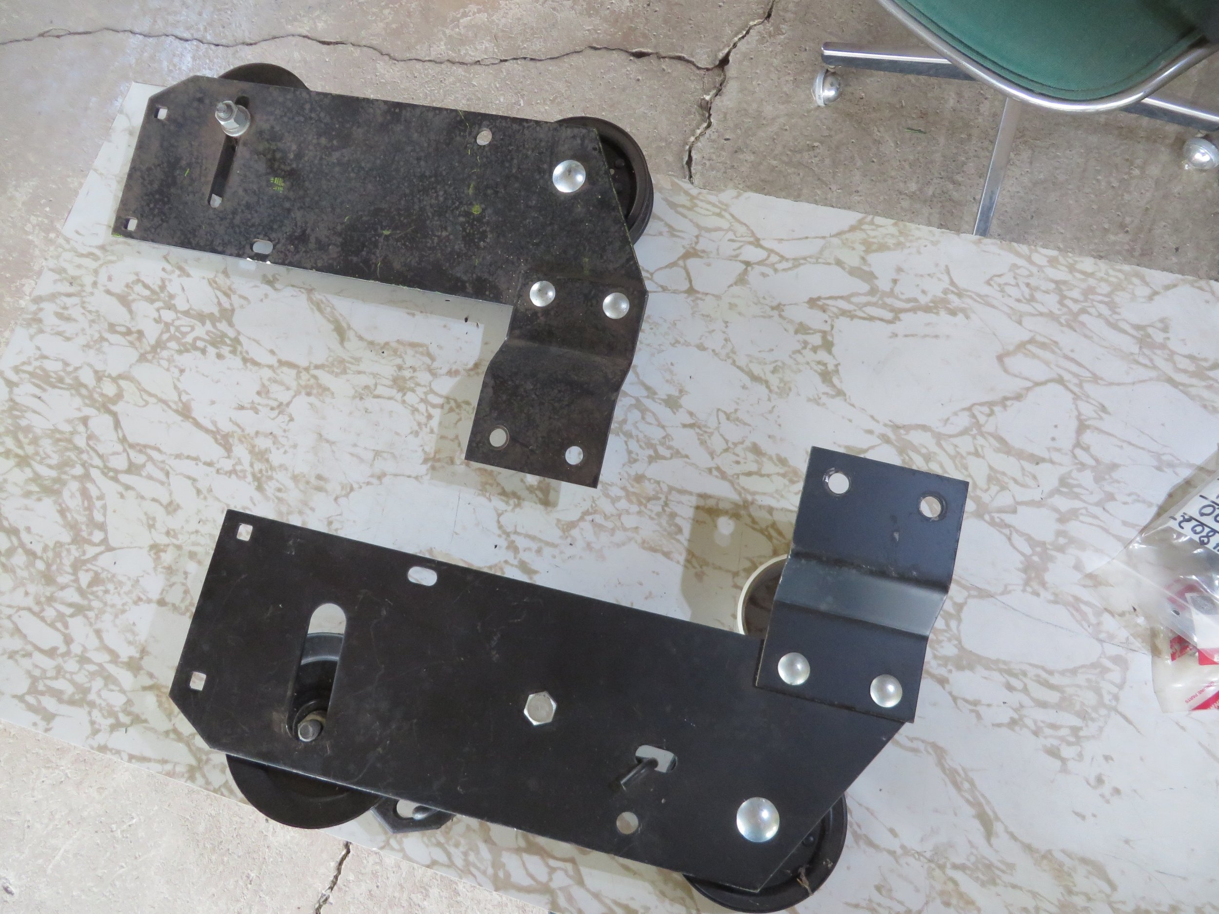

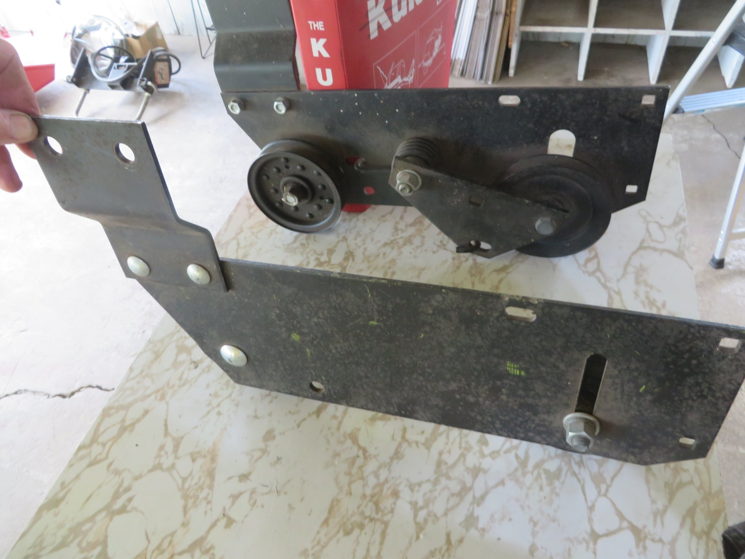

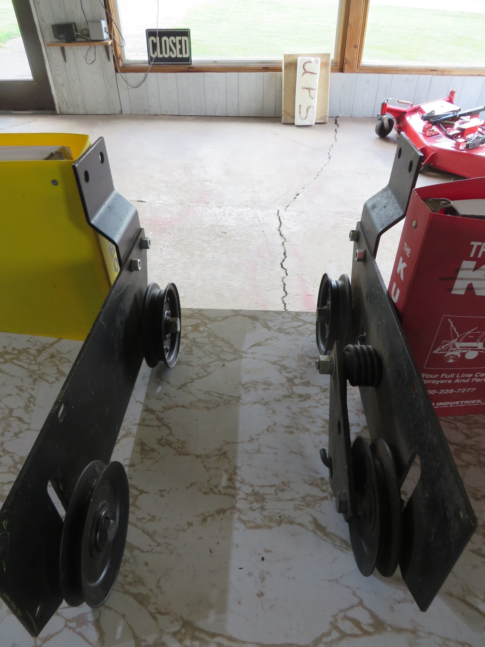

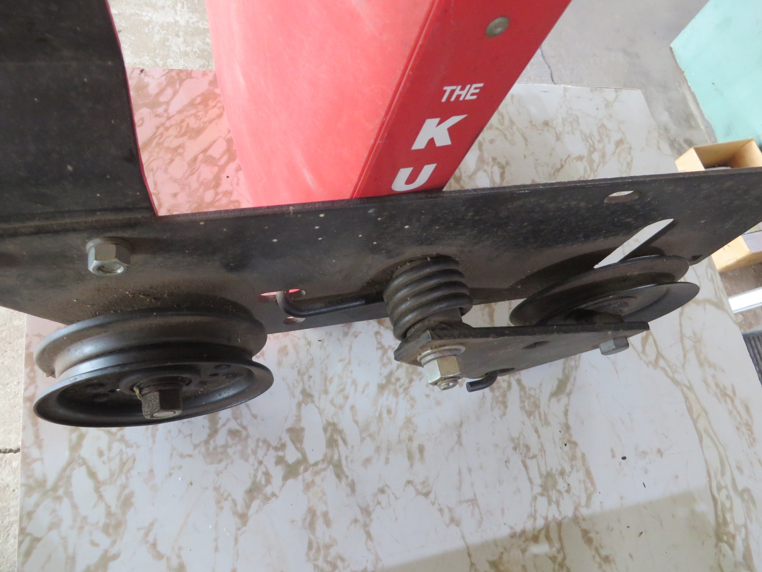

I have dug around in my warehouse and found the front mounting brackets for the YM155 tractor and the YMM45 mower.
They are still brand new. A little dirty but never used.
I will send you a P.M. which you can open in the upper right corner on TBN.
