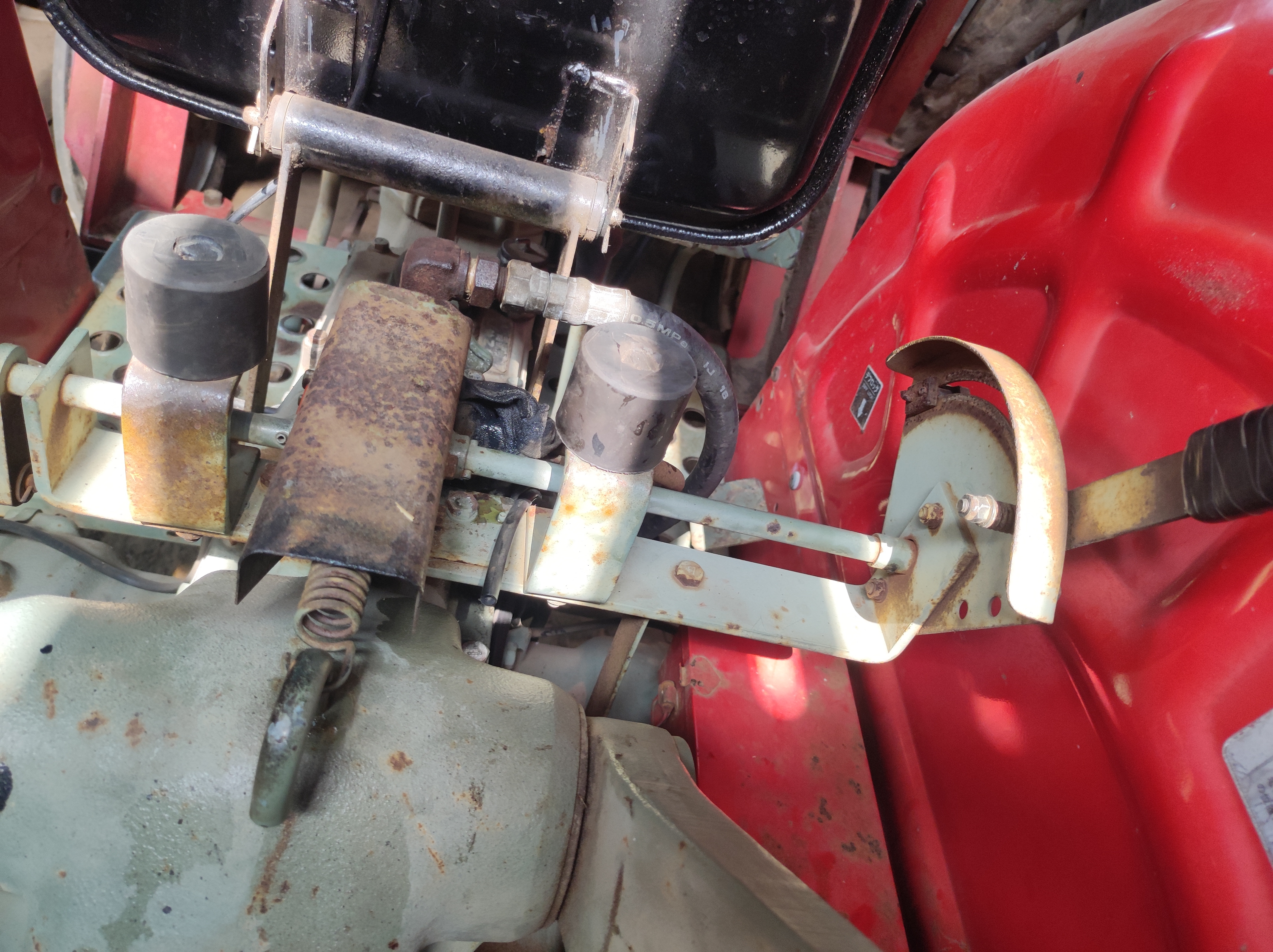

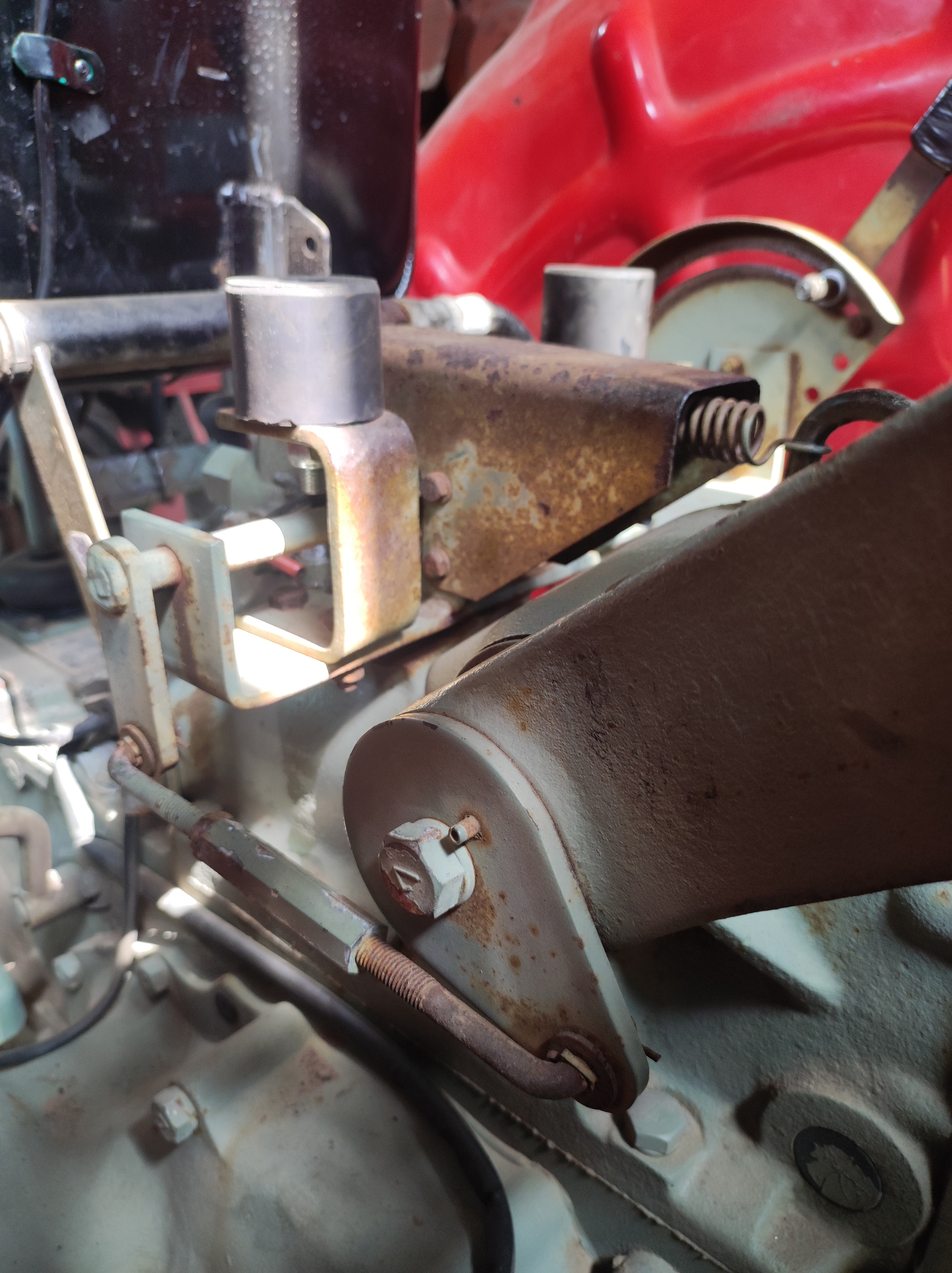

I was looking a lot under seat how it works, and I can not understand how it should stop at any control lever position is pointed. Because control valve only does Raising or Lowering and Neutral, I assume somehow Control Lever - Feedback Rod (of hydraulic lift) - Control Valve Rod, should be in sync, but I have no idea HOW Control Lever can affect hydraulic lift so it is FIXED at that position that is proportional to Control Lever position.
OffTopic: Right now it is super hard to work with it, even attaching sprayer with triangle is super hard, because it can't stop raising or lowering. I found work around just close that little valve with tiny rod lever and hydraulic lift never lowers, just can go up at any position, and this is how now I can spray field, because before that it just kept raising or lowering until sprayer hits ground on its own... When I found Neutral Position it is very tricky, if sprayer gets lighter or heavier (as I fill it up) it raises or lowers... (gets out of neutral position)... It feels way more like Draft Control than Position Control... Super weird for me.
I attached some photos, maybe it could help a little
/ Yanmar YM3000 3 Point Hydraulic #6
Look under the cover the of Hyd. Valve. What looks like is happening is your handle is in the highest position. And the spring looks to be applying pressure to the control valve trying to lift if still. The spring should not have pressure on the control pin. fully lifted. Push the handle forwards the lowest position. And there should not be any pressure on the pin. " spring might be to tight" still trying to lift it. Unhook the spring to the control valve and see what happens . The pin sticking up on the side is the lower and lift rate. Neutral is pointing Straight up. I believe for words increases the lowering rate and Neutral to back wards is the lift rate. Control valve HV-451 which should be the same one. No doubt you clearly have a leak. The soaked rag is a good sign of that.

I will try what you suggested, just wanted to quickly specify that soaked rag is not because of leak - I did that to prevent metal pipe rusting. To clarify it, there is original metal hose-pipe that goes from the front and into control valvebody, but is disconnected because Front Loader is attached and Hydraulic Hose is used. So metal hydraulic pipe is not removed (because I see it would be hard to get it out) and there is no point in getting it out, it doesn't interfere with anything, so I just soaked it a little in oil and put some inside so it does not rust quickly. (It was like this when I bought it).

May be correct, but I have never seen the spring hooked on the air breather before.
