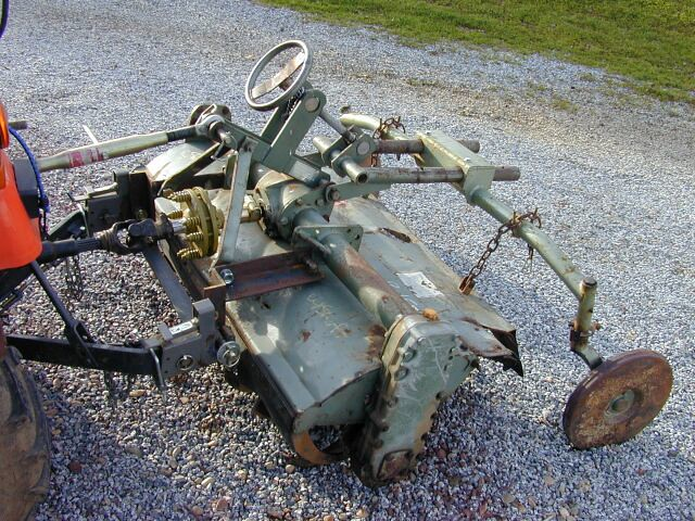

Eric,
I've been poking around on one of my best hunt for Yanmar stuff on Japan sites. Yahoo.jp :)
So far this tends to be the closest candidate to your tiller. Since you are missing parts, it's the best I could align by all the pix you gave. It's sitting on a plastic gray pallet too.
ヤンマートラクターYM2010のロータリー 純正RS14... - ヤフオク!
If this is the MATCH to your tiller, I have a program that snags all the images off that page to save. This way, those highres images could assist you in finding the other parts or you can fab something like it.
Oh, if anyone has YANMAR FEVER, then this is the place to enjoy! Type in ヤンマー YM
That is Yanmar in Japanese and YM. :)

That tiller is almost identical. The only difference is that the two spring loaded rods that control the back flap are connected to two arms on mine that are missing from the pictured tiller. These arms bolt to the same plates as the H shaped tubular part does, but on the other side of the plates. You can see this in the pictures I posted. So really it is the same tiller, it's just that mine has these two extra parts. And mine is of course missing the wheel assembly. Thanks a bunch for finding the tiller.

Ah, good eye. 🕵️‍♂️
So, it's an RS1404-like tiller you have. Now the question is, is it a RS1504 instead? Those last 2 digits deal with how the tiller mounts to the tractor, the first two digits is the tiller series of sorts. The 14 & 15 often go hand-in-hand in the manuals. Sometimes a 16XX is tossed in the mix as well for even more confusion. haha
Oh, I did notice the REAR wheel assembly missing on your tiller. That is somewhat critical for leveling and to place a nice soil crease on the next lap of a pass to keep things uniform.
Now, on that RS1404, did you see another WHEEL? It's at the top of the unit. It's a spoke wheel for adjustments.
Also, in the images, did the tiller hookups look the same? same interfaces? If not, maybe an RS1402 is the match then. It's all tied in like that. Plus, the 14xx, 15xx 16xx all have various widths of the same tillers arrangement. The Yanmar tiller models can make a person dizzy. 🤪

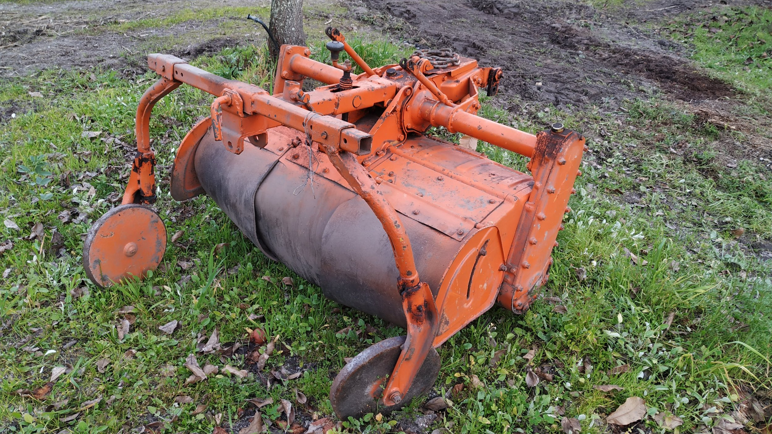

Quit using it yrs. ago. Pic. I used on CL. when I sold it. Only ran a couple days literally. It was for My mothers garden back then. We went to the back and dug this one out. Wrong Dr shaft reflecks that. Which I kept the shortened one. And for the exact reason as for what just happened. ;)

That ORC. is Spring pin loaded. Mine is set by a pin you have to use a punch. PITA. not that easy to get to. That and the bolt on top link wasn't all that user friendly no doubt. I use the 2000 for a FM. so I have to use a ORC.. Used this setup for over a decade and still today. ORC. stays on now thank goodness or I would of had to of replaced it with a Quick pin... Look hard and it's down there!!

Really nice details of a RS1400A

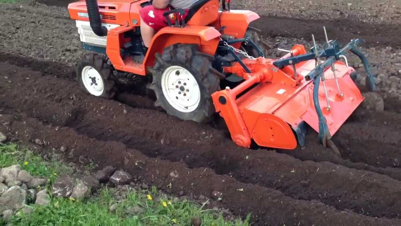

It's really hard finding ANY images on the web for a Yanmar tiller in action and to use the rear hiller discs in the back the 'correct' way. This might be the best I've seen so far. Howbeit a Kabuta with a Yanmar modified RS1300. LOL
This is a huge time saver for gardeners. From beans, peas, carrots, turnips, potatoes and much more. Getting those tilled up hills in a perfect arrangement is priceless.

Now I'm getting drawn into the tiller strangeness!
I wonder if the guy in this picture (tiller painted orange - is that even a Yanmar tiller?) is doing it right. Seems to me the flat side of the wheels should be pushing the dirt into ridges. The way he has it, he's forcing dirt into the wheel bearings.
And - Carey's RS1400 is different from my RS1400 although both have the same RS1400 decal. His has the vertical rods, and three discrete hinges, for the back flap. On my RS1400 the flap is attached with a 'piano hinge', ie continuous all the way across. And chains down to the flap like in the photo just above this. (post #38). That photo shows the wheels mounted flat side out. When I tried that, they wouldn't track, they just left gouges at the outer edges of the tilled area. When I moved them to flat side in, like the tiller decal shows, they traced fine.

That is a Kubota tiller. I had the same exact one on the B7000 I used to have.
The gauge wheels are pointing the wrong way for some reason. Should be pointing backwards. Those wheels are what controls the depth on these style of tillers.

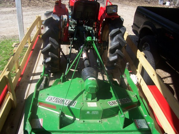

I don't really have a picture of it in action but here is one from the ad when I sold it.
