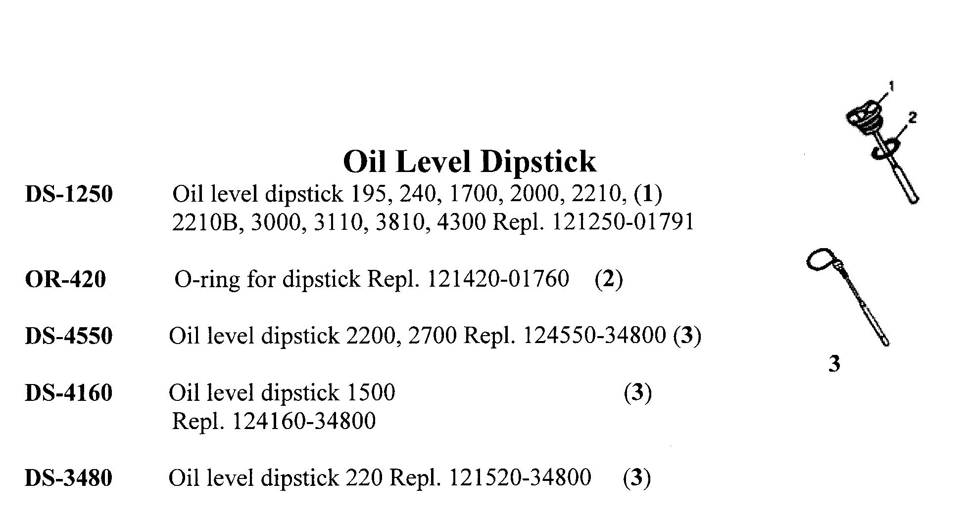

It had began to smoke a little but as his son was mowing a week or so ago it blew the dipstick out and had bad blowby.
Here's a pic. of my 2000 DS. :eek: My parts book # DS-1250 for the 195,240,1700,2000,2210, 3000,3110,3810,4300. Must of been one heck of a blast to blow the DS.out.:laughing:
mine is the same.. except painted yellow!
I'd expect a detonation inthe crankcase to blow that sucker out!

But I think the early ones - Revision Level - (blank) or Level 1, had a slip-in dipstick on the right side.
Or maybe this is a FrankensteinMar.

I have no idea but this is what Hoye shows for the 1700. Yanmar Tractor Parts: DIPSTICK LUB. --- EMAIL FOR AVAILABILITY ---
I did a little more research and I have a pdf parts manual for the 240. It shows an "old type" with the rubber plugged dipstick and the new type with the screw in dipstick. So I guess it depends on which one you have.
A little more evidence. http://www.stevenstractor.com/parts/compacts/yanmar/engine-parts/oil-dipstick-1.html and http://www.stevenstractor.com/parts/compacts/yanmar/engine-parts/oil-dipstick.html

To have built up enough back pressure to blow the dipstick wouldn't the vent have to be clogged/plugged? and it seems to me that the engine would have had difficulties cranking over, unless of course it was being started in decompression mode.

My Parts Manual. When I change my Oil I insert it to the Threads and it shows up on the Hatch Marks Full at 5qts.
