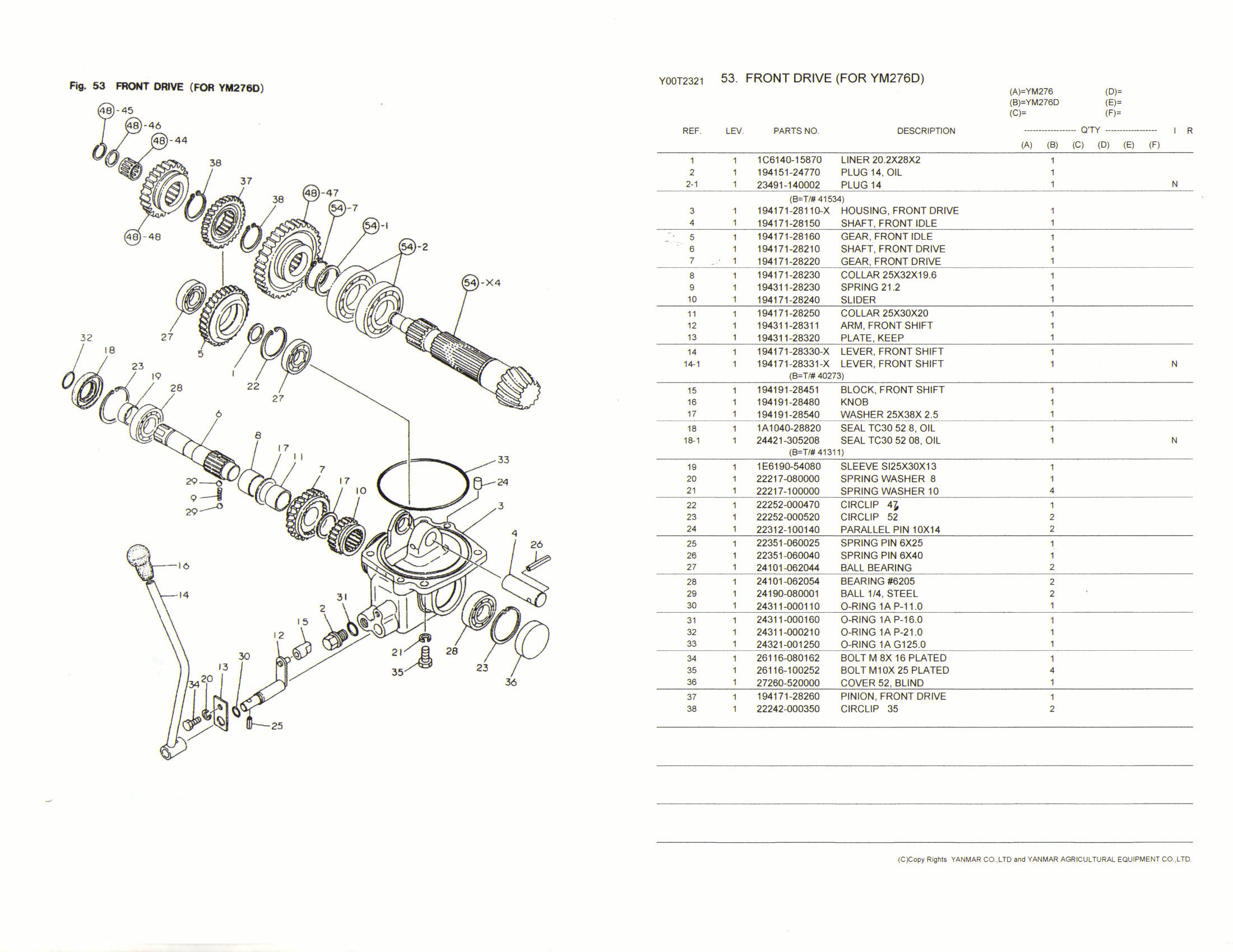

Hello, I am having trouble figuring out the 4WD mode. Am I correct that this Tractor isn't full time 4WD? The person I bought it from took it in on trade. He thought the 4WD is not full time. According to the manual it appears the shifter on the left side below the seat is for 2WD to 4WD. I'm still in 4WD in either position. Thanks for replies!

This is what you have. Not surprising, I could have been wrong earlier. It could be piin #25 sheared.

I think that roll pin that connects the shifter to the shaft is known to break or come out.
Just look and see if the shaft is moving when you move the lever
