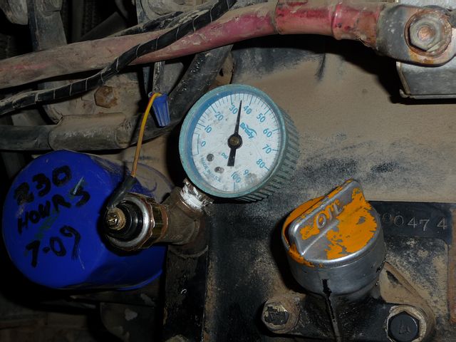

I put a gauge on temporarily when I suspected the oil sender was bad. (it was). rScotty here had said Yanmar used BSP (British) threads, similar to USP but less deep groves and more taper. Or something like that.
Experimenting with an assortment of USP fittings etc about half of them were to fat to start threading into the block. I ended up using a brass fitting assuming that would do the least damage to the block's threads, then a USP tee and gauge.
