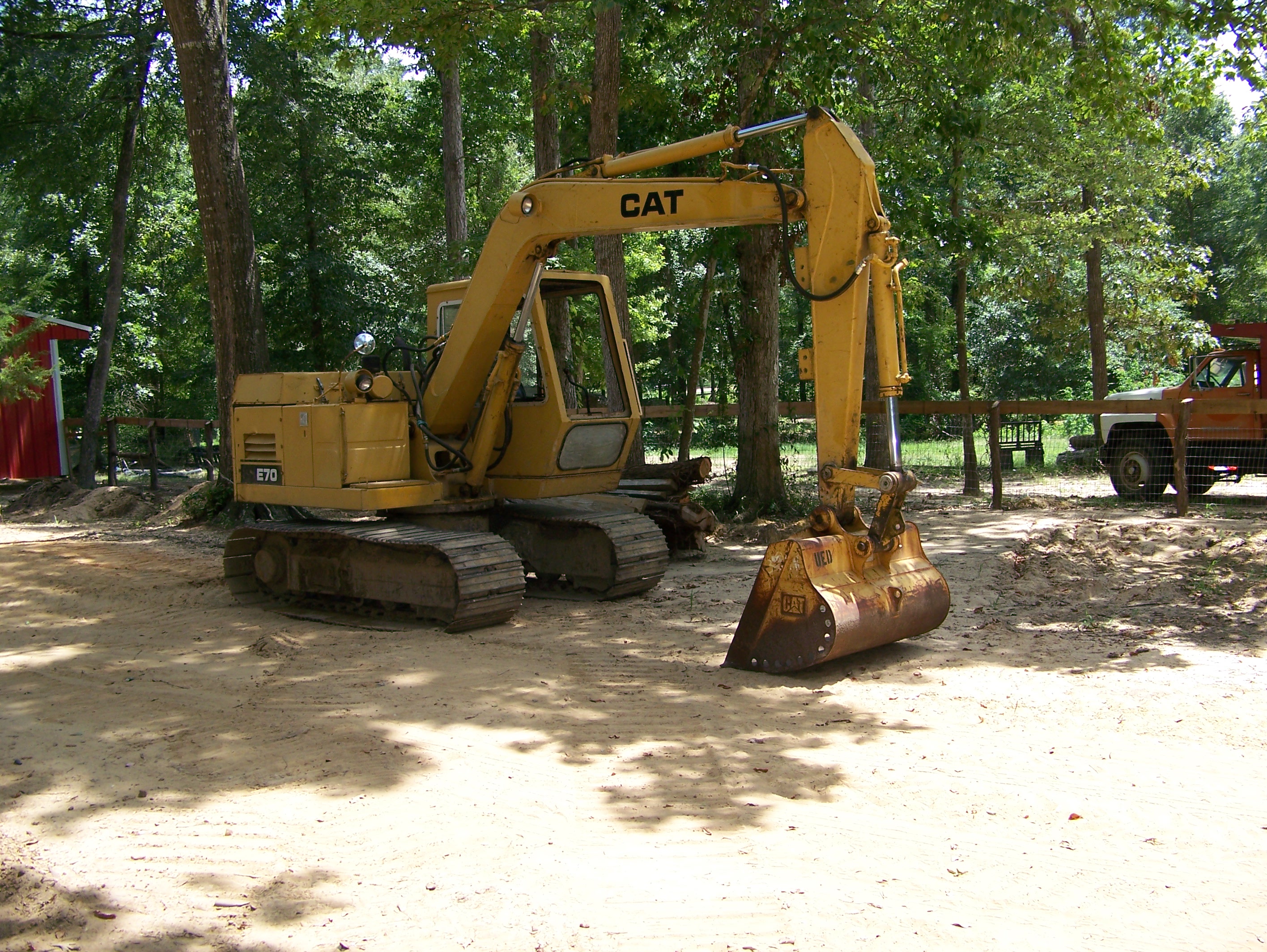

Since you last posted, I bought a Caterpillar E70. It is grey and was a Mitsubishi MS070. Everything works great and looks great. Sometimes while traveling, I hear loud popping from underneath. I understand this might be a track chain that has worn and stretched enough to catch on the drive gear. When it pops, it is trying to jump a tooth. But my chain and gear look good. 7-16-16 CAT Ready for Pond Cleanout.jpg
Maybe that track needs a link taken out. Contact Birmingham Alabama Heavy Equipment Parts Dealer New used & rebuilt Parts & compoments for Loader Backhoes, Bulldozer, or Excavators & Earthmoving
Undercarriage Parts - North American Track
Undercarriage Superstore for all Heavy Equipment.3 Year/4, Hour Warranty!
to see if they have or know someone that has what you need. I got these links from a quick google search. Also, join Heavy Equipment Forums and ask them for help finding parts.
hugs, Brandi

Funny that you would mention it needs a link taken out... The other track has had a link removed and it seems to be just fine. Both sprocket cogs look to be worn about the same.
Seems one side has 35 links and the side that's popping has 36 links.
/ Yanmar YB 25 Excavator #12
I would loosen the track tension adjuster and try to remove a link.
hugs, Brandi

Well, since I last posted I've done a lot of work with the little Yanmar Excavator. Seems track popping noise is gone too. I'm surprised how well it worked and the ease of learning how to use it without a Joy Stick set-up!
