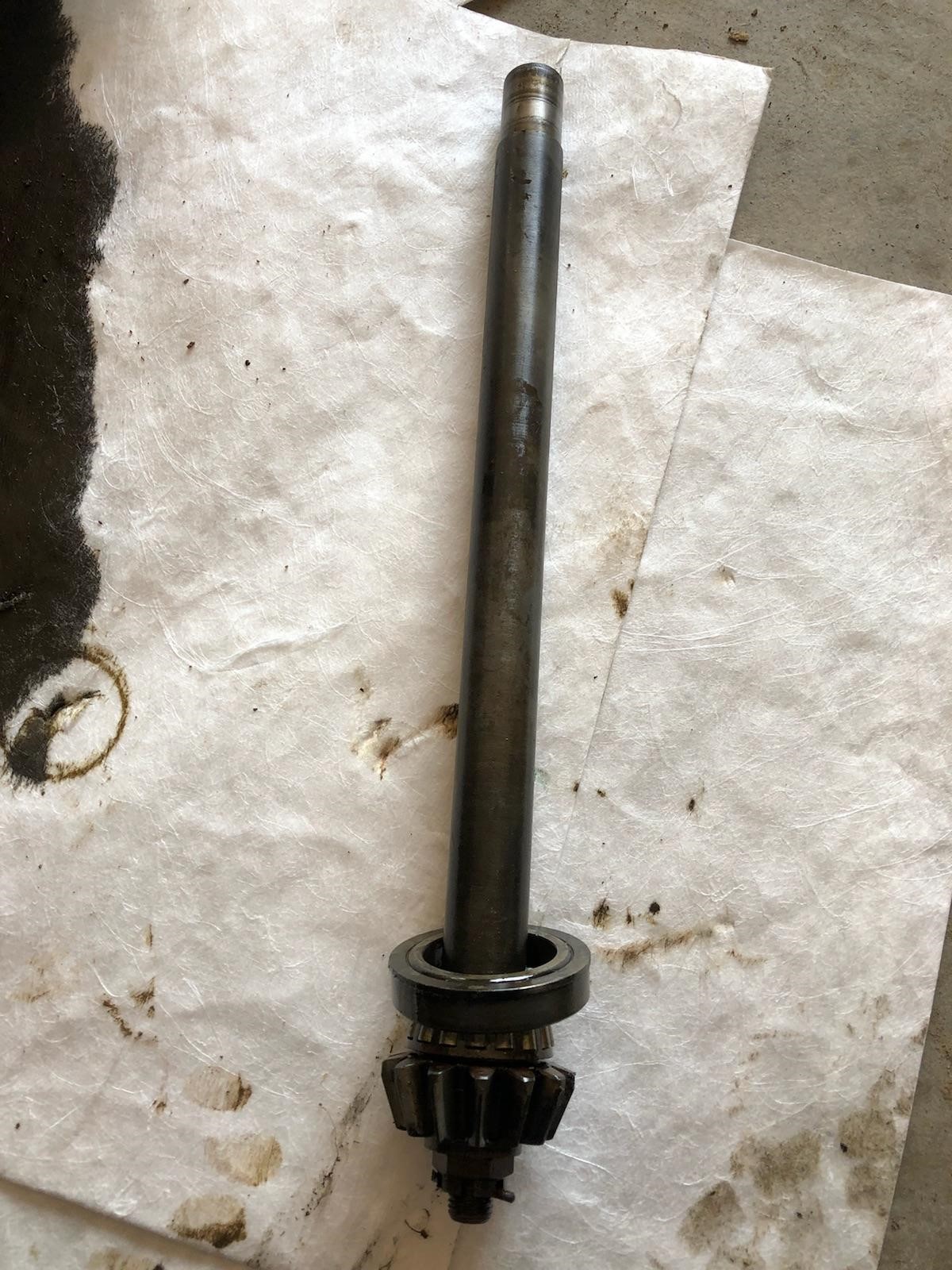

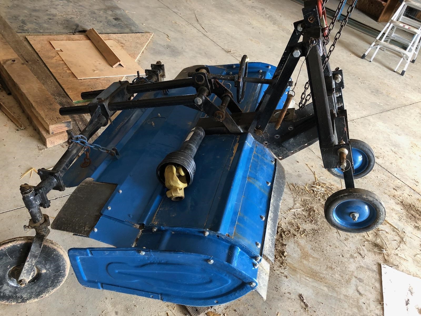

We just recently bought a yanmar tiller. We used it once and the shaft broke and the seals are leaking. There is no model or serial numbers on it. Its a 5 foot tiller. It was red the previous owner painted it blue. Does anyone know where we can get parts for it?
