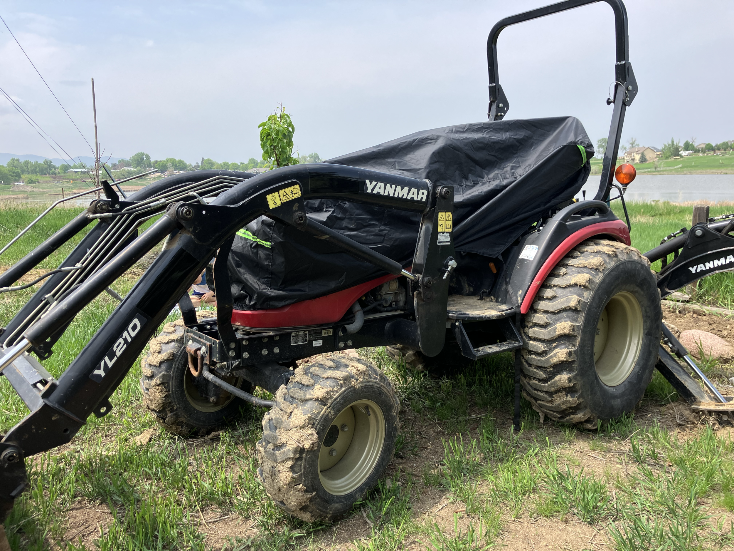

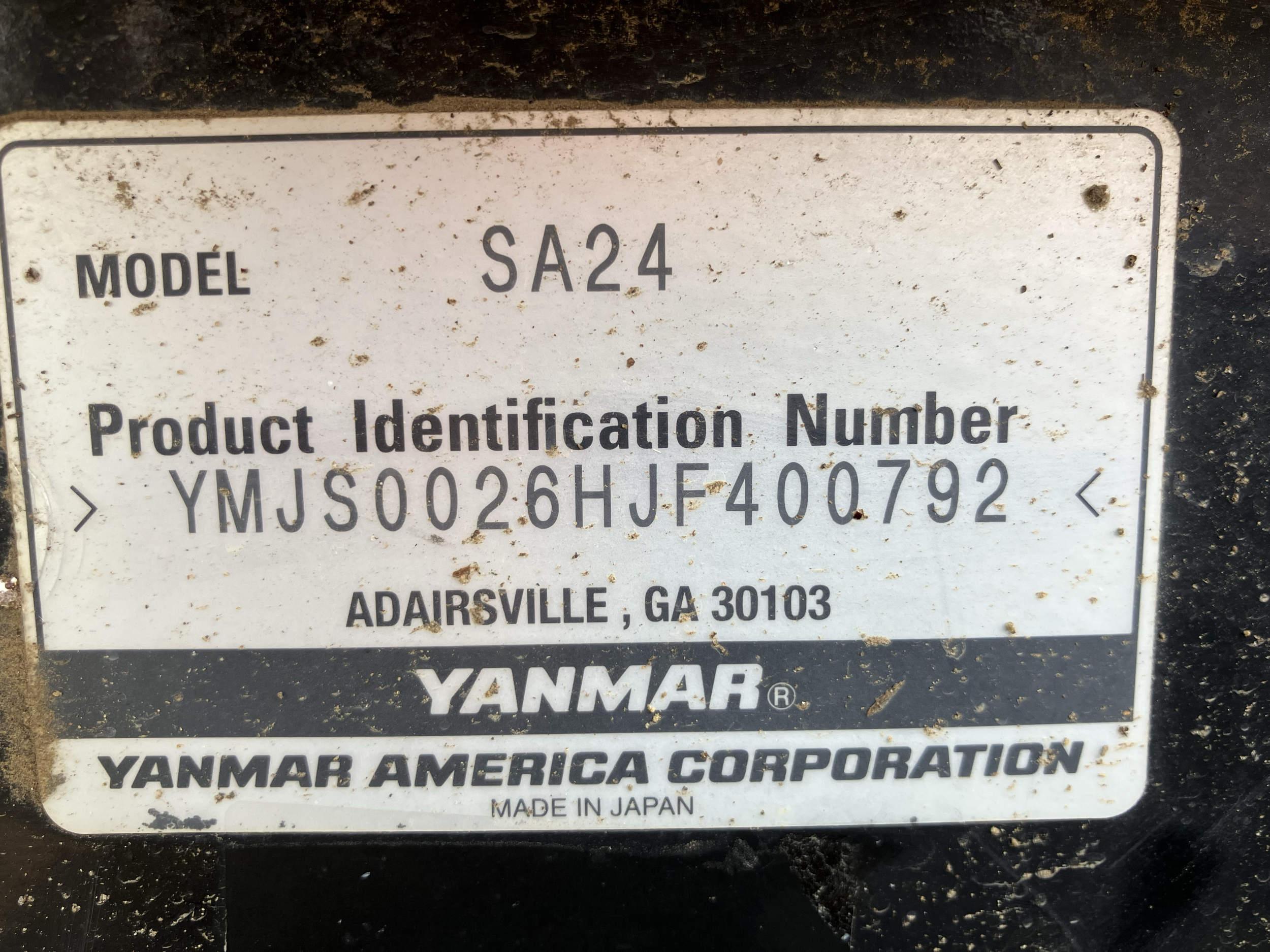

Hi,
I've been watching the used market for Yanmar (and others) sub-compact tractors for some time, and noticed that there are a lot of ex-rental machines that come up for auction at around 5 years old. Home Depot machines are common, and vary widely in condition and wear. Specifically, I liked the Yanmar SA24, but could find exactly zero information about it online. Best I could tell, it is a SA424, though the data plate Differentiates between the two. I figured it was a model specifically built for the rental market, and came with the B65 backhoe and the YL210 Loader. I finally found a machine I liked and won an out of state auction. It showed up as expected, save for one disappointment; it didn't have a hi-lo range selector. Then I scoured other auctions for SA424s and it looks like some of them might not have high low selectors either...
I called my local dealer and he insisted that there is no such thing as a SA24, and he works on some of the Home Depot machines. I have a ton of questions:
  • Anyone have any info on these machines? Are there any differences in the SA24 and SA424?
  • Is the high/low selector an option, or should they all have this?
  • Does anyone have a lead on a good parts source? The dealer wasn't particularly helpful, and made it clear that he was drowning in work, and wouldn't have time to look up parts costs / availability for me, going so far as to suggest that I try to fabricate some of my needed parts myself. (such as seat bumpers)
  • I'd kill for a parts diagram...anyone have one to share/buy? Perhaps Yanmar is very protective of this info.
I love my machine, but am very disappointed in how difficult it is to get parts or service. Seems like Kubota, for instance, makes this much easier.

The SAx24 tractor is either a 324 or 424. The wheel size will determine which model it is. As for parts, it doesn't matter which you use, the only difference besides the wheels and tires is the decals. You missing range selector, it is exactly that. HD removed them to protect the tractors. Using in high range to perform heavy work is not good for the tractors. The part numbers you will need are: 1A8330-27501, 1A8060-67780, 22351-035032, and 22351-060032. That is the lever, knob, and the pin springs to hold it into place.
Fantastic! Mine is the 424, as I have the larger wheel/tires. Makes sense that HD would eliminate the ability for a rental customer to abuse the tractor. Thanks for the parts info. I'd love to know where you got them. I have a small leak from the transmission, and eventually will need to replace some hydraulic seals on the backhoe. Parts diagrams would be great!

Hul, 1. I believe I have a breakdown on the backhoe and loader, 2. Someone left the 3 out on the SA24 should be SA324, there was no SA24 3. They had three models, 223, 324, 424, no difference between 324 & 424 except for tire size. The 223 is smaller tractor, Email me with address I'll ck and mail pages to you
Definitely a "SA24". There are dozens listed on auction sites; all that I have seen came from Home Depot and are ex-rental machines. The larger rear wheels would make this based off the 424 I believe.
