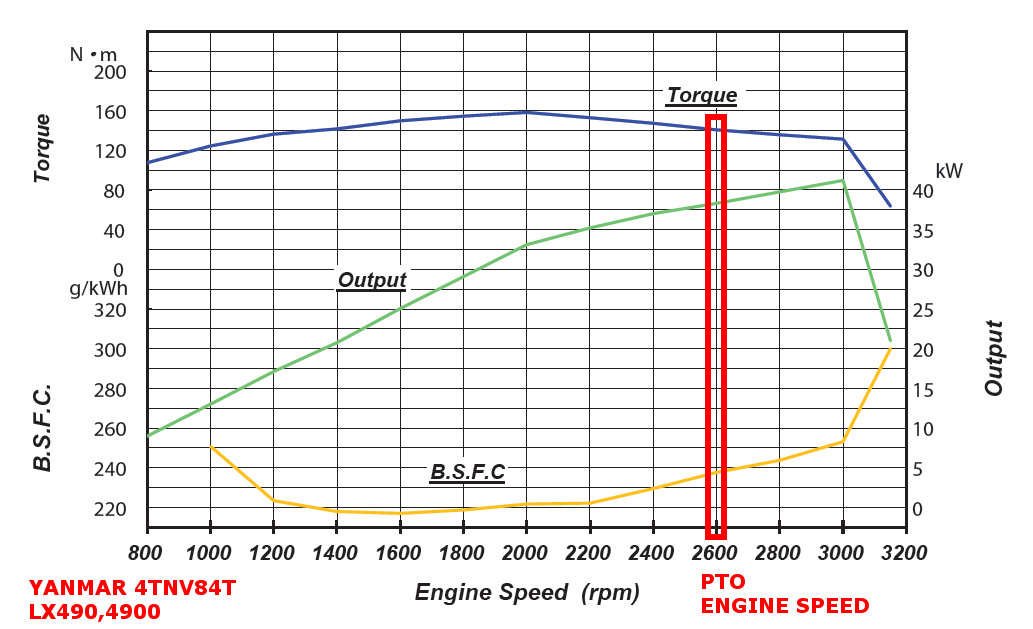

I have a slightly newer manual than you which covers the LX4900, which has the same engine as your LX490 (4TNV84T). My manual states:
"Always run the tractor at less than full speed during the first 50 hours of operation."
"Avoid under any circumstances running the engine at a speed higher than needed."
I've attached a graph of the 4TNV84T performance data. As you can see, your PTO speed at 2600rpm is not full speed, which I would put closer to 3000rpm. The bore and stroke of these new Yanmar CUT engines are more square than other engines out there so they can eke out more rpms/power strokes per minute than other brands/models.
I hope this helps put your mind at ease, but I'm afraid it won't deliver your new tractor any faster. ;)
Thanks so much for that graph. Looks like the fuel efficiency stays good and really flat from 1200 to 2200 RPM and starts to use a bit more fuel per horse power up to 2600 where I will be bush hogging but starts to eat more fuel per horsepower hour at higher engine speeds. Helps to know not to use above 2600 unless it is really needed like traveling down the road.
I like the flatness of the torque curve as well.
