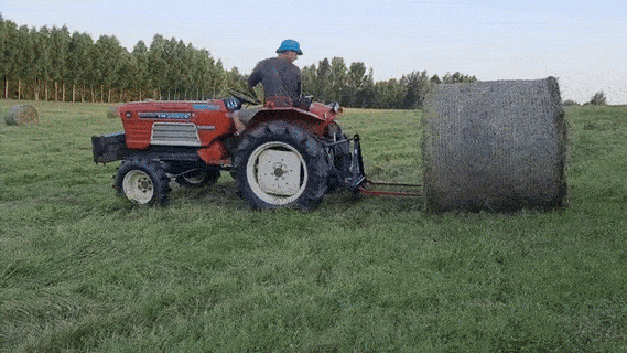

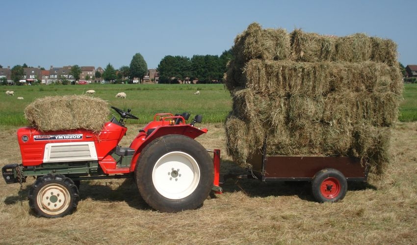

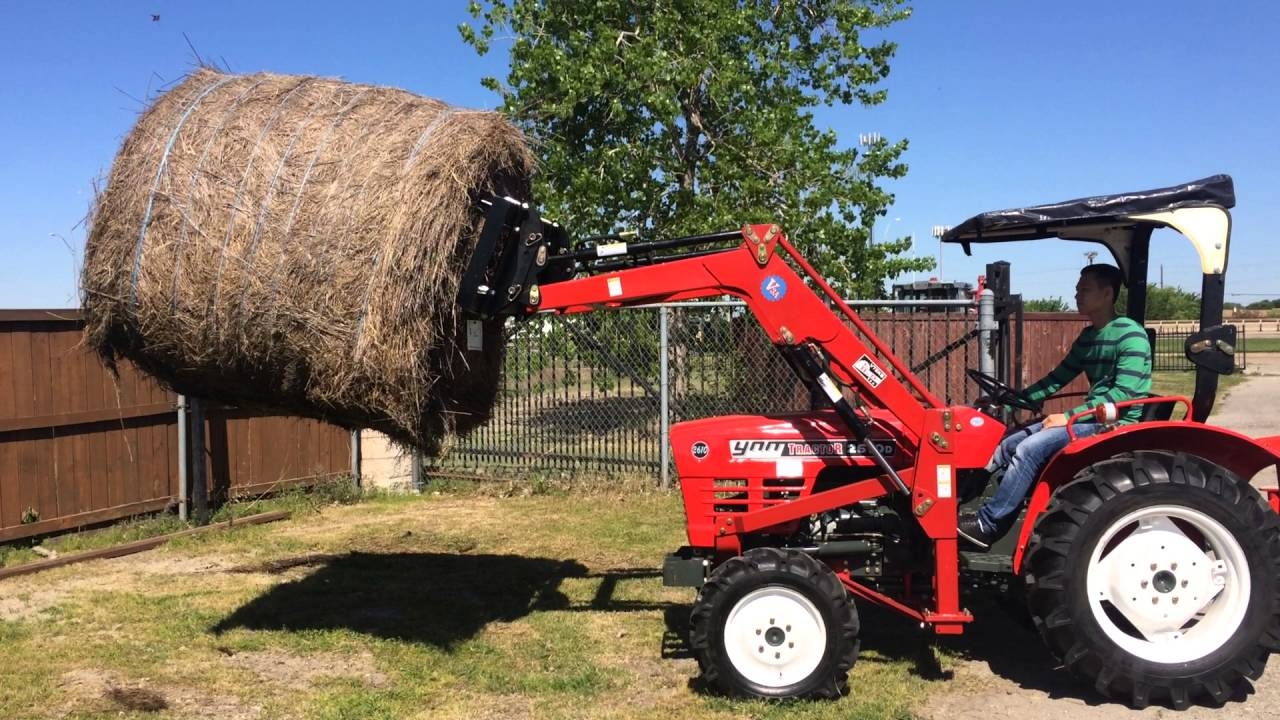

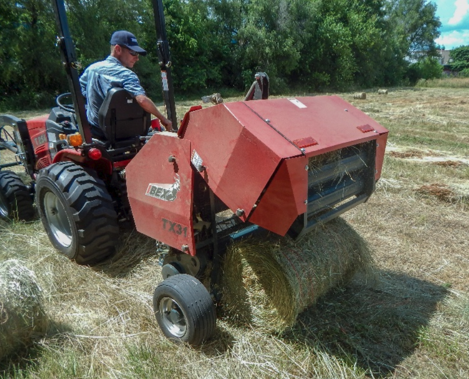

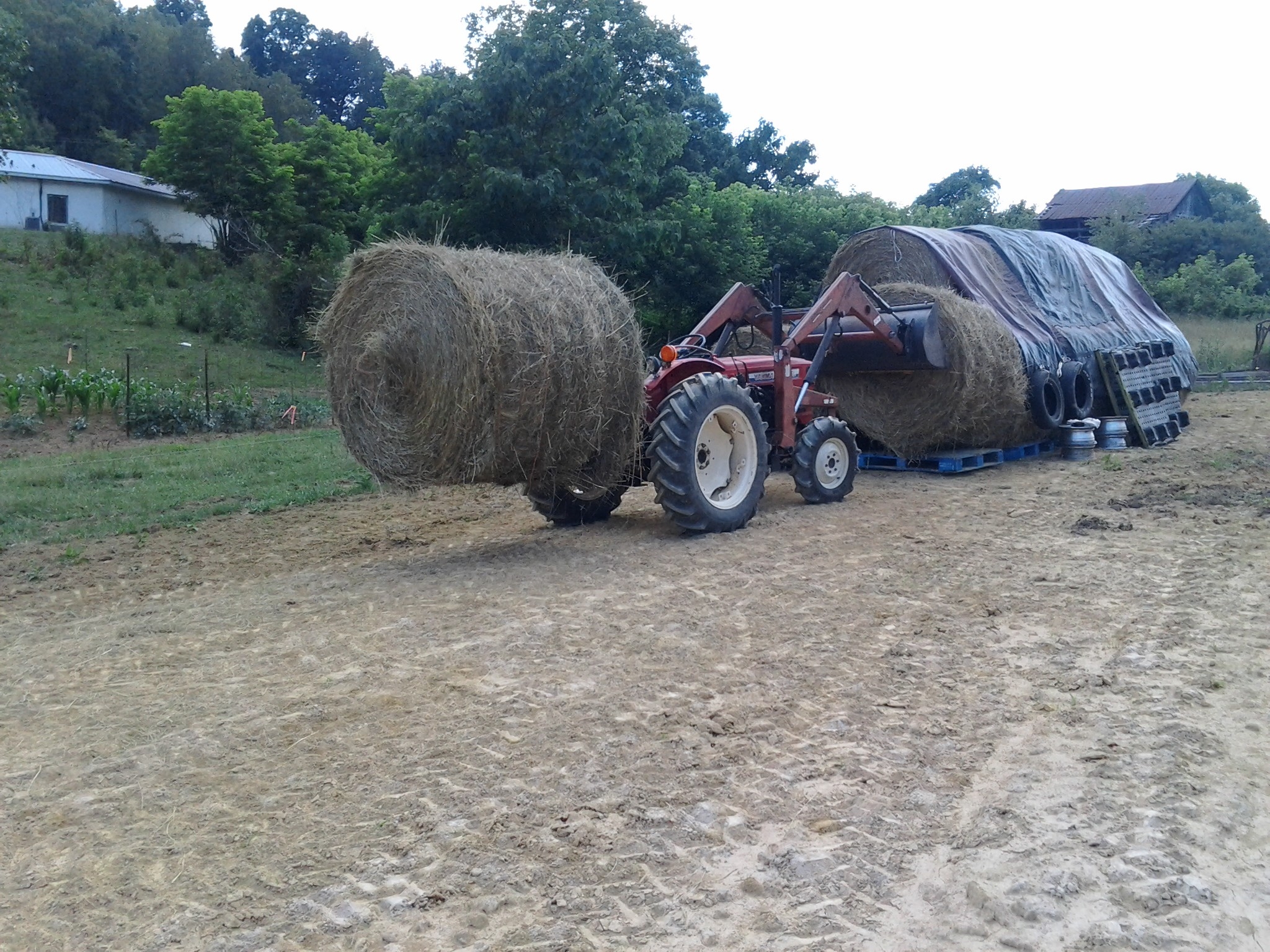

I enjoyed your pictures. It's fun to see what you are doing with your Yanmar. How much HP does it have? Or I should say, how much HP does each one you posted have? Are you able to get enough hay baled to feed livestock? What are you raising? If not, what are you doing with the hay? I've never seen small bales that small. Are they bigger than square bales?
/ Yanmar Hay Fever #12
Most any diminutive tractor can operate a square bailer (not baller) as they aren't power intensive, the flywheel provides the inertia to produce bales. Efficient, no way. Only on flat ground as well. Those rounds in the pictures certainly weren't rolled with any of the tractors in the pictures, simply because they all lack the power to pull or run a round bailer, except the mini round bailer in the one picture that makes tiny round bales.
Nice pictures, mostly pie in the sky, however.

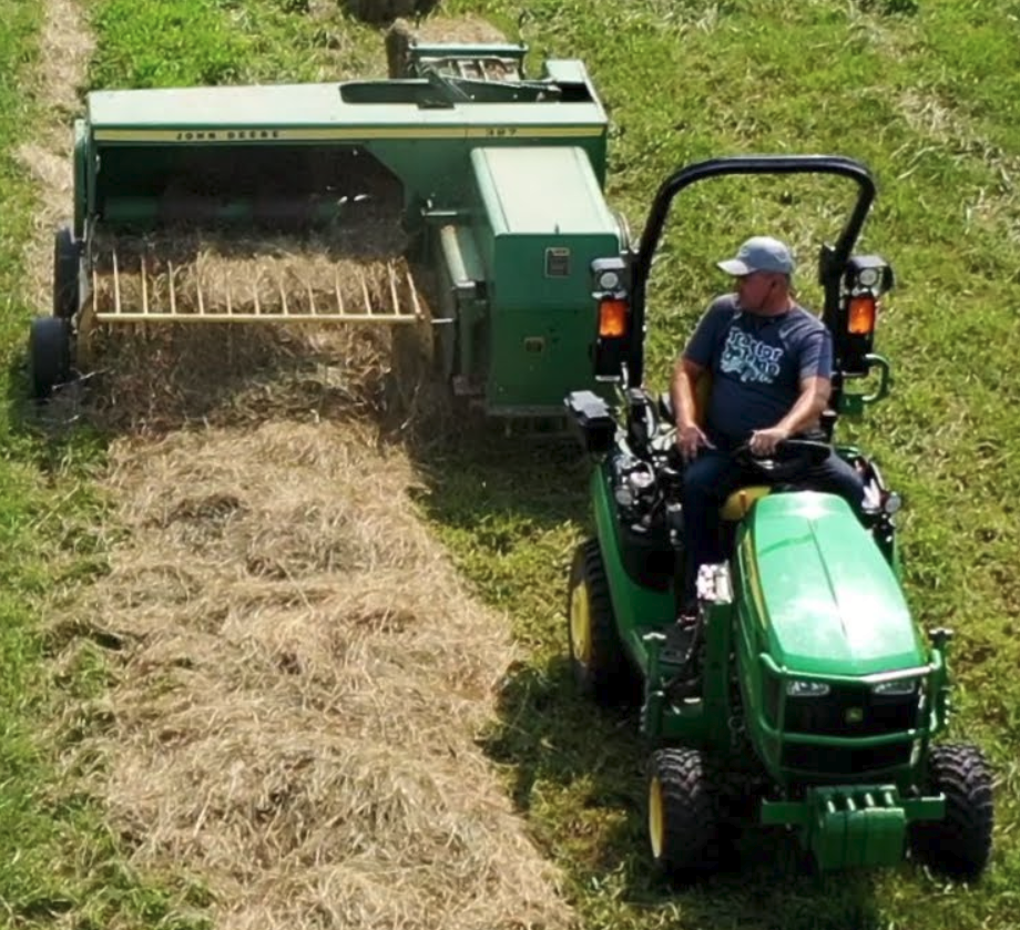

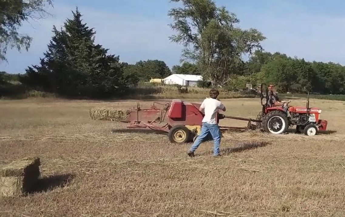

Even the smaller Yanmar Deere machines can play,
That looks like a real good way to end up with a baler on top of your overturned jack-knifed tractor. That baler has to bang the heck out of the tractor and driver with every stroke of the plunger. Seems like this would NOT be recommended . . .
Exactly. Before I sold my New Holland 575 High Capacity square bailer and went all rounds, the 575 behind my M9000 Kubota, when making a headland turn to begin a new row, the bailer would throw me and the tractor around violently unless I cut down the pto speed and the M9 weighs probably 3 times as much as that Yanmar in the picture.
Sure you can run a square bailer with not a bunch of pto horsepower but controlling it is another story, especially on not level terrain. You'll never run a round bailer with any of the tractors pictured simply because the power requirements of any round bailer (except the toy one in the one picture), far exceeds the pto output of any of them. Example, my Kubota BV sileage special requires a minimum of 65 horses pto input to run efficiently and roll a full sized bale. Not enough Cajonies.

Impressive collection of tractors. I'm sure you just wanted to share, not get criticized...
Point taken . . . Didn't really mean to criticize . . . Just wanted to add a "disclaimer" so that newbies thinking about baling hay with their lawn mowers would think twice . . . Easy to hook up something that looks ok but can get you hurt real quick . . .
