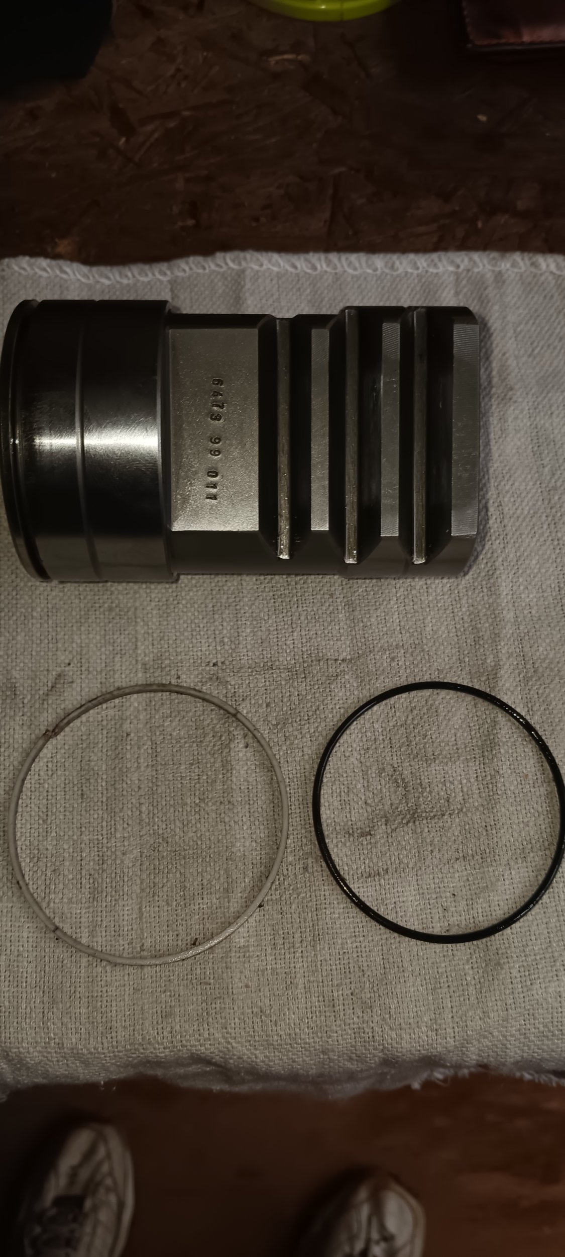

Hello,
I am in process of rebuilding my power steering on my Yanmar FX24D.

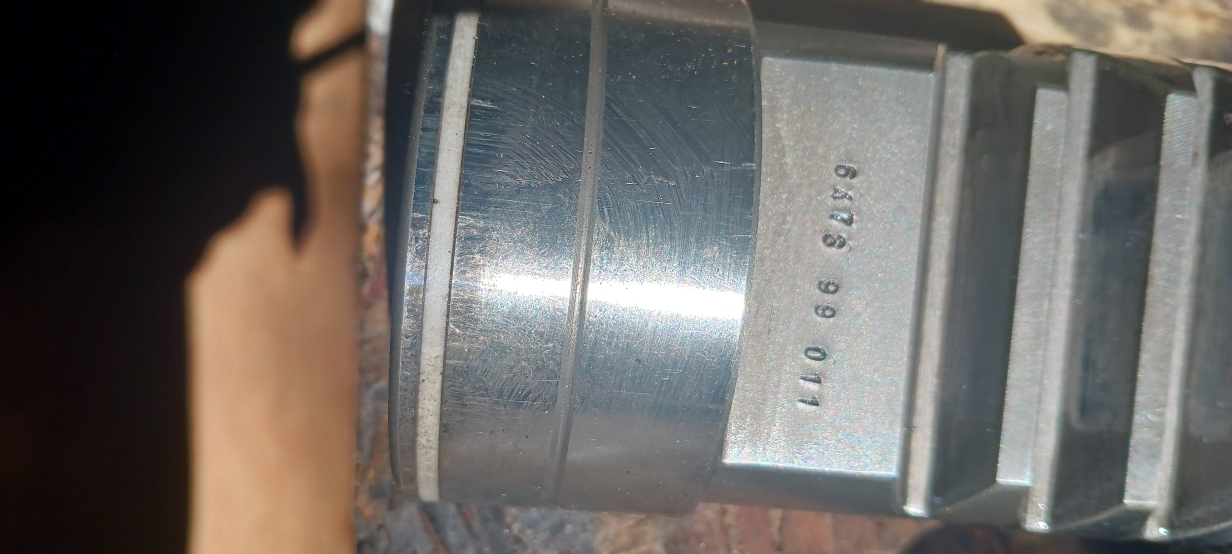

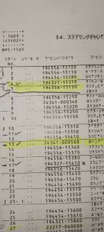

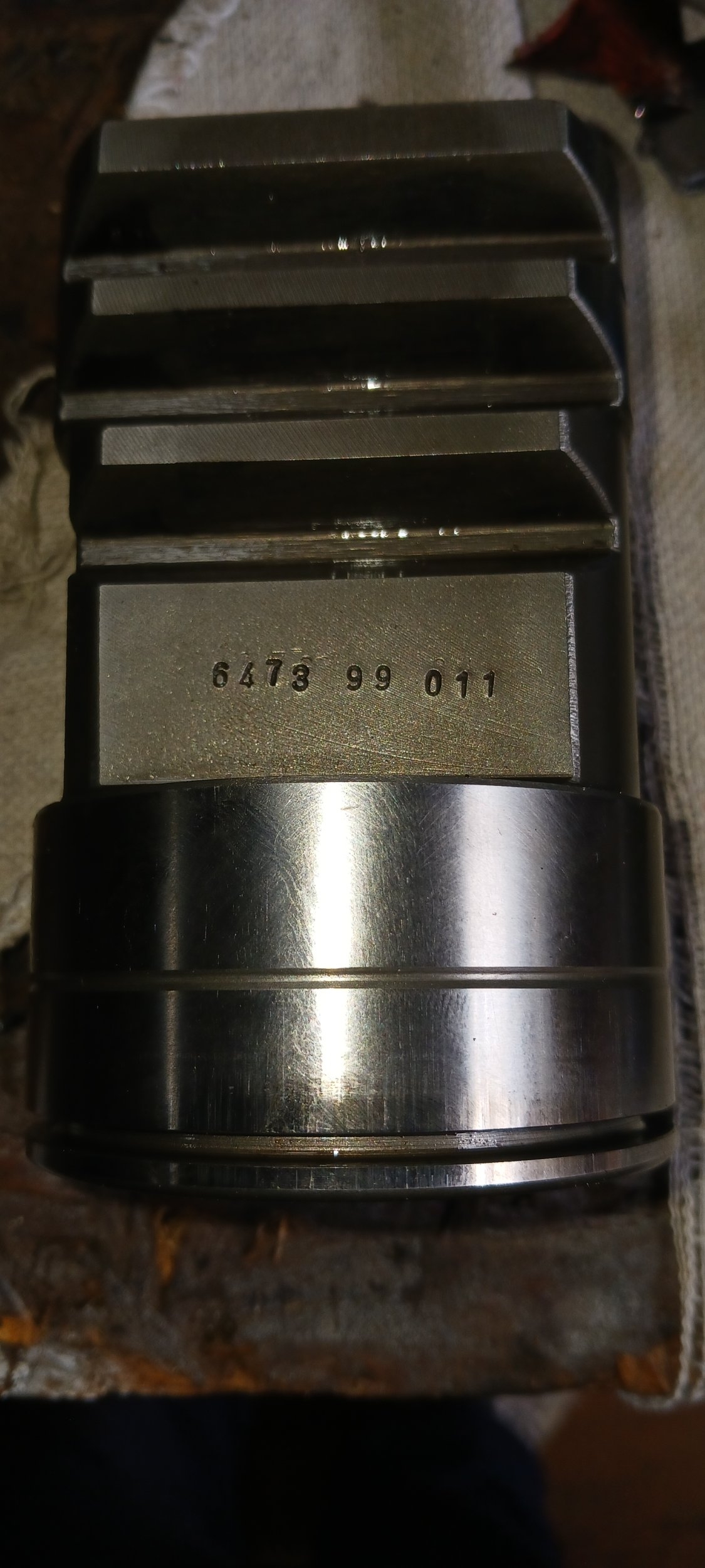

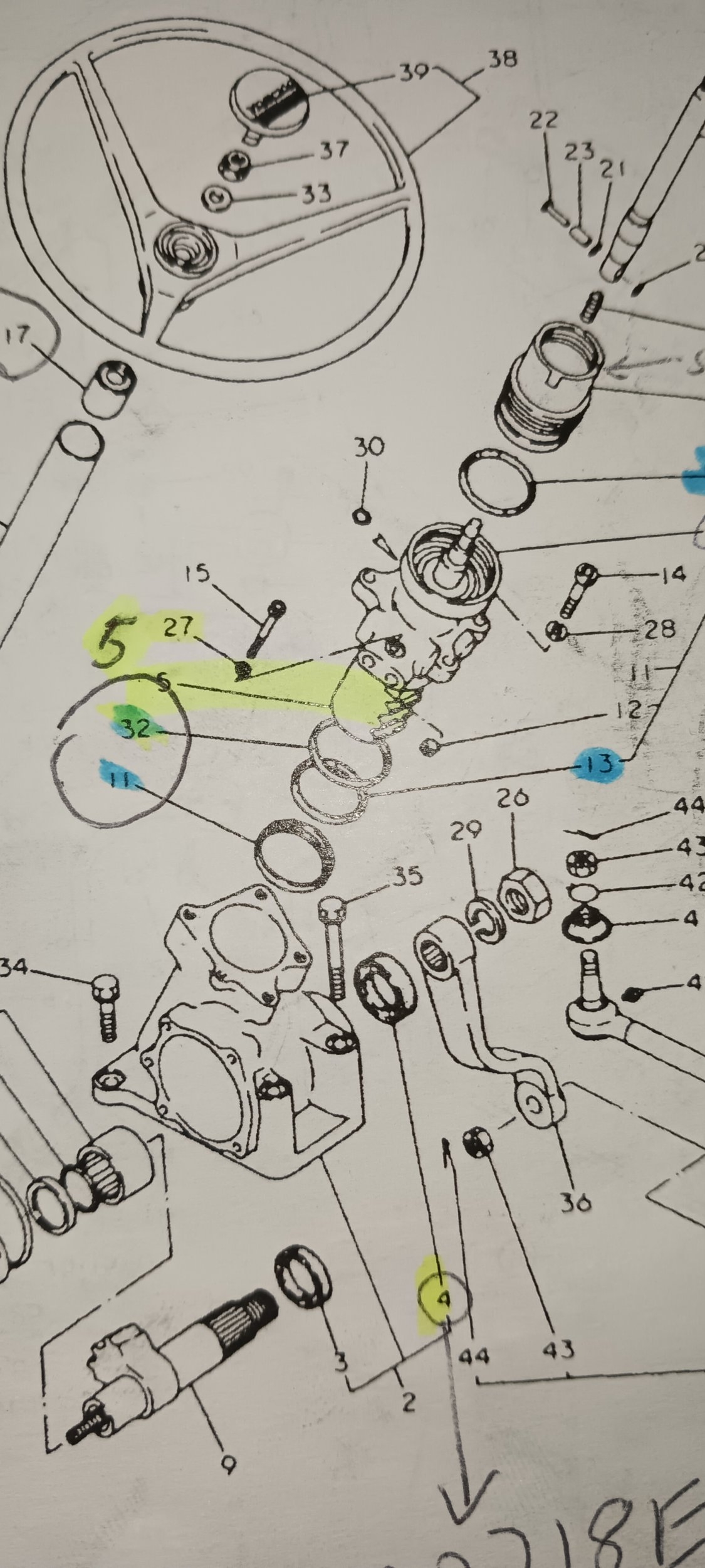

It has a column style power steering and I am looking for the seal that is part of the piston / gear.
I purchased a parts book from Hoye several years ago and the gear in question is FIG 54 Index 5 of that book.
It is a 2 piece seal with a rubber o ring inside and what appears to be a square PTFE seal on the outside.
I have attached pictures of the seal(s) and the piston gear.
Any help would be appreciated.
Thanks, Andrew

/ Yanmar FX24D Power Steering Help #2
I would try a good hydraulic shop that rebuilds cylinders. Bring them the pieces -they stock all kinds of round seals by size. They can likely match up something that will work
