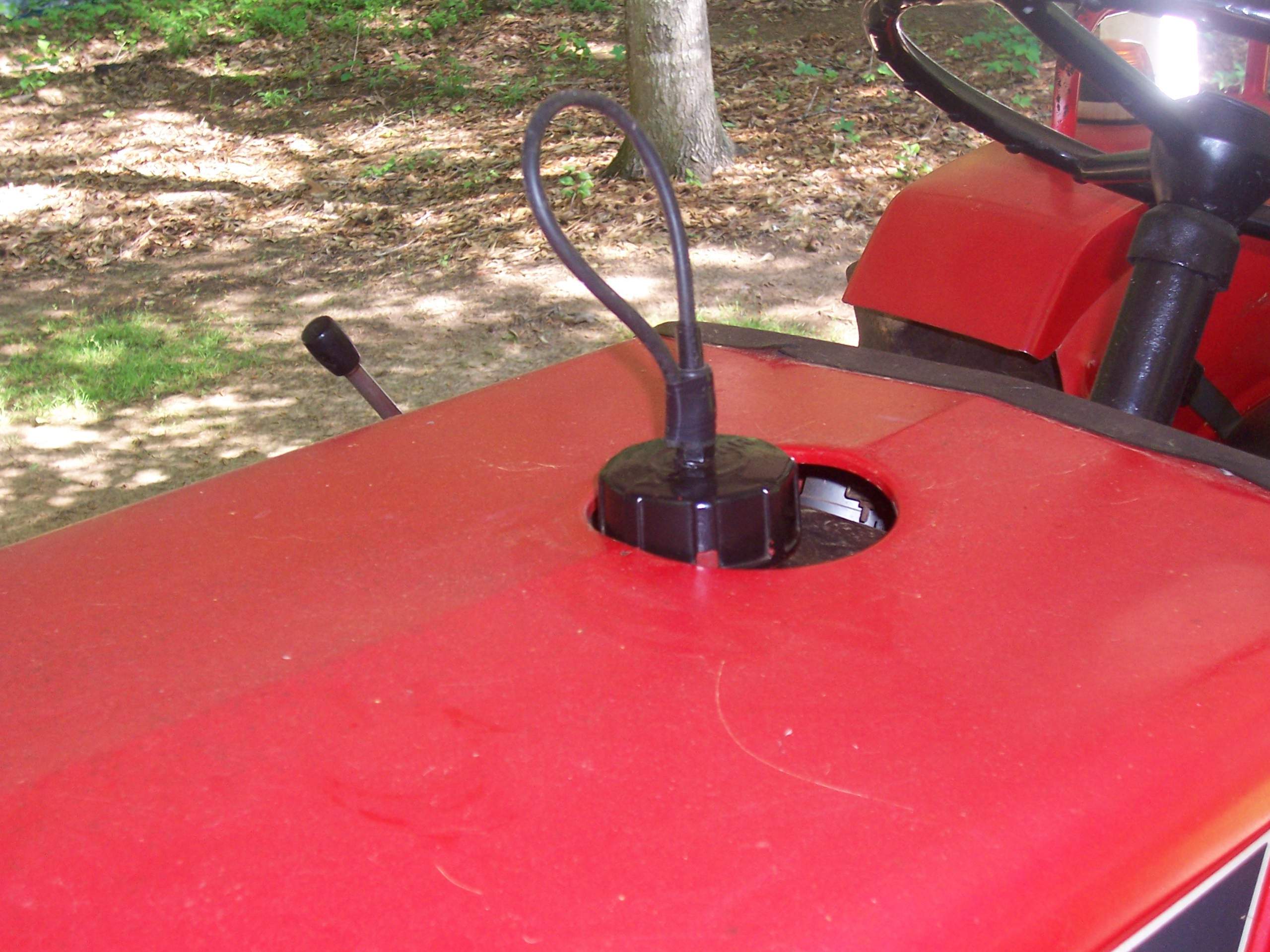

Not long after I bought the 2000 I seen a lot of pressure with Fuel leaking and Air Bubbles coming out around the return line to the Tank. I used an old ATV Cap to release the Pressure. Fixed that problem. ;)
   / Yanmar fuel shut off #29
you must of drilled taht ATV vent into the yanmar cap...looks like i can still see yanmar on the cap?
Also cant you just loosen your cap a tiny amount to let air in. if you look at the seal under the cap there is two slots in the rubber so that the cap does not form a perfect seal.
   / Yanmar fuel shut off #30
It's a Red Yanmar Cap but no slots in it. Only a Rubber Seal. The Tank has 2 slots but I was having to loosen the cap quite a few turns to relieve the pressure. I had the old Atv cap and all I did was drill a hole in the Org.. And actually after I done it and it worked Great!! I felt alot safer about it. In case of a rollover it has a Check Ball in it. Loosen the Cap in my case was a lot and the Return Line I sealed up so I don't have to worry about a Major Fuel Spill
