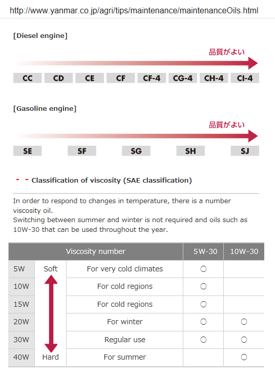

Do not use 15W40 with the Japanese tractor engines, especially Yanmar.
The so called American Iron tractors were made for it, not the Asian tractors. Asia machines are built to JIS standards. 15W40 retains the heat longer in the engine on JIS type engines. In time of heat and working the engine hard, the heads begin to warp. Also the engine runs poorly and black soot becomes an issue.
5W30 winter, 10W30 summer, extreme heat SAE 30.

As for the engine oil, I'm assuming you mean oil that meets the JASO requirements for jap produced engines? If a 15w40 oil was to meet JASO DH-1, which I'd assume would be the grade these engines fall under Would it not be compatible? I was more just looking into operating temp ranges more than potential heat soak
Would you suggest mineral over semi synthetic? Something with a high tbn, ash and zinc %?

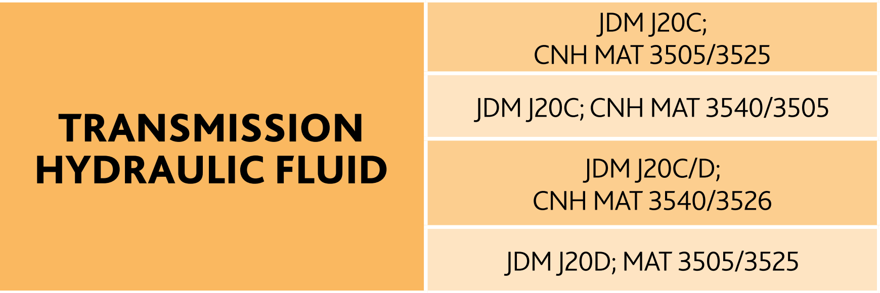

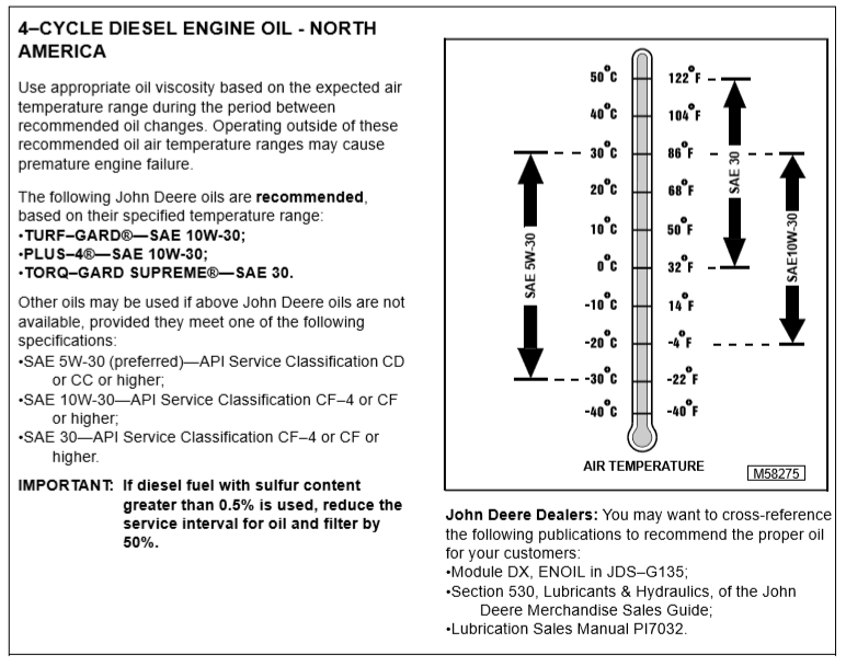

The same engines in the YM, F and FX series are in the John Deere machines.
