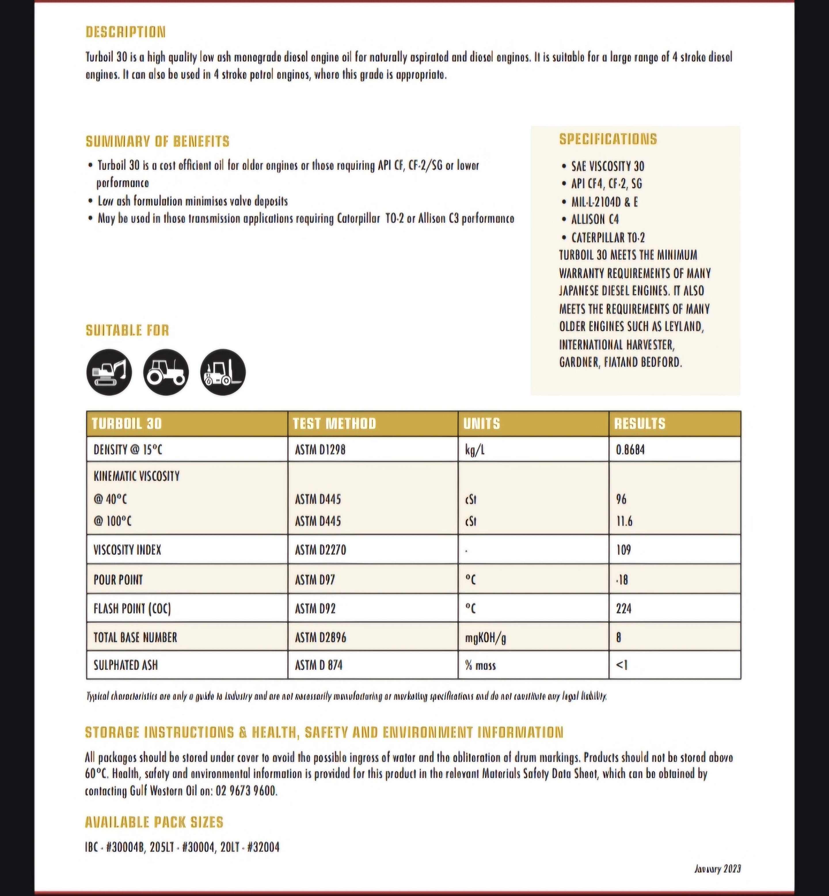

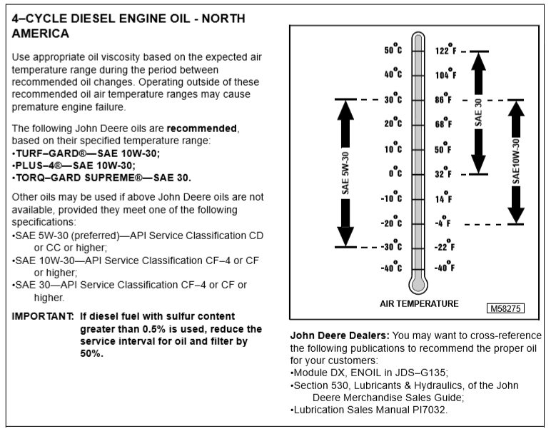

Would this oil be suitable? Listed as CF4 but not for DH2

You can, but alot of the 30w they sell is either low grade CD, full synthetic that lacks the required SAPS or is sold in bulk (44gal) outside of transmissons and lawn equipment it isn't really a common grade here, this is amplified by the fact I live remote so there is no 5 min drive to the shops. I think I'll manage with the oil I sent above, I can almost guarantee the oil in it now isn't 30w so anything will be an improvement.
Thanks for all the help mate, greatly appreciated
