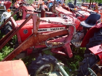

/ Yanmar 3110D
#9
Hi Mark,
Tnx for all your support. Regarding FEL I didn't yet. I’m looking all pictures I can get on Internet before I decide to make my self one. Will be hard job because I can’t get any plans and using only picture will be complicate.
Rgds
Jose
Mozambique
