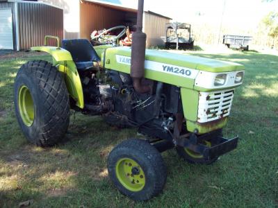

Is a tractor as per the text below even worth $1200 if it would start and run?
Purchased as "non-running tractor". Got it started and smoked too much. Installed rings
and inserts. Now it won't start. My loss you gain. It is 25 hp. 2-cylinder diesel. 3-point,
PTO all work, Good tires.

I would buy it. I've owned one for ten years and like this model.
But in this particular case, budget another few hundred $ at most to unscrew whatever he screwed up when he put it back together. Still a bargain, and likely it will need nothing more than some hours of analyzing what isn't right.
If you're lucky all it needs is bleeding the air out of the fuel line. Or maybe he didn't understand how to adjust the valves. I doubt its an expensive problem, these things are too simple to need much.
Running? I would say well over $2,000 depending on location. Over $3,000 out here. Search for 'YM2000' for comparables, those come up for sale more frequently and they are simply the Japan-market version of the same tractor.

I'm not a tractor value assessor, although when I look at something I'll tend to itemize things of value, Like looking at the wheels/tires of this tractor could be worth over 1/2 the price, or the hood/sheet metal, radiator, etc,etc, if at worst case I could still recoup my $$$ ,
I'd say even if having to invest another 1,000 in it, it would be worth 2-3k just as California stated,

I would say that its worth $1200, even if it has to be parted out. You could easily get $300 for the rear tires, the rear trans section could easily bring $500 to someone who needs it, radiator $50, sheetmetal another $200 maybe.
Unless tehre is a hole in the block or you cant turn the crank by hand with a big socket i would say go for it.
