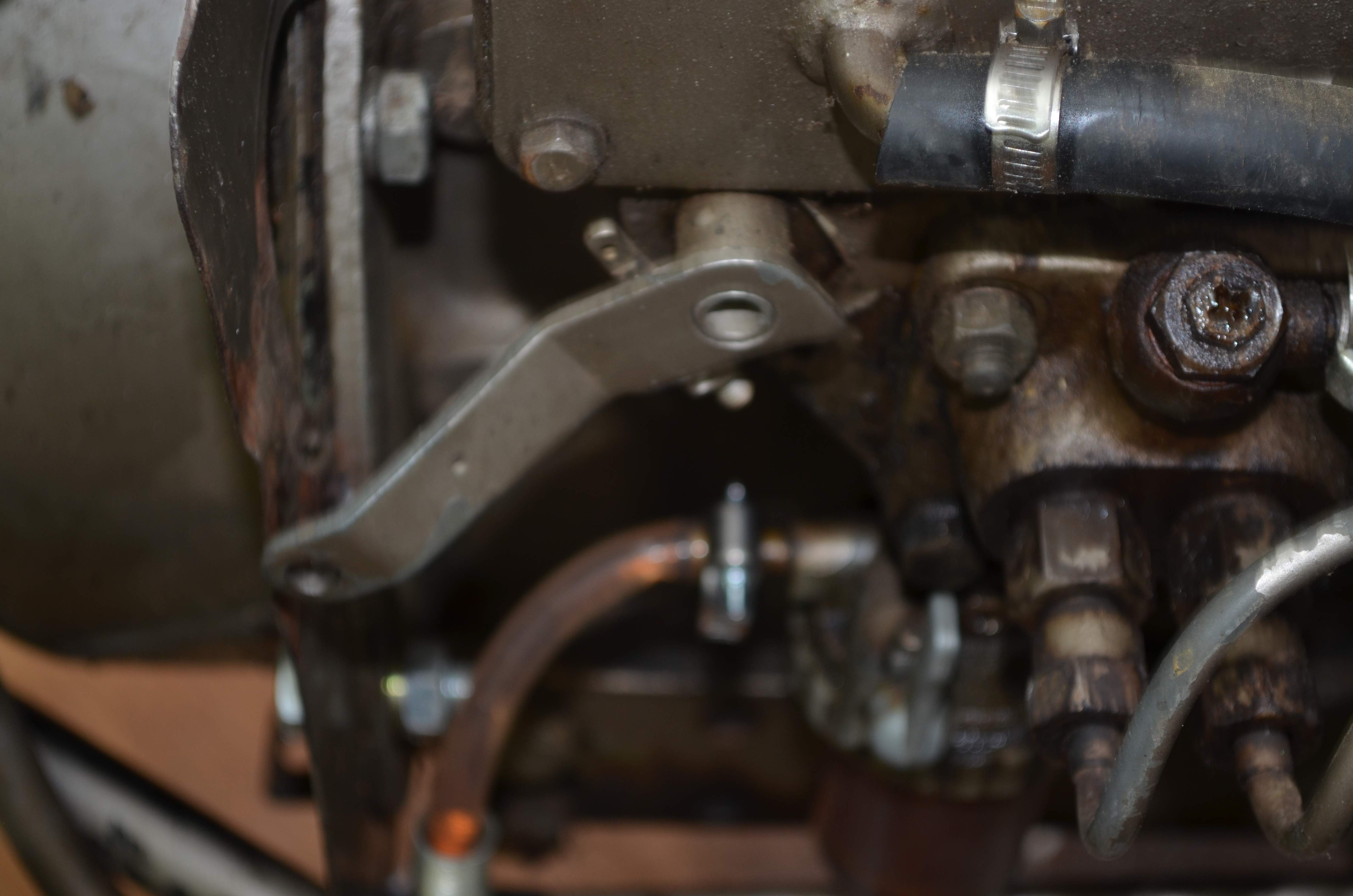

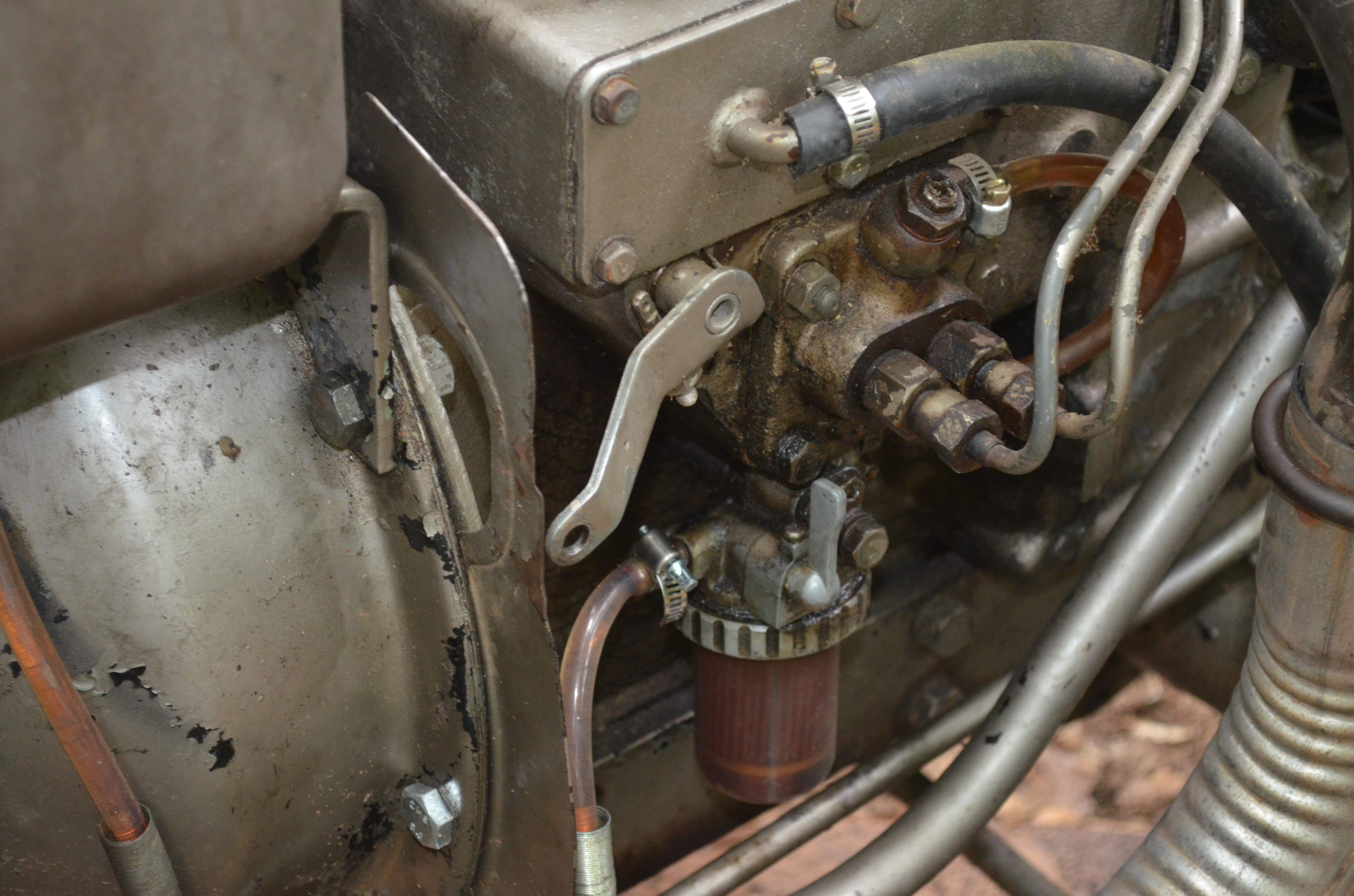

The Yanmar 1500D is back together with a new clutch. After several trials of air bleeding it started up. Now another problem, the diesel engine runs at full speed. I have tried moving the throttle. Throttle forward is supposed to be slower - back is faster but there is little speed change if any where ever the throttle is set. When started the tach ramps up quickly and reads over 3000 rpm. Thankfully I read some of the posts the other night and recalled that the only way way to stop a diesel is to cut off the fuel. I closed the fuel shut off valve and the engine shut down. I started it again and still the engine ran up to full speed again. I tried to control the speed by the closing and opening the fuel shut off valve but it either ran full speed or died as I tried to maintain a set speed.
Even though the linkage is not binding, I removed the throttle linkage at the connection on the arm where the shaft goes into the engine. Still the same when operating the arm without the throttle linkage or lever. When operating the arm by hand without the linkage there seems to be resistance by a spring (concealed). Maybe something is frozen inside.
I am afraid to run this thing at such a high rpm. I don't want to have it fly apart. I am wondering if I will ever get some use out of it. Any ideas?

I agree with Neat 1500. Try tapping on the injector pump. Might possibly free it up. If that doesn't work you may have to pull it. You can see the rack #17 in this drawing. Yanmar Tractor Parts: INJECTION_PUMP

Thanks Neat 1500 and Winston. I already tapped (somewhat lightly with a rubber hammer so as not to break anything) but will try again. The tractor is at my lake hose about 100 miles away. Is the thought that the pump is stuck or the governor? If I pull the injector pump will the governor be attached? Can I get access to the governor if I pull the injector pump? Pulling the injector pump looks straight forward - any tips? Will everything in the governor come out??? The parts cut on the governor looks complicated. Thanks.

On my tractor which also sat for a while...the linkage for govenor behind fuel pump did not move due to a roller spring stuck from old fuel...need to use penatrating oil to release parts but dont pull apart otherwise you will have to recaliberate pump.

So if you look at my photo on the previous page, I will loosen injector tubing, take off the fuel supply tubing, loosen and remove the nuts that hold the pump on the tractor, note closely the shims & pull the pump out. I assume there is a connection somewhere in there to the pump so I will be careful not to break anything, disconnect the spring if possible, do not disassemble the pump, try to free what is in a bind and after freeing the bind, replace the pump in the reverse of how I took it out/off??? Can anyone confirm that has actually removed the pump on a 1500D?

I don't know about the pumps on first hand experience but from my reading I know some people have had success freeing up their pump. Just looking at this picture of the pump I would think penetrating oil could be sprayed in the rack opening which should reach the little gears and some part of the plungers. Although we can't see the underside I know their are rollers under there that run on the cam. I would think penetrating oil in that area should also do some good. Finally and most importantly, don't take my word as "authority" on the matter. :D http://www.hoyetractor.com/mm5/merchant.mvc?Screen=PROD&Product_Code=IP-200

Take off the cover plate(W/blow by tube) above the pump,and there should be a spring ?? hooked to the pump-don't stretch it or damage it. Never had to remove one yet-just repeating what I have read on other posts. The pump runs on a cam,but you have to disconect the linkage before you just unbolt it and pull it out.
