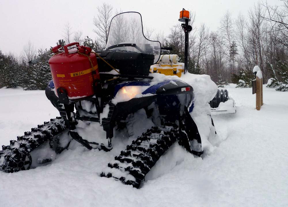

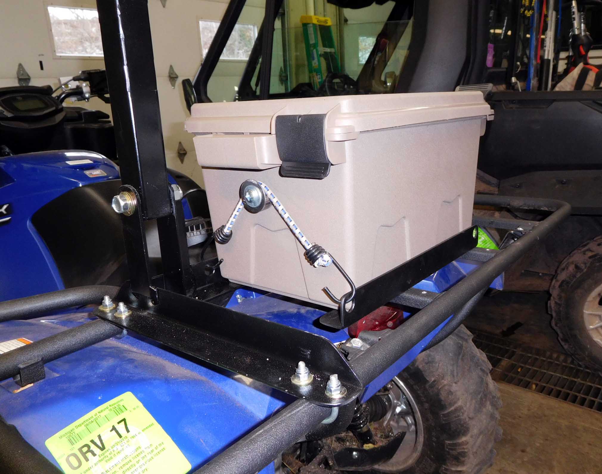

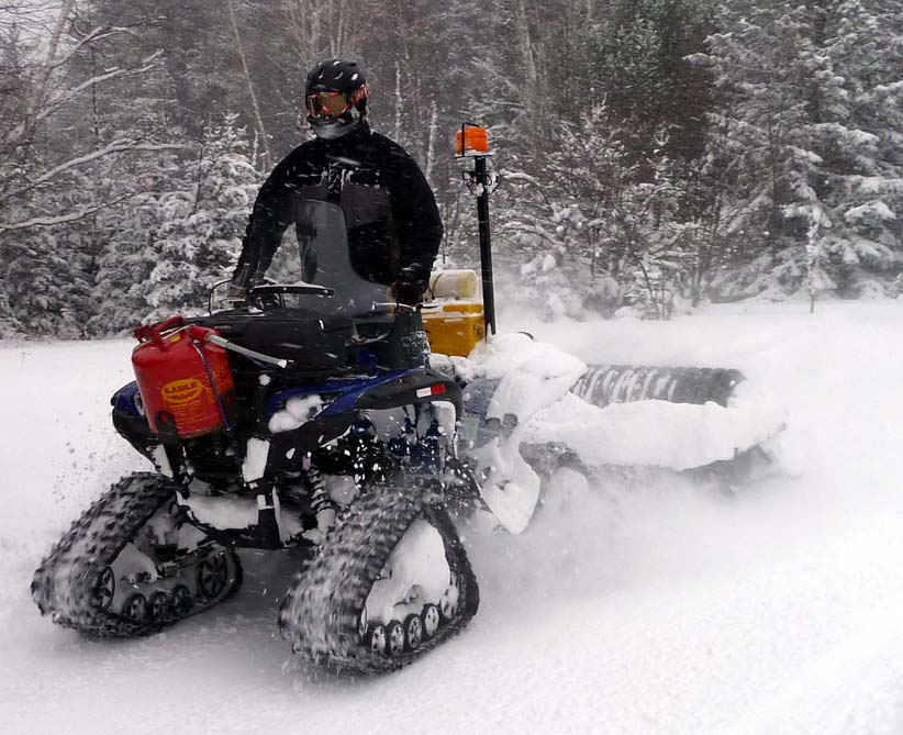

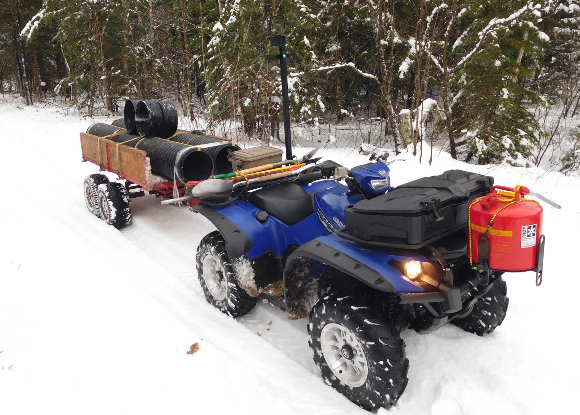

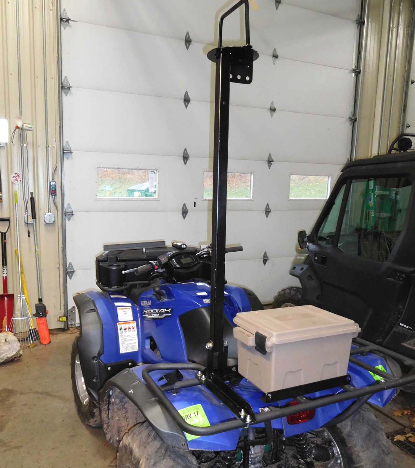

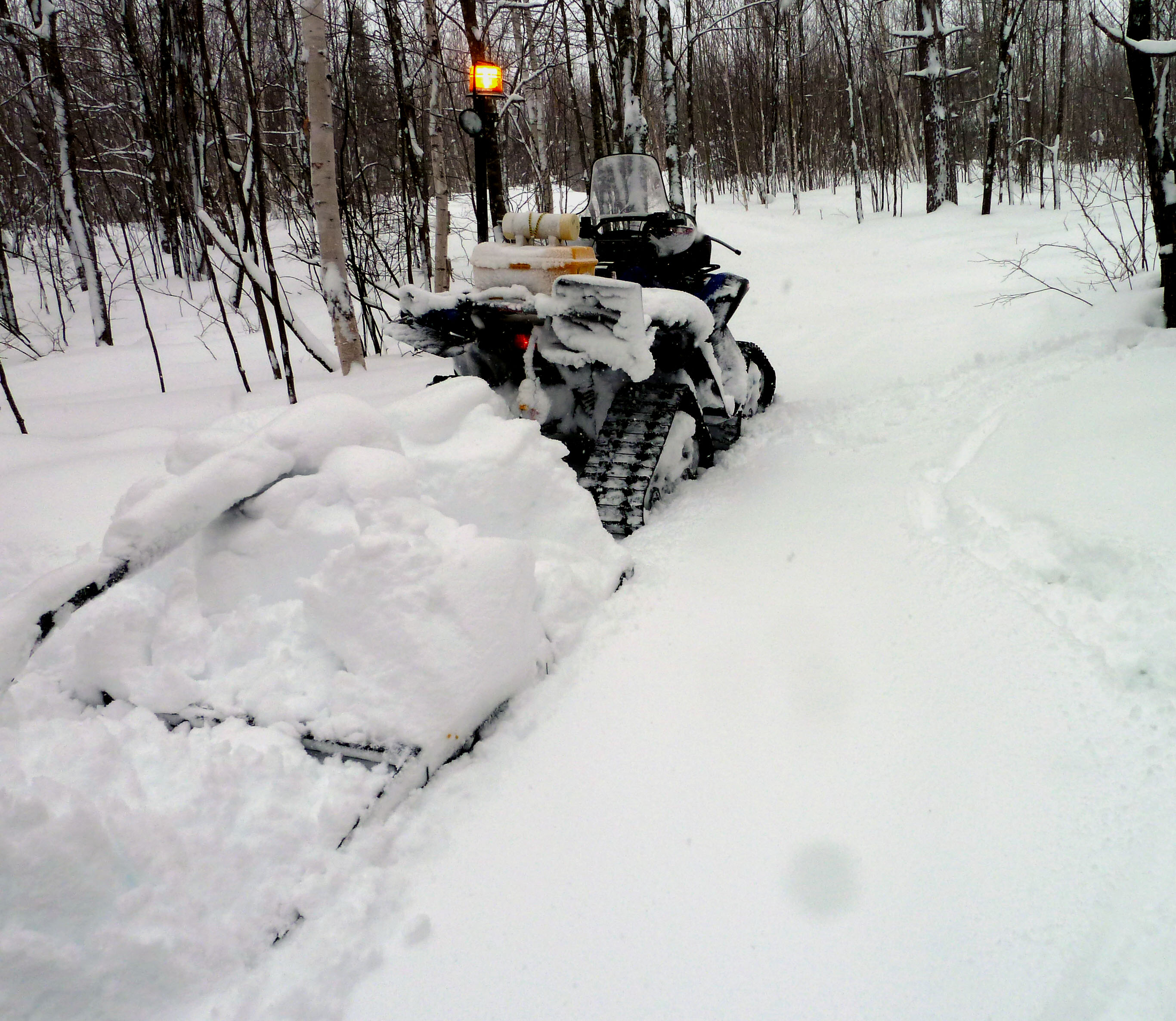

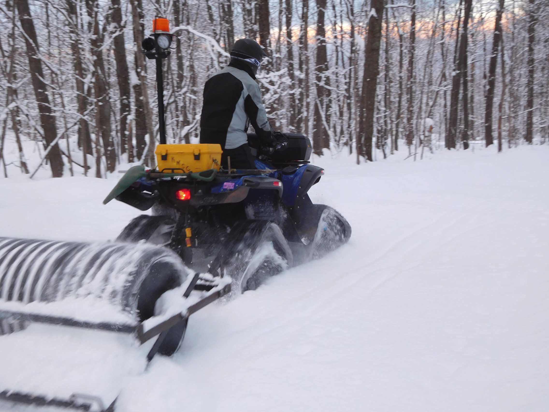

We are assembling a 2018, 700 Yamaha Kodiak which we use for towing snow implements and a mower. We do about 300 hour per season doing this. The mower towing business is pretty insignificant in volume. So far its had heated grips and throttle added, front and rear tool box and windshield. And as seen in the photos is a rear box and light pole. That's for a amber strobe and 2 LED lights. The rear tool box is a MTM ammo box that we really, really like. Later a whole bunch of wiring will need to go on it. Also are Kimplex Commander track pods which are on order. What I'm I forgetting? Oh yes the fender flares.
If anyone has interested in seeing this get put together, please let me know.

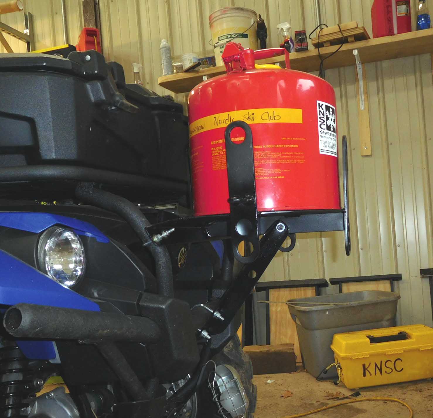

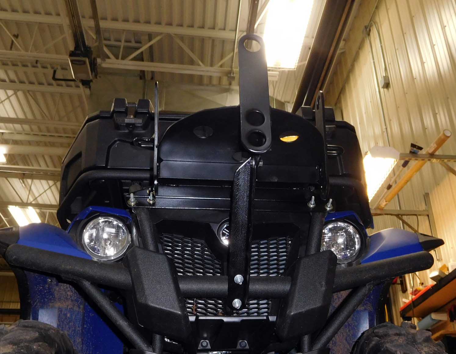

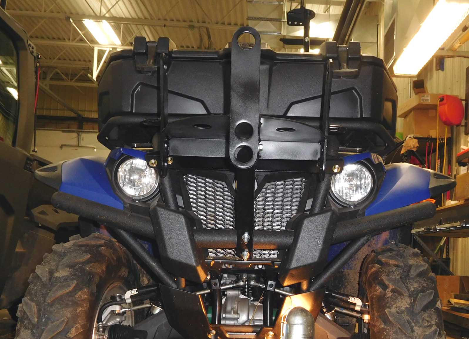

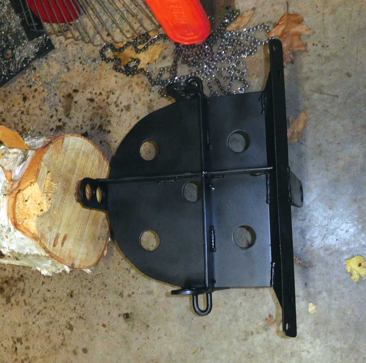

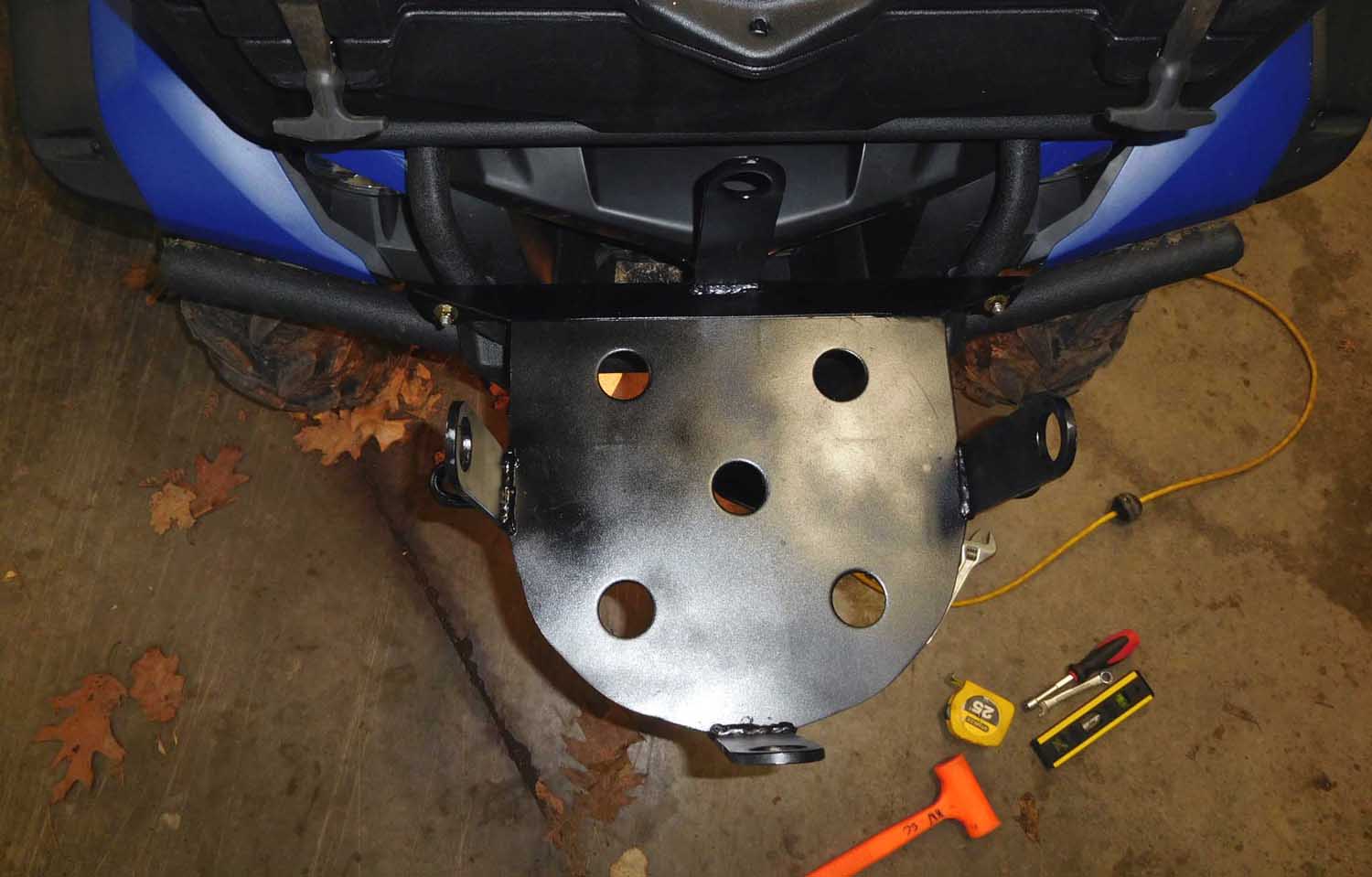

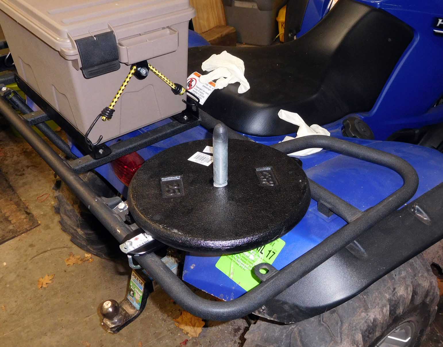

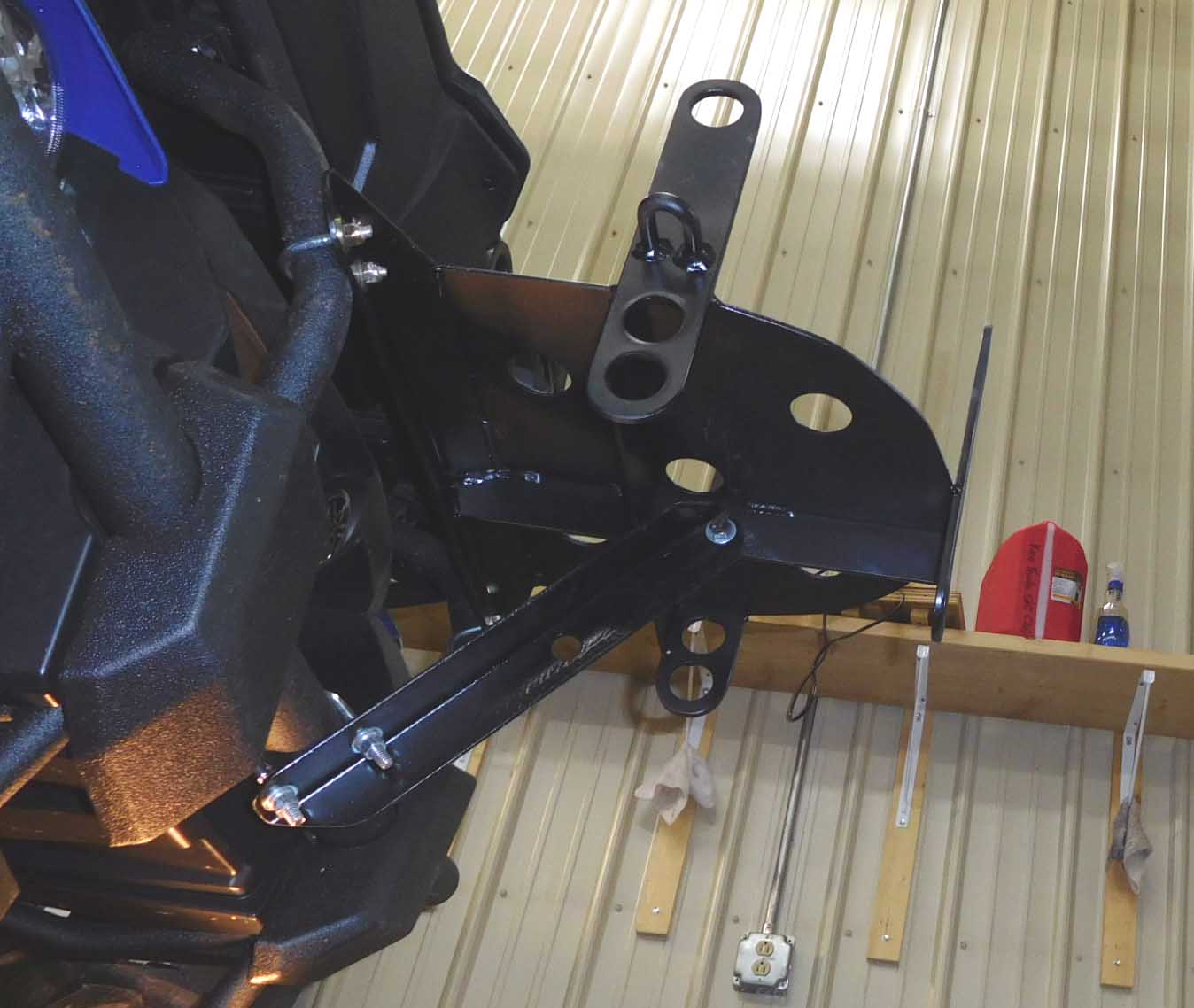

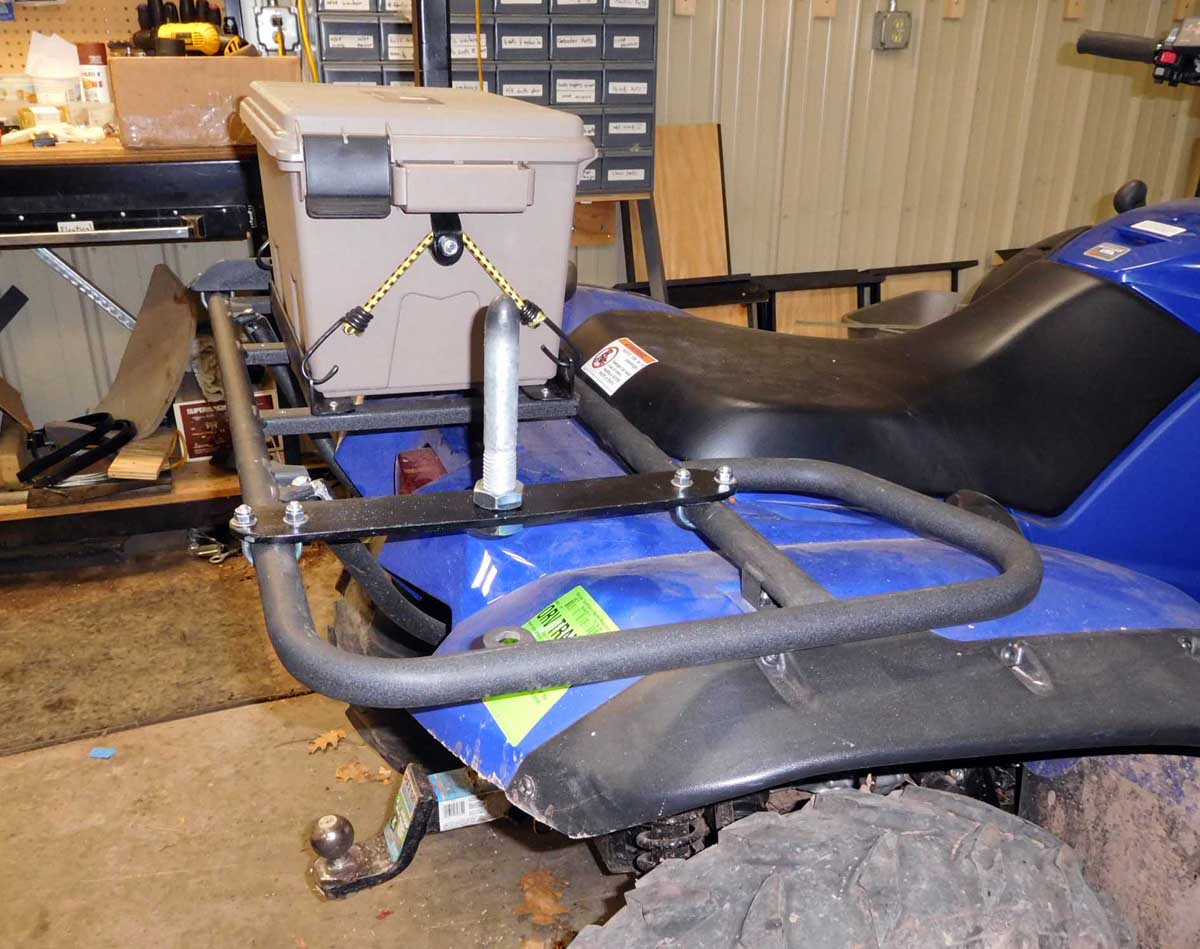

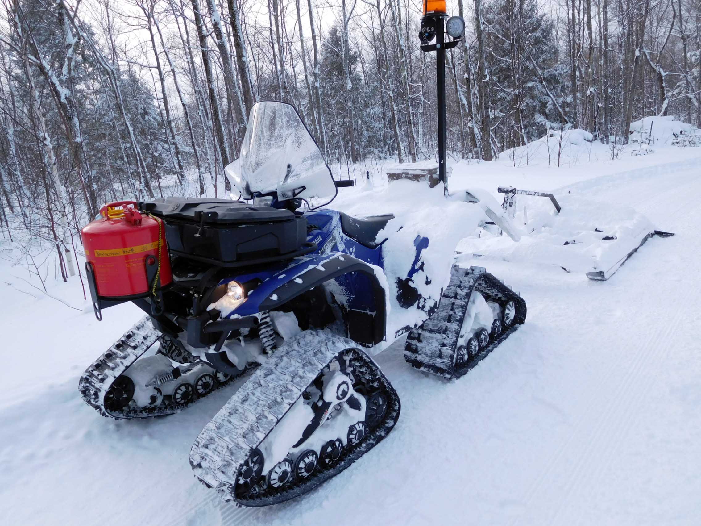

More devices have been added to this machine. This front rack is to carry class II fuel cans and a 25lbs standard barbell weight. We work these machines rather hard and can drain the tank in less than 3 hours, so we normally bring extra fuel along. So the front racks we built keeps the front weighted, both fuel and the barbell weight which keeps the front down and us steering the machine in the right direction... :eek: The rear weight rack is not normally used but in case we need to remove weight from an implement, so we have somewhere to carry it back on.. All these items I built since they are not manufactured by anyone.

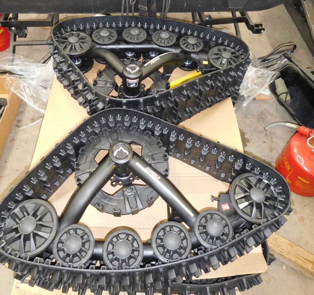

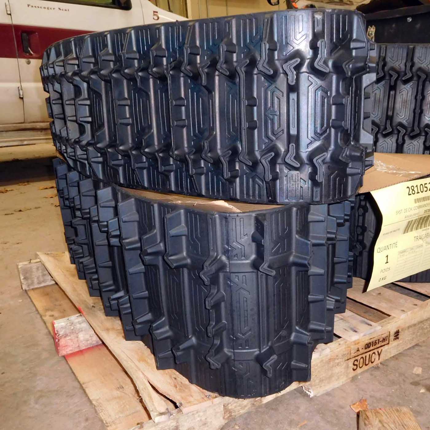

Kimplex Commander pods arrived today.

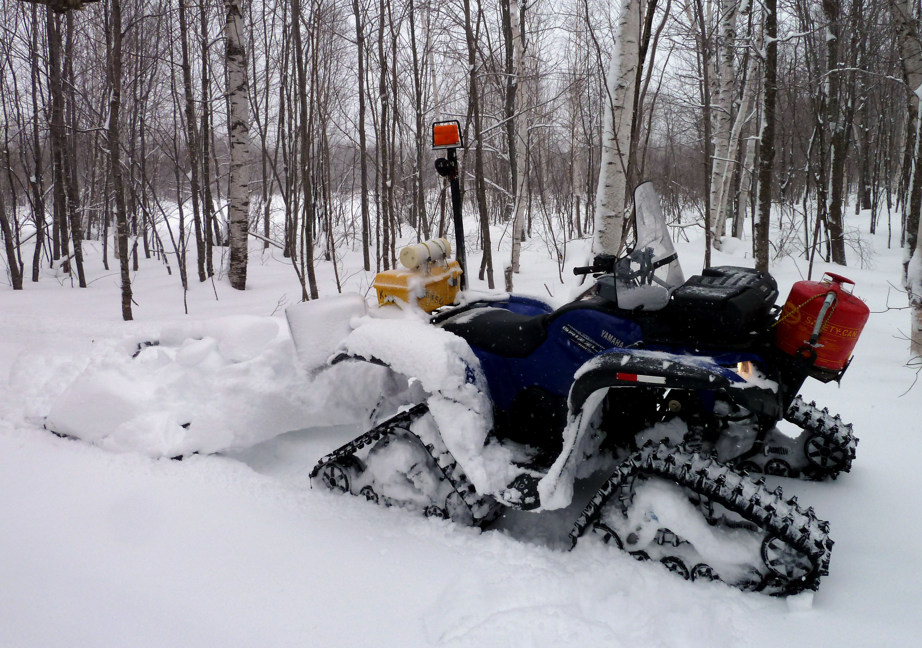

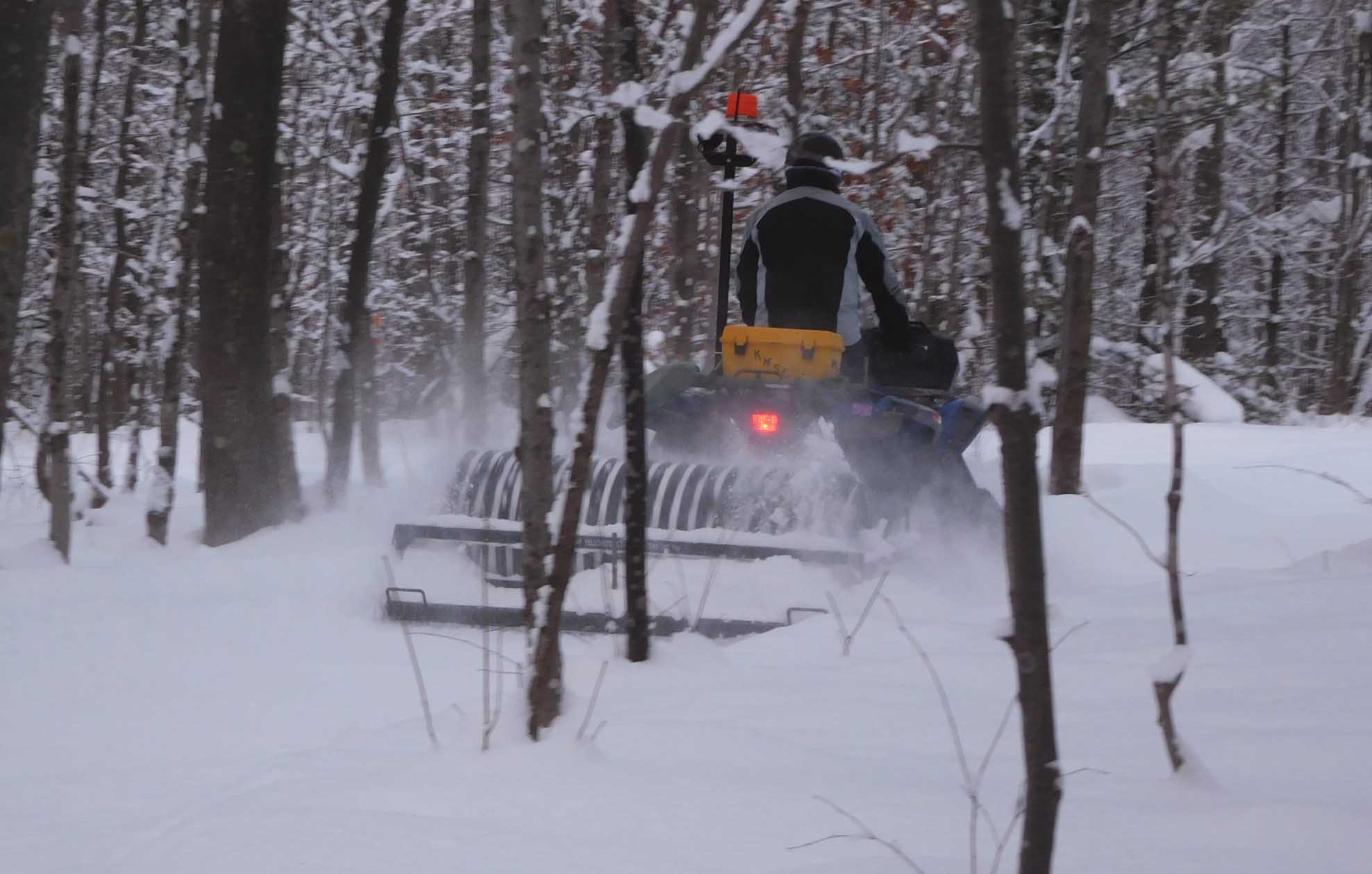

New pods might be going on shortly. We got 5" to 8" of white stuff here today and it will continue to fall.:thumbsup:

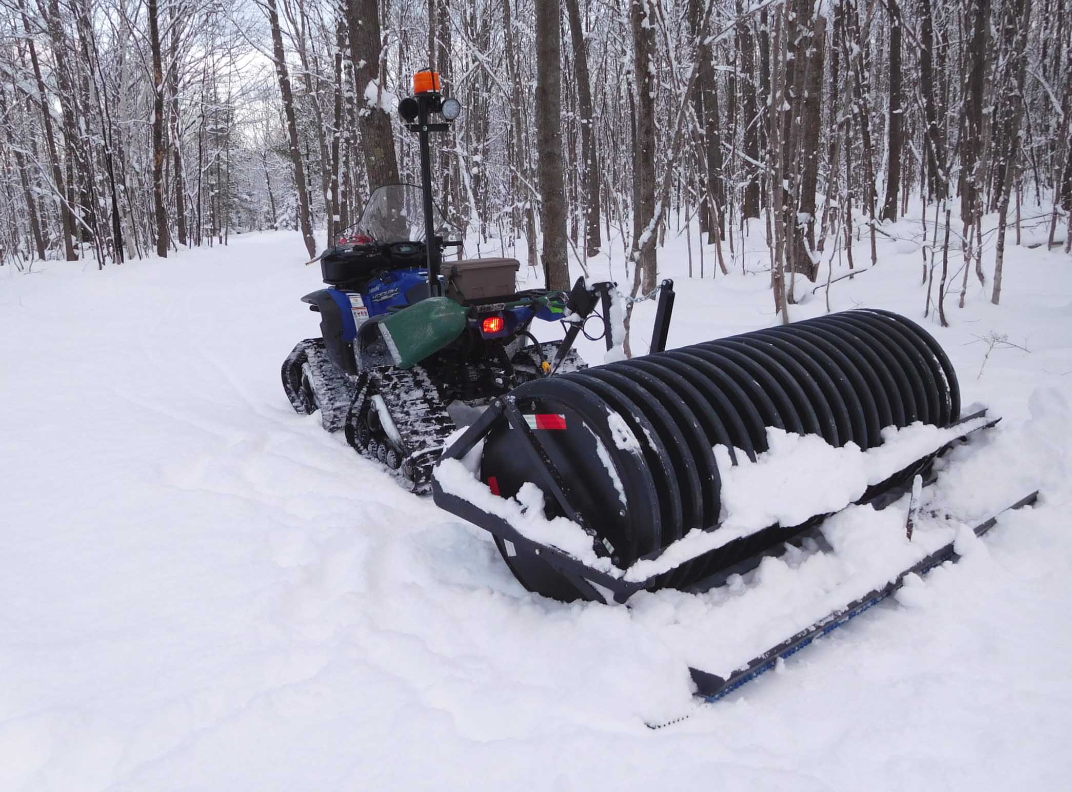

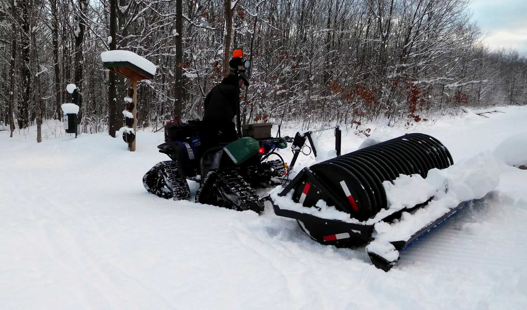

Our brand spanking new Kodiak was put into the field and we have received snow here. Snow control fender flaps remain to be added, but that will get done later. Ops! At least one photo is a grizzly.

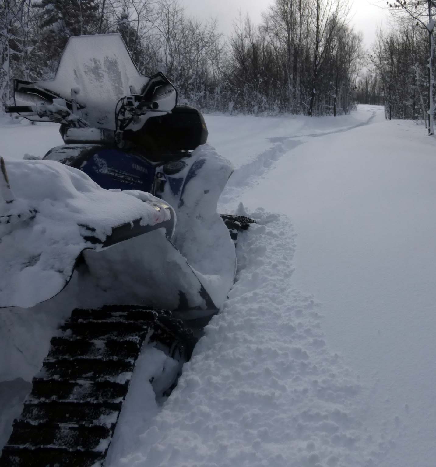

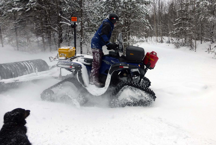

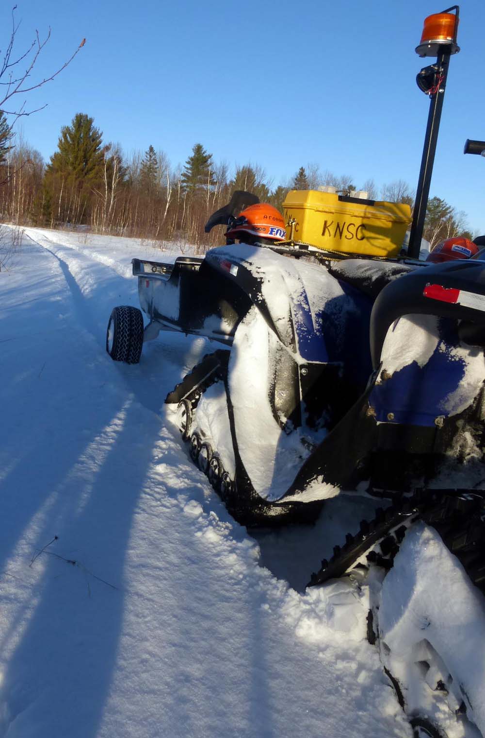

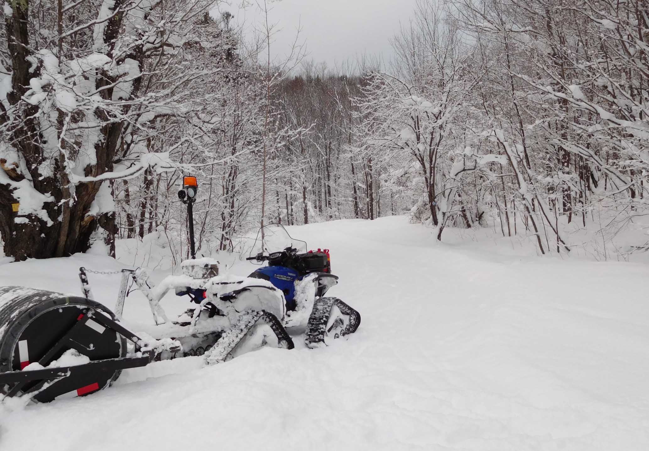

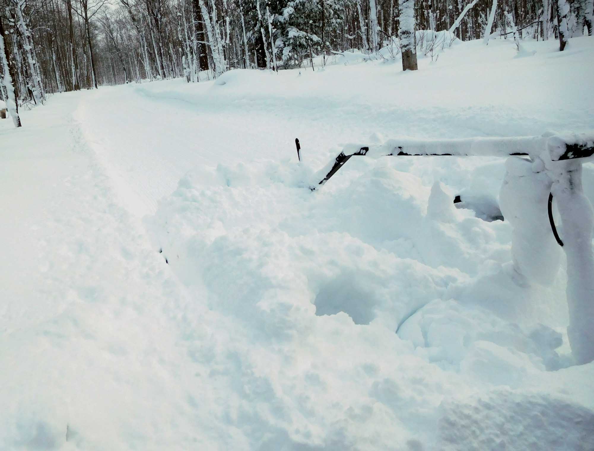

as seen working today
Taken while out today. I've been working daily for over two weeks now. Good news is snow will shut down for a a day. We rolled over 75" today for the season.
