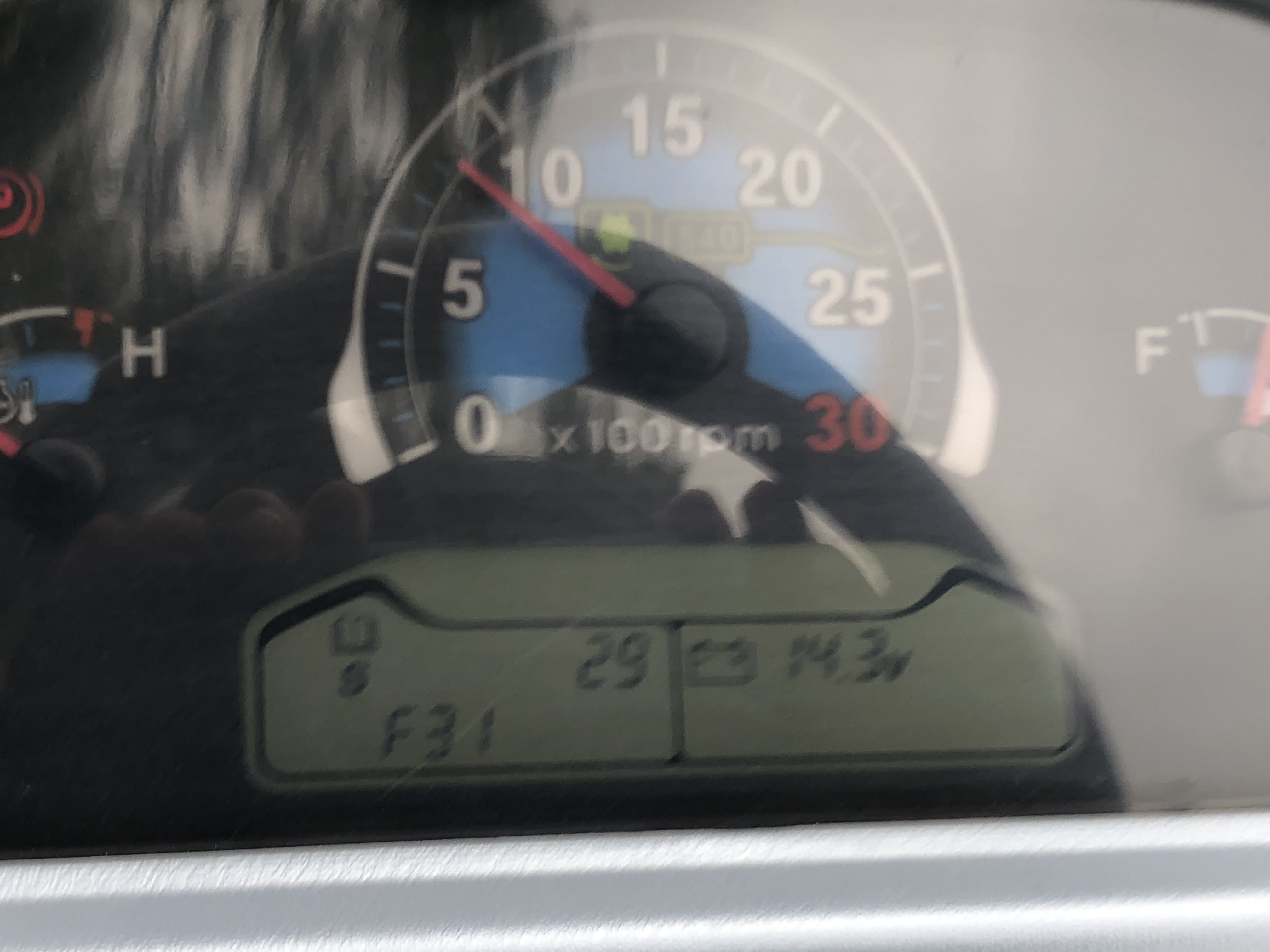

I've got a 2018 XR 4150H. A great tractor, until now. In the short term, confusing at best, frustrating in the least.
Started brush hogging. After about 30 min. went into reduced power mode. Fault codes
29 31 P2138 Hand Pedal Correlation track 1 over track 2 fault
29 31 P060E Hand pedal signal fault
29 31 P2120 Hand pedal signal track 1 fault
29 31 P2125 Hand pedal signal track 2 fault
81 11 P242F DPF fault triggers reduced torque
Pulled over, initiated forced regen.
Regen was as normal.
Warranty date close, but not sure.
It took 2 phone calls, an email and FB message to get response from LS re: s/n and warranty date.
Murphy's law. B to B warranty expired one month ago today.
"Hand Pedal" fault seems to indicate "Hand Throttle Lever".
Was informed by LS that the "Hand Throttle Lever" would not be under the power train warranty (regrettably makes sense) and If I did buy the part and self install, it would still likely need to be calibrated by a dealer.
Cleaned grounds, known factory issue. Grounds were, as expected, painted. Sanded clean. No joy.
Compounding issue is that selling dealer is 800 miles away.
The one bright spot is that a local dealer 45 miles away did give me one other thing to try before loading it on the trailer and bring it to him.
Any thoughts?

I think I may have the same issue. It is an electronic throttle. Many report a similar issue. It works fine if you move the throttle about 3/8 to 1/2 inch up. My dealer told me the same thing, not covered under warranty. I think LS is screwing us, since it is a known fault. I have been using mine this way - never bottoming out the throttle - since last fall.

I found if you open the throttle about 1/2 inch you have no problems. On mine 1/2 inch is about 1000 rpm. I am sure other hve had this issue but LS seems to be clueless. All they want to do sell you a new part!
/ XR4150 no throttle, failure codes, difficulty w / LS support #16
Thanks for the reply. The further I dig into it, it seems that the code I am getting is related to the DPF sensors communicating with the ECU. When this signal is faulty, it affects the hand throttle signal, as the engine speed is controlled by the ECU. I'm not saying that the hand throttle assembly couldn't be a secondary issue, but I believe they are connected. As I read on here, some others have had this issue, and a software patch corrected the problem in about a half hour at the dealer. Mine is headed there this week, and I will report back with my findings.

Got mine back from the dealer. It was the hand throttle assembly. He explained that since it is electronic, the ECU uses it's position to determine how to run, so when it can't get that information, it doesn't know what to do. It cost $250 for him to change it, but it seems to have fixed the issue. I need to put more hours on it to make sure it is not something else, but it seems better for now. It started acting like the fuel system was having an issue (plugged line, dirty filter, etc.). In reality, it was a fuel issue, but caused by a lack of input from the hand throttle.
