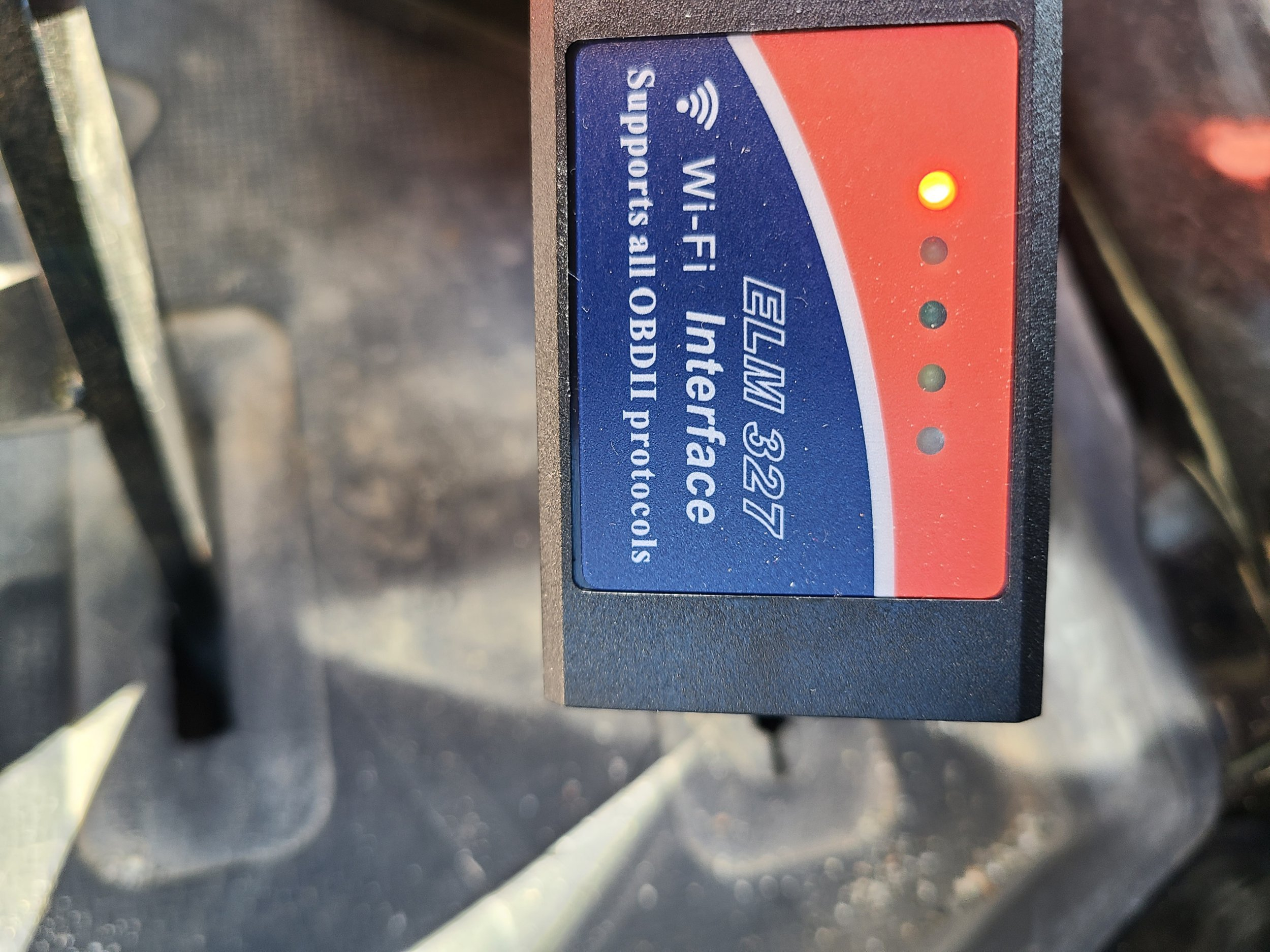

Its ELM327. I ordered mine off Ebay but it shows currently out of stock. Also link to Amazom also out of stock.
See post 44 in the below thread. If I recall it was under $34.
Found the code reader. Where did you find the Cummins Falt app so I can download it to my phone?
   / XR3037H RPM up and down after a few minutes of operation. #53
Cummins fault code advisor is a downloaded app for my android phone. I'm sure there should be other available downloads for other phones. Do a search on your phone for Cummins fault code advisor.
#54
Got it. Thanks. I'll play with it as soon as the code reader gets here from Amazon.
#55
Well got the code reader and hooked it up and turned on bluetooh , opened the Cummins app but the reader will not connect to the phone and just shows one light on. Wi fi or bluetooth was a no go. Tractor was running. Still doing the same thing. Goes into regen then won't complete regen then shuts down.

Regen every 5 hours ? To me that seems very excessive ! My LS XR4155 has only regenerated twice in 180 hours.
I was thinking the same thing. I am about every 60 hours but I dont run it at PTO RPM a ton.

The difference is the XR3037HC (3000) series uses a Shibaura engine which was designed for regen every 5 hours. The newer 4100 series has the LS engine designed for regen about every 50 hours.
