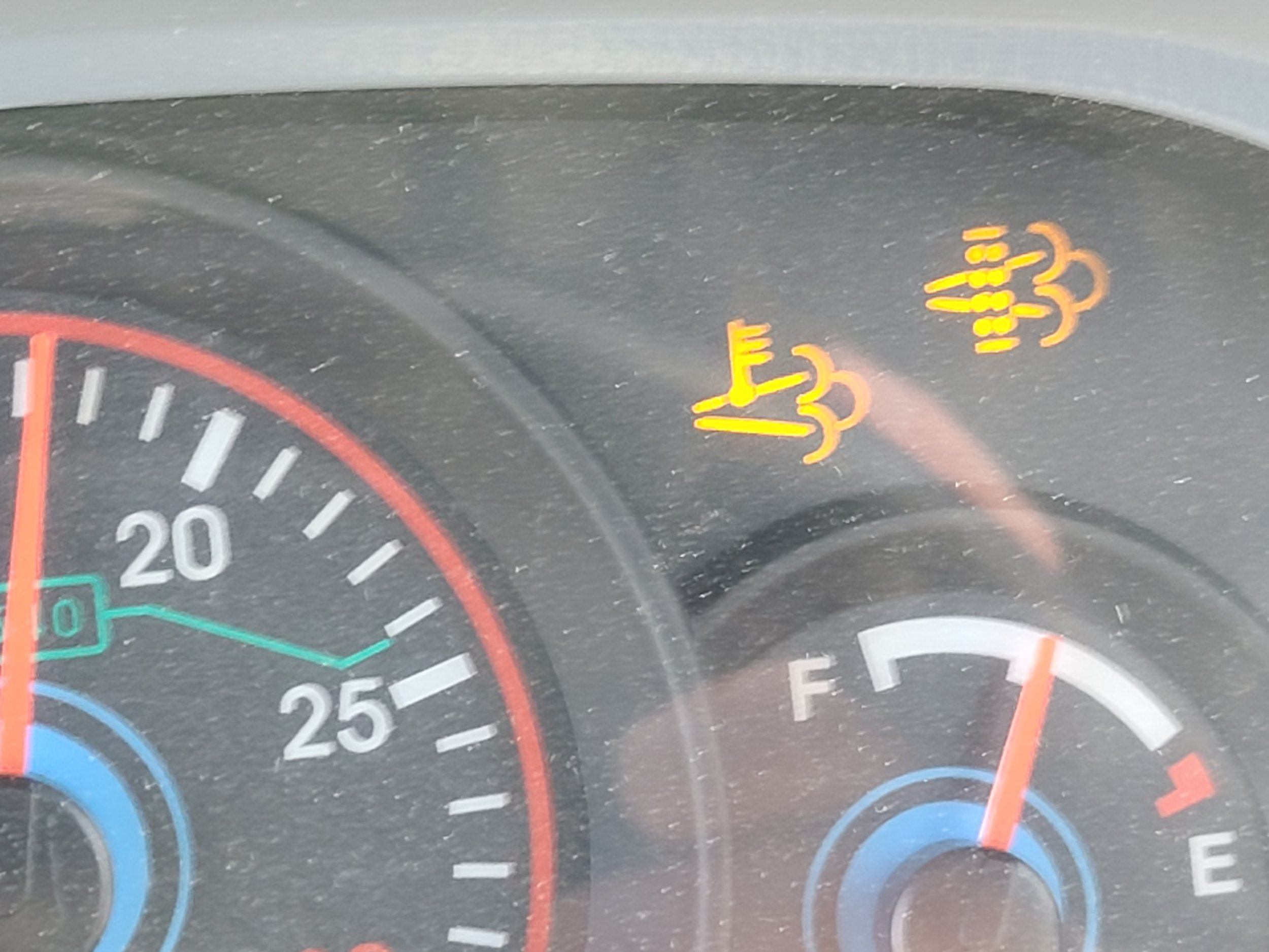

Can you post a picture of your dashboard when the problem happens?

I will fire it up tomorrow and get some pics of the dash when it loses rpms and starts shutting down.

One pic is when it started losing rpm, next pic was when it died. I idled it down a bit when losing rpm then it just quit. According to what I see in the manual it looks like it should of kept running.

No codes show up on the LCD display when this happens? The check engine light on or flashing? Need a picture or video of the entire dash when it happens.
My Mt240 will change RPM's a couple times if I am running under 1800 RPM's if it needs to regen, I think it's to get your attention that it's about to increase RPM's for the regen. The first time I was at 1500rpm and it went up to 1800rpm, another time it went to ~2200rpm. If I'm at PTO RPM I'd never know it did a regen unless I happen to check the gauges and see the lights on the dash.
It does sound like it's in Power limit mode or Engine shutdown mode.

I know from personal experience that a hot engine will put the tractor in Limp Mode. I wonder if you have a faulty temp sensor that is causing the Limp Mode issue. If the sensor is faulty and continues to register high temps, it will eventually cause the engine to shut down. It's a safety feature to prevent engine damage.
