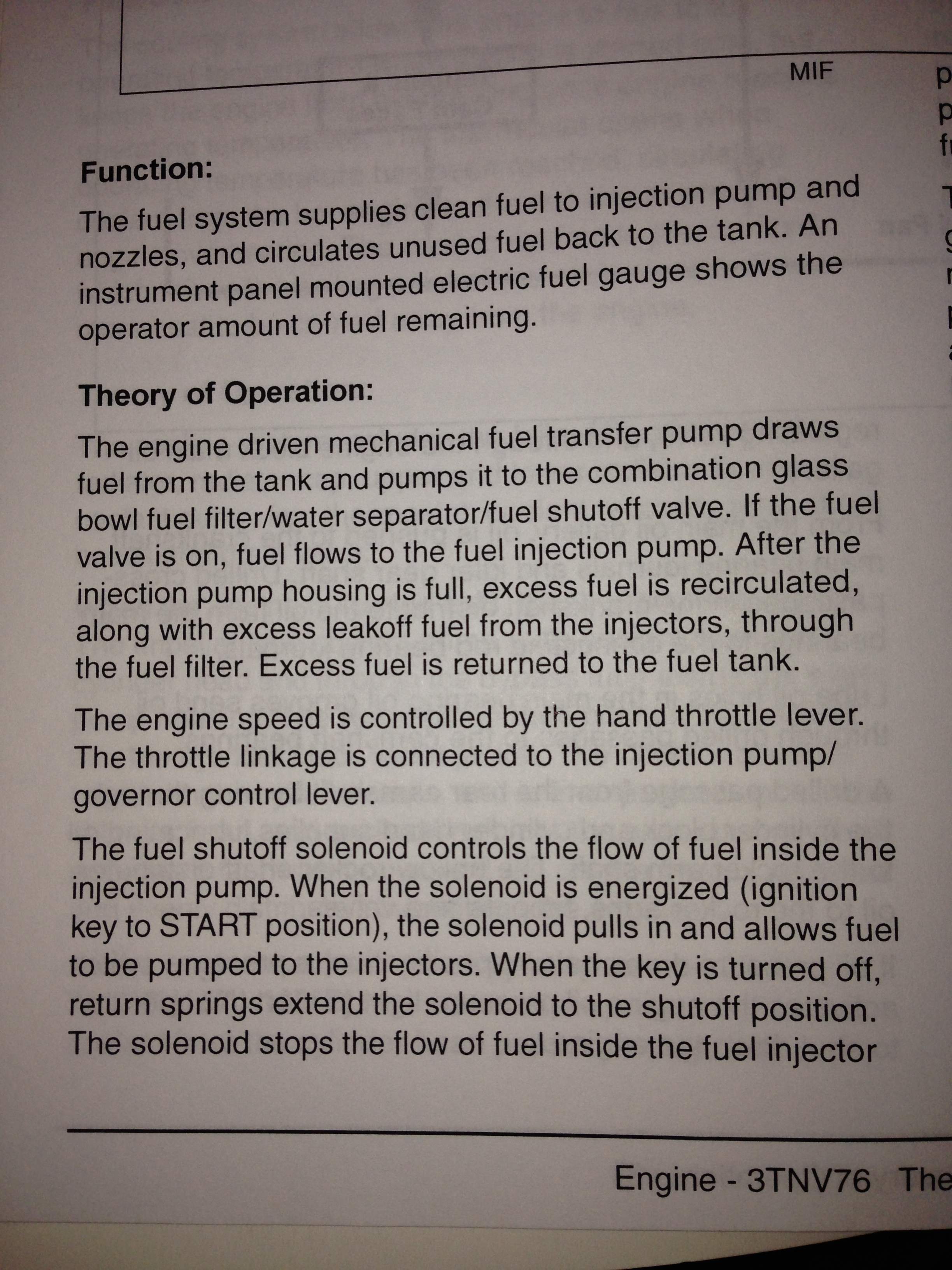

That's odd about the electric fuel pump. My x748 has a mechanical tranfer pump, and JD parts shows a mechanical one for the x595 also. What is the part number for the electric one, and where is it located?

Thanks, I would be curious as to what your x749 has on it. The x748 is auto bleed, but with a mechanical fuel pump, the only thing that bleeds it is the starter motor. It takes 5 or 6 episodes of cranking for 5 secs to get it running after a fuel filter change. Then 30 seconds or so of pretty rough running. Filling the bowl first would be nice, but it's pretty tight in there, so I would be spilling it all over.
It would be nice to have the hand priming pump like the 4x20's (which also have mechanical transfer pumps).
From my X748 service manual:
