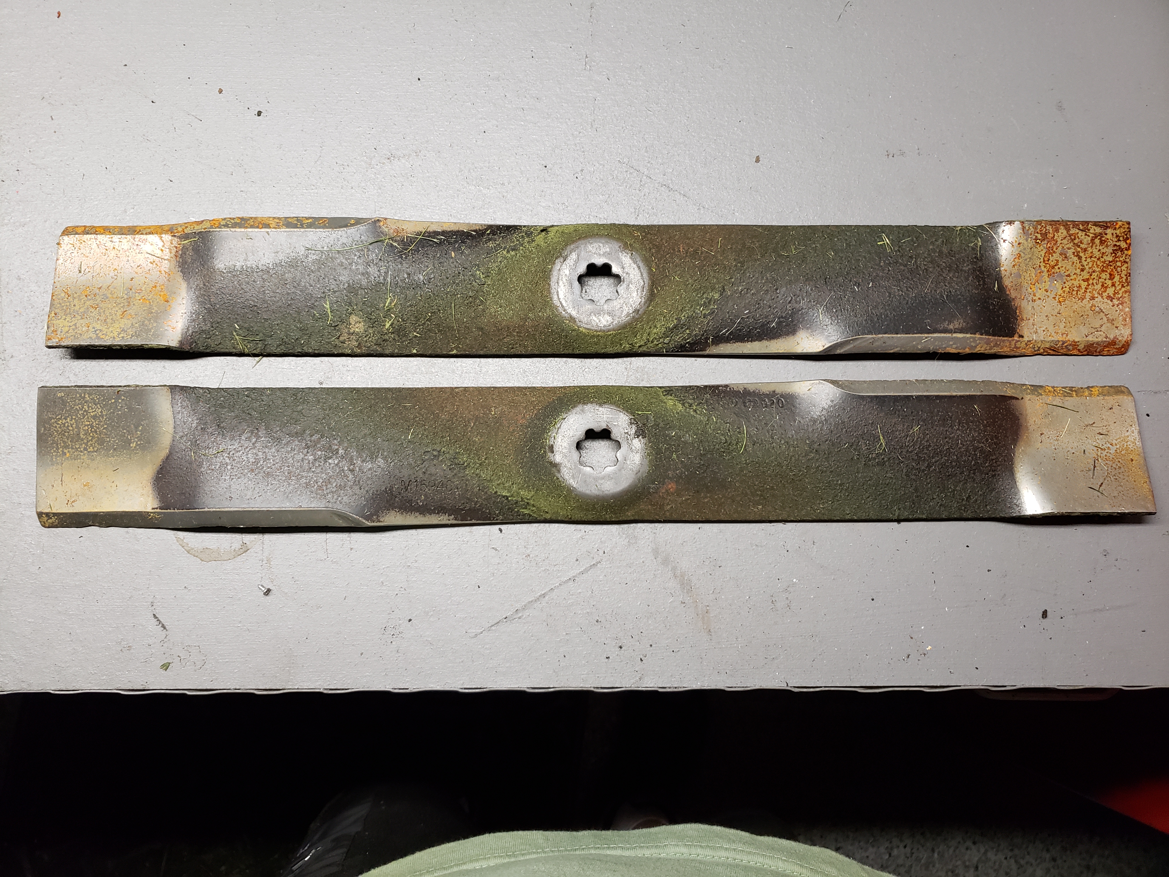

/ X300R cutting problem
well mine certainly look different to me?

When leveling the deck, do you start with checking that tire pressures are correct? then right and left blade clearance to the level surface are correct? then fore and aft tilt is 1/8 - 1/4" low in the fore ?
Blades sharp? the ones in the photo are not very good shape "sharp-wise".
Copied from the owners manual about the blades.. yours a 42" deck??
IMPORTANT: On 42 mulching mower, blades are marked right and left on bottom side of each blade. Make sure to install correct blade to right and left sides of deck.

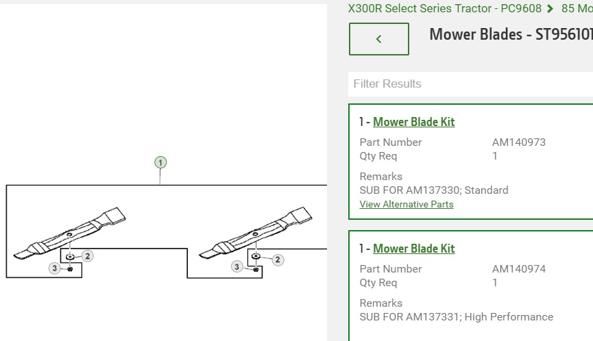

jdparts show two style of blades.. sold in a kit..

im pretty sure those blades are the wrong ones
Just found that same quote in owners manual.
So that tells me my deck has opposite direction blades. I wonder if I could have gotten blades for a x300 and perhaps they do not spin counter on those? Now I need to track down the proper blades
