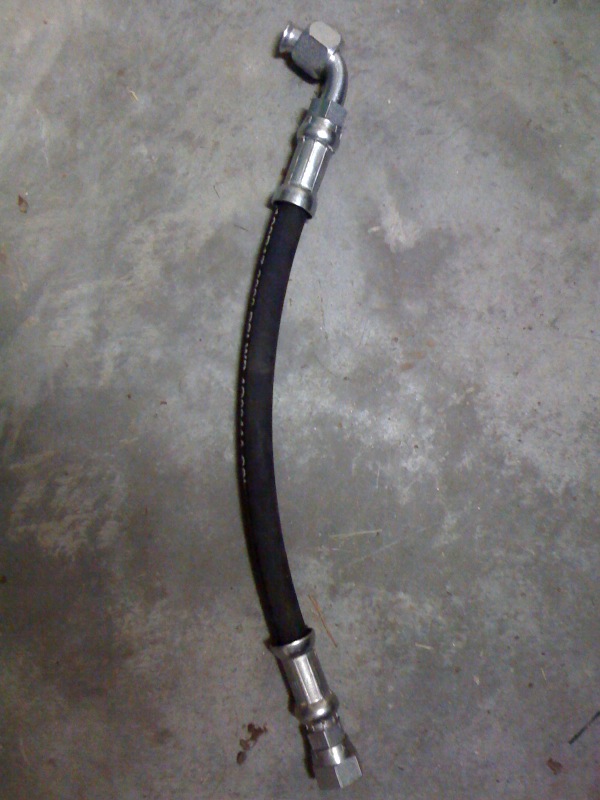

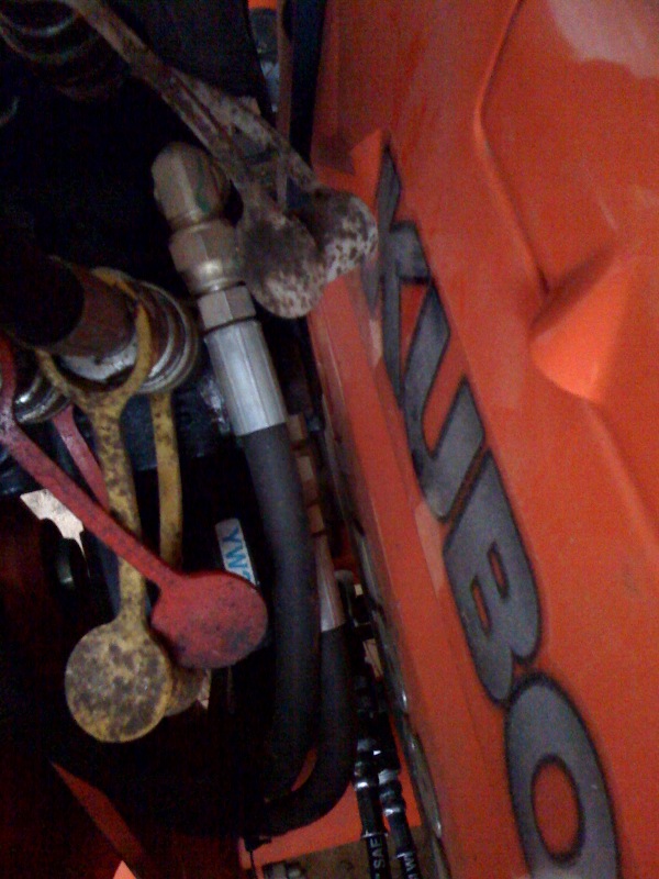

I have an L5030 with a LA853 fel and want to hook up the wr long valve and grapple. I am not sure which hose to disconnect from the tractor and connect to the P side on the WRLong valve.
Here is a picture of the hoses. One of these must be disconnected and reconnected to the WRLong valve. Don't know if it is the top or bottom one. Also a pic of the valve on the fel if that is easier to tell.
Also...anyone have any hints on how to route this little hose from the valve body on the tractor to the T side of the WRLong valve? Seems like it needs to bend quite a bit.

The hose you need to disconnect will go to the loader valve's IN or P port, not sure which one that is on the manifold.

The flow needs to go from the Power Beyond Port to the "P" port and then out the "T" port. On all of the Kubota valves that I've seen there is a green mark, green piece of tape, or something green indicating the power beyond port. Remove the Hose connected to the Power Beyond Port and connect it to the "T" port on our valve. Connect the hose in the kit to the power beyond port on your loader valve and the other end to the "P" port on our valve.
