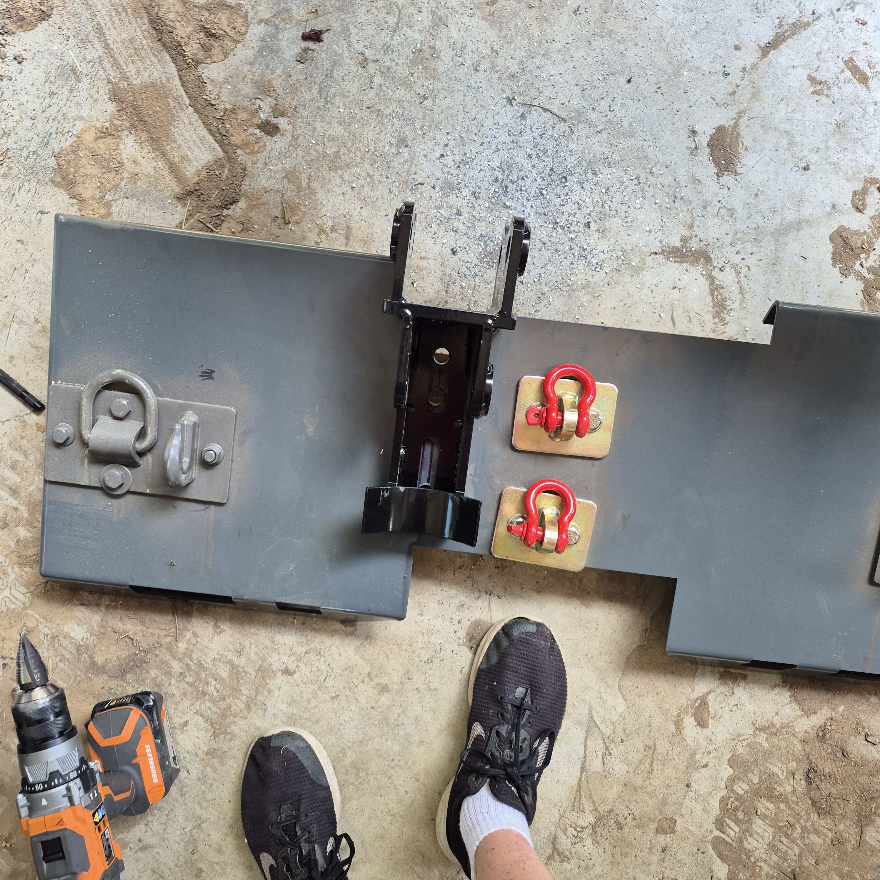

Can you post a couple pics of the mount you built for your auger.
I am not home to get better pics right now, but I didn't have to fabricate anything for the mount. I bought a blank SSQA plate off Amazon. The mounting bracket came with the auger, it was meant to mount to the mini-excavator quick attach pins. I just bolted the bracket straight to the SSQA plate using some 1/2" bolts.
