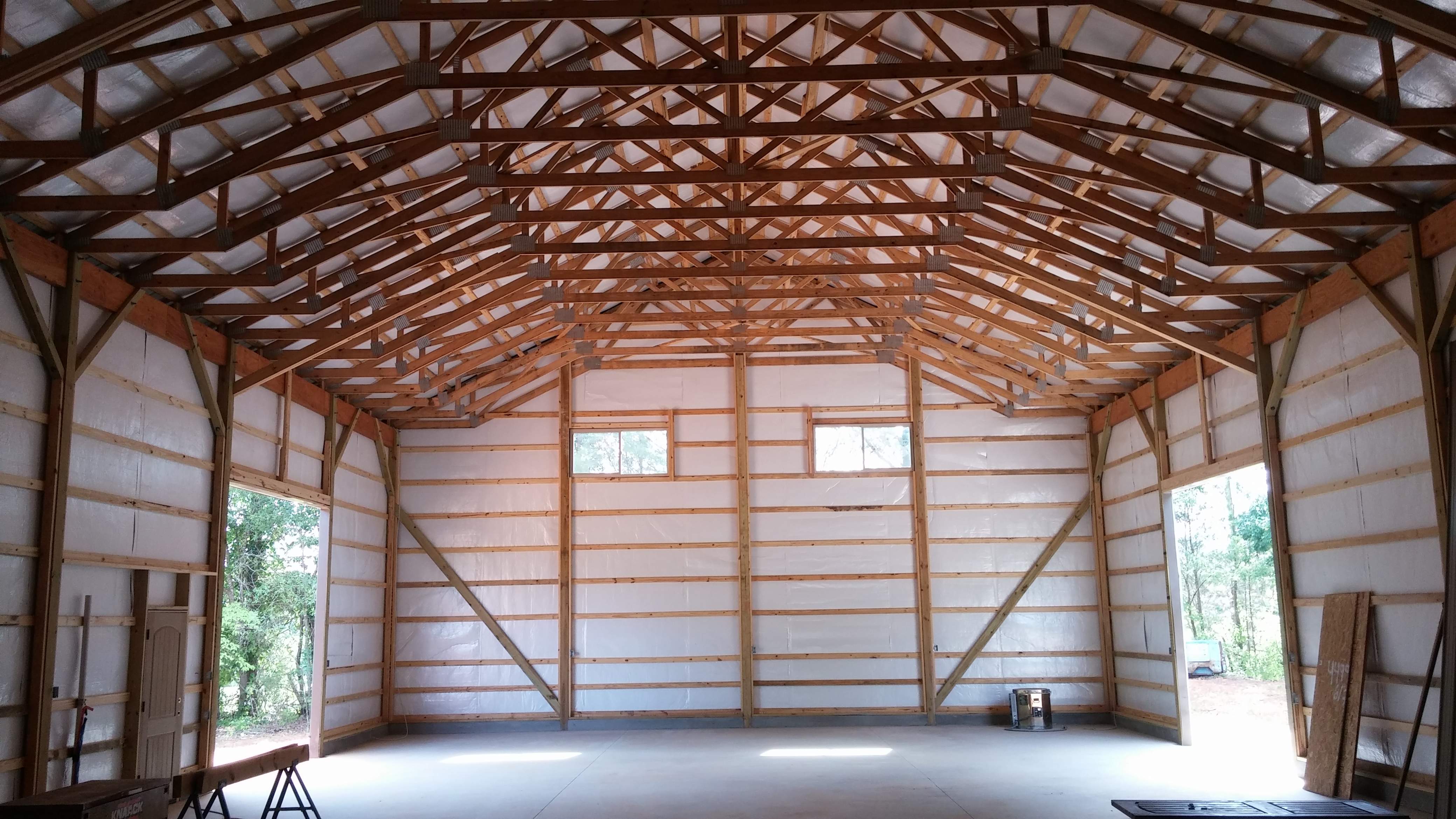

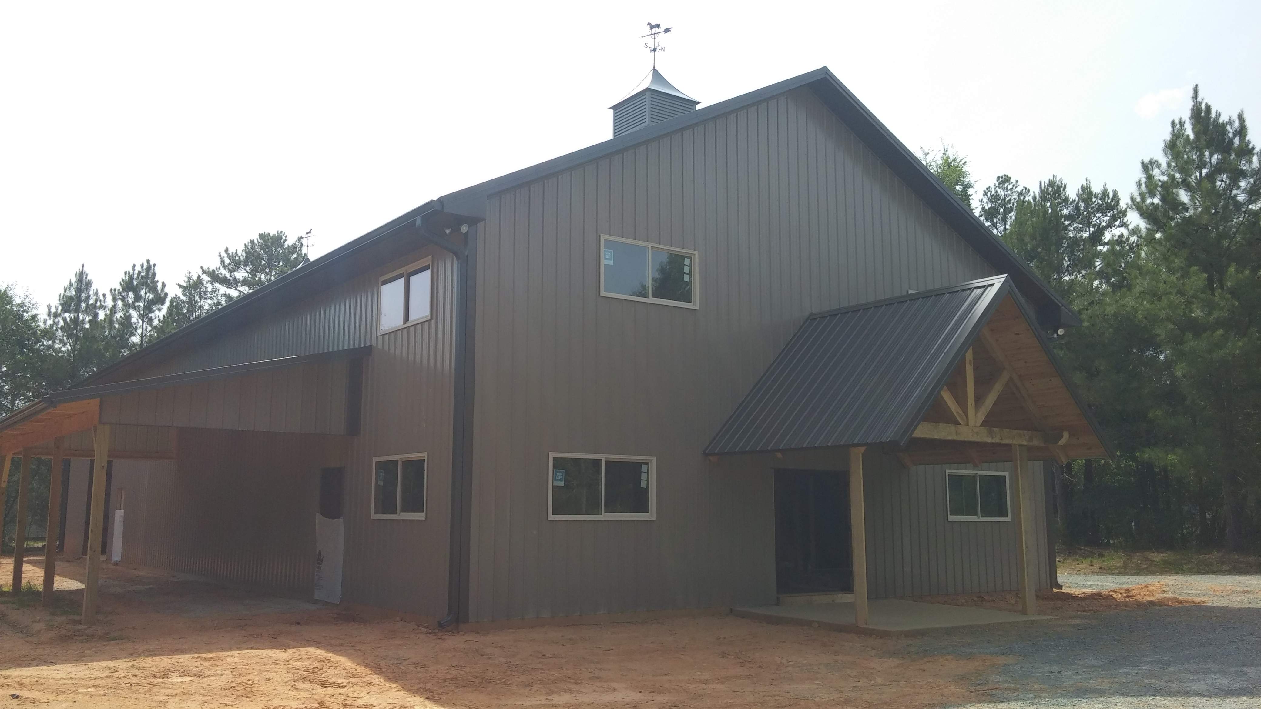

Its 42'x96' with a two story living area in it.

Looks nice what are you going to use to insulate it? with mine I am going to get the walls and gable ends spray foam 2".

I like the trusses. I bet they were pricey.

Nice barn. Barnbuilder, what do you go with for posts and how do you prefer to set them as far as footings, drainage, etc?

18' walls?

Very, very nice. What $ did this go for? If I may ask.

Walls are about 17'6". Living area I framed it conventional with 6" walls and monolith slab. 6x6s for posts. Code requires a 24" hole for posts with 8" concrete under posts. I put 12" in. 4" slab with 12" curb around perimeter.
About $160k not including electric, plumbing, hvac and finish work.

Looks very nice, but why go with those raised trusses when the door height is so much lower then the lower part of the trusses? Seems like a huge additional expense without any benefit.

We used them in the living area for ceiling height. Customer wanted the in the rest of building also
Whatever makes the customer happy.

Same issue here. I did everything I could to get them in their price range. Then they bought knotty alder doors. Had to have the cupolas which cost me $2600.
