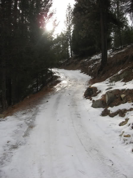

One thing I would add, although you don't have a BH I'd suggest having the road ditched on the hillward side of that stretch of driveway you say ices up mostly from run-off and making sure there is a good crown in the road. By the photos it looks like a significant grade on the opposite side of the road and it doesn't take much to start down a slippery slope while removing snow.
Not trying to scare you but it would be one of the first things I'd suggest you get done if you plan to continue to work your property over the winter months.
What is a BH?
I was watching a video on everythingattachments on using a box blade and it looks like it wouldn't be hard to add a small runoff ditch on the hill side of the driveway. My plan is to grade it up, dig in a runoff ditch, get chains and then use the box blade to rip the ice out if it starts to build up in the winter ;)

Hadn't thought of that. I'm assuming though that I can do a small ditch with the box blade (as in the video) though arguably that might be tough because of all the rock...guess we'll see!

Last one -- notice the ICE -- it can get 6+ inches deep on this road. Mostly from the snow melt both on the drive itself but also the trees.
Wow. I don't think you're going to fix this lack of high-side drainage with just a CUT and box blade. Given how many rocks you've got, you'll probably need a backhoe or excavator. Sorry.

One thing I've considered is adding gravel/dirt on top of that part of the road until I'd built it up enough to put a shallow ditch on the high side.
Thoughts?
