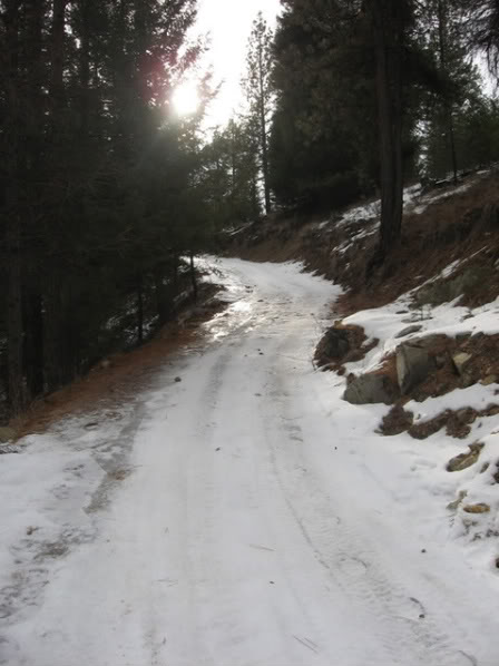

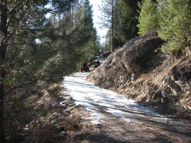

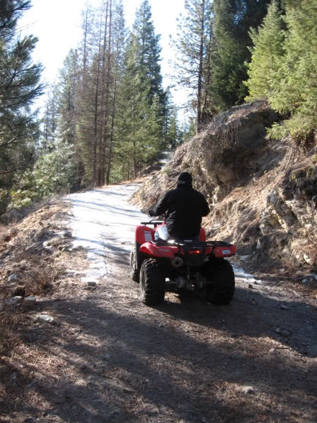

Last one -- notice the ICE -- it can get 6+ inches deep on this road. Mostly from the snow melt both on the drive itself but also the trees.
Wow. I don't think you're going to fix this lack of high-side drainage with just a CUT and box blade. Given how many rocks you've got, you'll probably need a backhoe or excavator. Sorry.

One thing I've considered is adding gravel/dirt on top of that part of the road until I'd built it up enough to put a shallow ditch on the high side.
Thoughts?
I'm also thinking I need to get a rock rake to both clear rocks (we have a lot of them perhaps because it's all glacial drift) and to clean up the wood debris from years of the forest being left to itself. Much of it is rotten or partially so but I'm sure a lot of it, hidden in the grass, would be hard on a mower?
I'm wondering if I wouldn't have to rake the acreage before mowing it?
