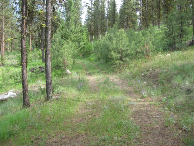

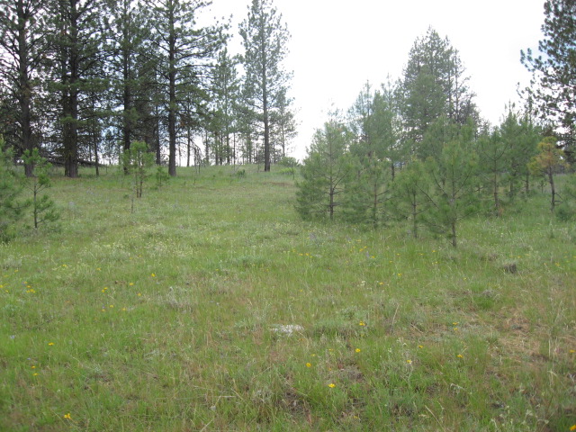

That should give you an idea of the slopes I'm going to be mowing.
After another chat with the Mahindra dealer it's going to come down to cost vs. need I think. At nearly $4000 more for a 4530 or 4035 the 3616 is looking like the tractor I'm more likely to choose if I go with Mahindra and 35hp (actually it's 36hp).
Might be nice to have a bigger tractor but that $4000 could go a long way to buy implements etc and it sounds like the 3616 will handle the job fine.
As for the hill, I'll have to play that by ear and only tackle it once I have more experience. I also have a driveway to get the snow off of (and ice)....yes chains will be required in the winter -- no way around that....let me find a pic of that drive to see what you think ;)

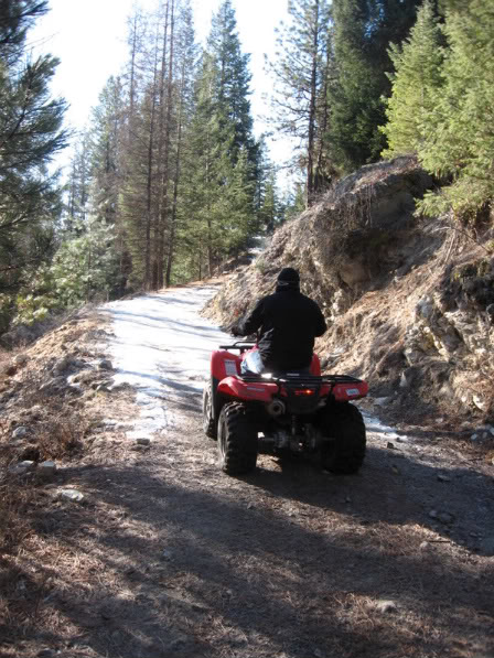

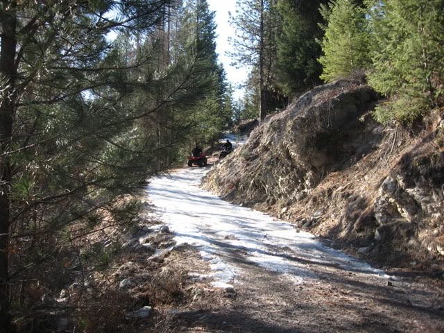

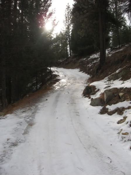

Here's a shot of the driveway/easement road -- it's the steepest and worst section of road I have. I hope to be able to clean it up each year and keep the snow and ice off of it as much as possible in the winter.
There's another shot of the driveway.
Last one -- notice the ICE -- it can get 6+ inches deep on this road. Mostly from the snow melt both on the drive itself but also the trees.
Treacherous in the winter but with 4wd, limited slip and 4 chains on my jeep it's no biggie :)

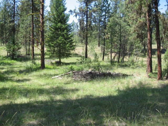

Just in case you all thought my 20 acres was just a big side hill ;)
There's quite a bit like this also.
Now looking at all these pictures makes me want to get BACK! Sheesh...come on FRIDAY!
Well from what I can see here, this don't look too bad.. its doable.
Um.. I don't like the looks of this with snow and ice on it.. but I am a mostly southern boy.. be sure to use chains is all I say.
Of course this if fine... pretty too.
Thanks, that's probably the steepest section I would mess with. The rest the deer and cows (free range) can deal with.
Lots of work there to do! Of course, I also have a cabin to finish.....:confused2::mur:
James K0UA
LOL I don't like the looks of it either -- specially when it's covered in 6 inches of solid ice and 12 inches of snow! Even with chains only on the front you tend to pucker going up and I grew up in BC (British Columbia CAN)!
