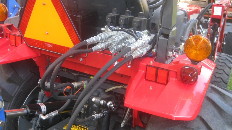

To the best of my knowledge, LS has not made a 3rd rear remote available for these models. You can add an electric diverter and get the 3rd set that you need-want.

What exactly is that and how does it work? And does it work as good as a 3rd remote?
   / Would you like to add 3rd Rear Remote to LS XR4XXX??? #13
For your LS, yes it will work just as well as the factory valve, it is the factory valve, only diverting the fluid to a different set of couplers.

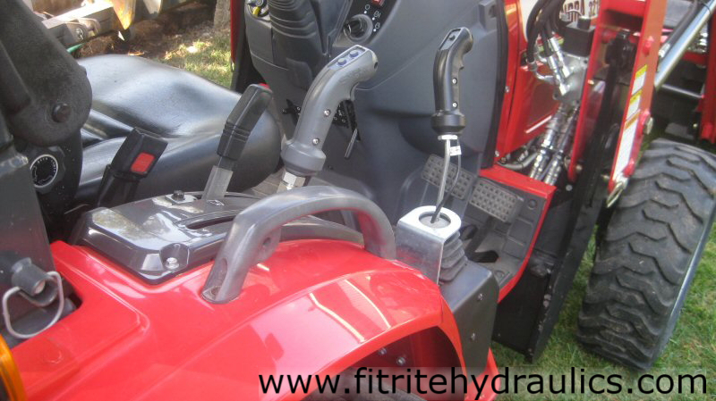

My tractor only had a single rear remote available, I needed 4 sets of rear remote outlets. I tripled the diverters to get that. For my application, this has worked every bit as good as if I had 4 separate levers, but I have only 1 lever (gray pistol grip with 2 thumb buttons and a trigger switch)with a control grip that has 3 control switches in it. 1 for each diverter valve.
