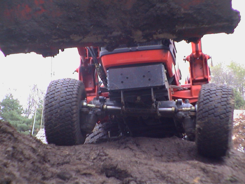

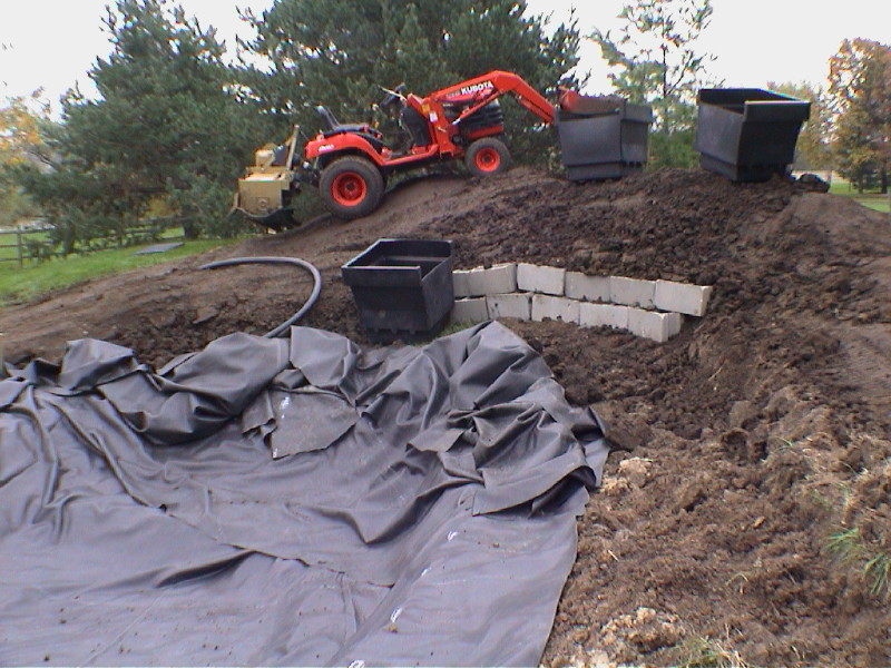

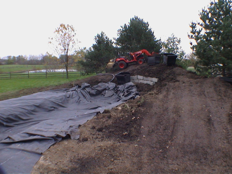

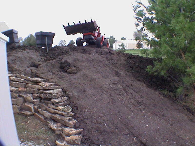

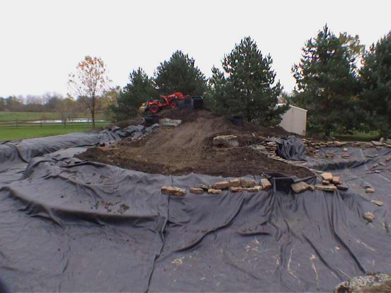

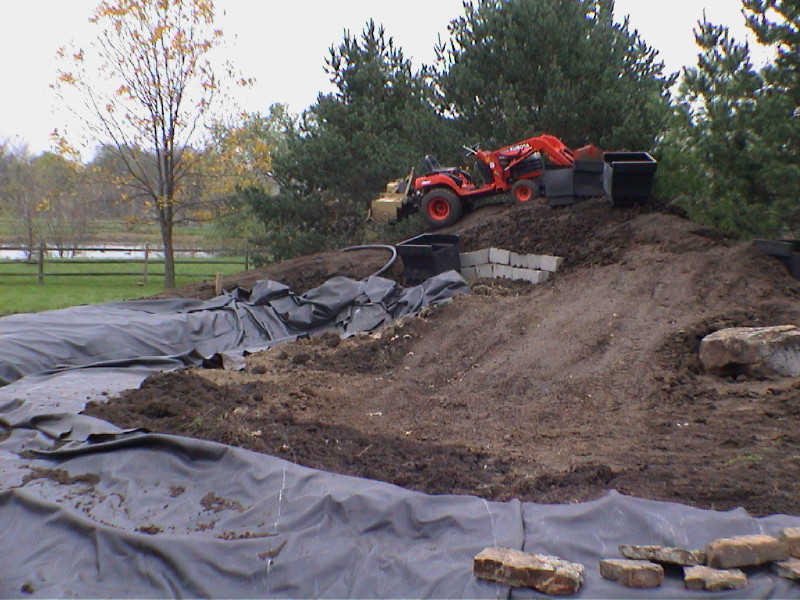

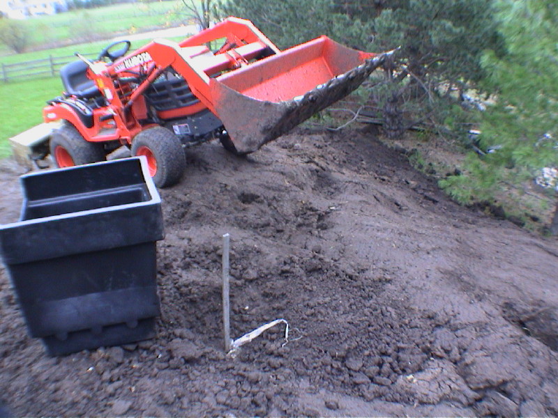

The hill should be no problem as long as you pay attention to what you are doing. If you have the FEL on the tractor, then definitely go up forward. If you only have something on the rear, then it will be a little "pop-wheelie" and I suggest backing up the hill. If you have problems with traction going in reverse, then reverse the front tires to run the opposite direction. This is what we used to do with combines in a muddy field. You always wanted to have better traction backing out of too much mud rather than taking you in.
My first BX2200 had turf tires only and you can see from the following pics that hills are no problem. I dug out a pond and made a large hill for a large waterfall feature.
