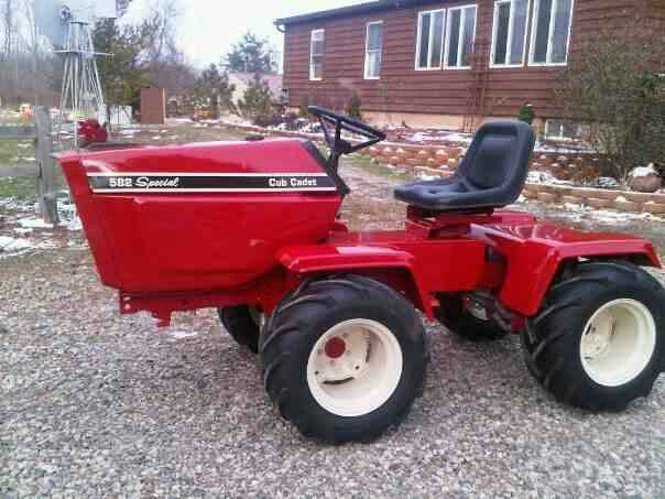

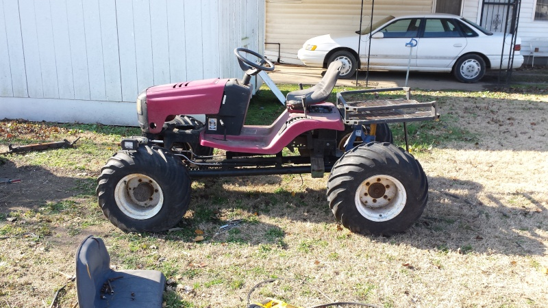

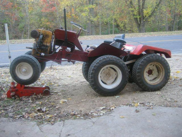

Do it. Here are some that have been done: homemade 4x4 tractor - Google Search
