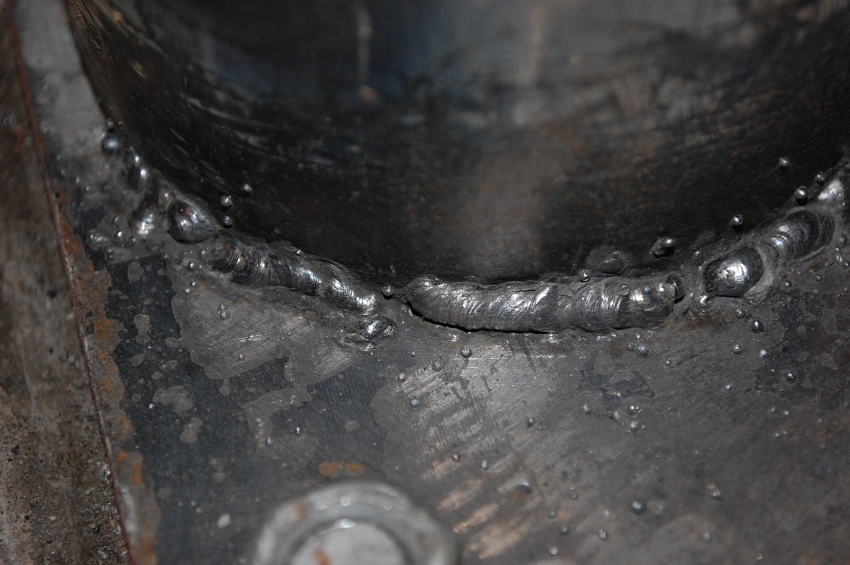

OK. I read all the expert opinion that everyone was nice enough to give, then went and bought that 110v wirefeeder anyway. :eek: (It was on sale at Northern Tool plus I had a coupon). My thinking was that I could do the job by making several passes.
Since the metal is pretty thick (1/2" and 1/4") I set it to the higher of the two power settings and dialed in the wire speed on a pieced of scrap according to the instructions. I was getting some pretty nice test beads on the scrap, but when I tried to weld my pipe columns, it got real ugly. Here is a photo...
(get a barf bag ready...)
It looks like I'm having difficulty getting penetration on the baseplate which is not suprising since it is 1/2" thick. Are there any tricks that could help me out? If there is no silver bullet for this, I'll probably just rig up that extension cord for my 240v stick welder and get it done with that. Thanks.

220 welder.
