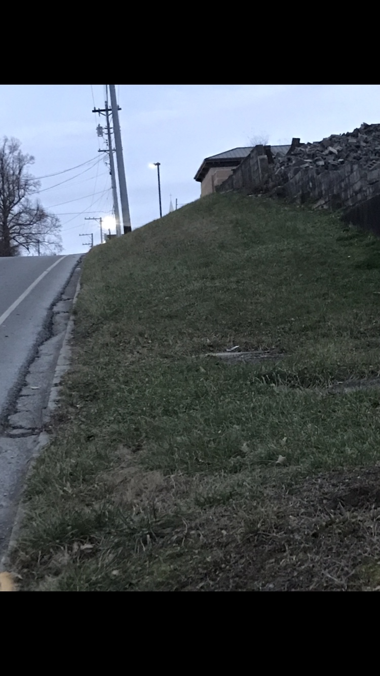

If you do move up, consider getting a zero turn mower instead of the mid-mount mower deck. Its about a wash price wise. The zero turn will be much more stable on your slopes. You pretty much can't roll one. They will slide way before rolling. (of course, if you try real hard...) This is what I do. But, I have a MX and it doesn't have a mower option. That and the weight would make ruts large enough to kayak in.
I agree but it takes a big heavy unit not a light dinky one that $3000 or less buys. Here’s a hill that I mow on ZTR that’s about 30 degrees. And the tractors can’t touch the mowing speed of the ZTR. And I don’t have to bother with dropping a MMM for tractor work or dropping a loader for mowing.

Yeah, I mow a pasture with a zero turn. Way faster than a tractor. I have a similar, but large expanse, slope I mow. I'm fearless on the ZT. Wouldn't put the tractor on it for nothing.
In terms of cost, I have no clue on the OP's mowing situation except that his existing mid-mount works for him. Given that, I think a modest ZT would work. He could get a consumer grade 48 inch and still cut the lawn way faster than the tractor. Now, if his mowing is "robust", your into a $6 to $10k unit. My mowing exceeds "robust" and I went gently used and got a Simplicity Cobalt (same as a Ferris IS2100). A Snapper 360Z is about $3k and would likely do fine.
