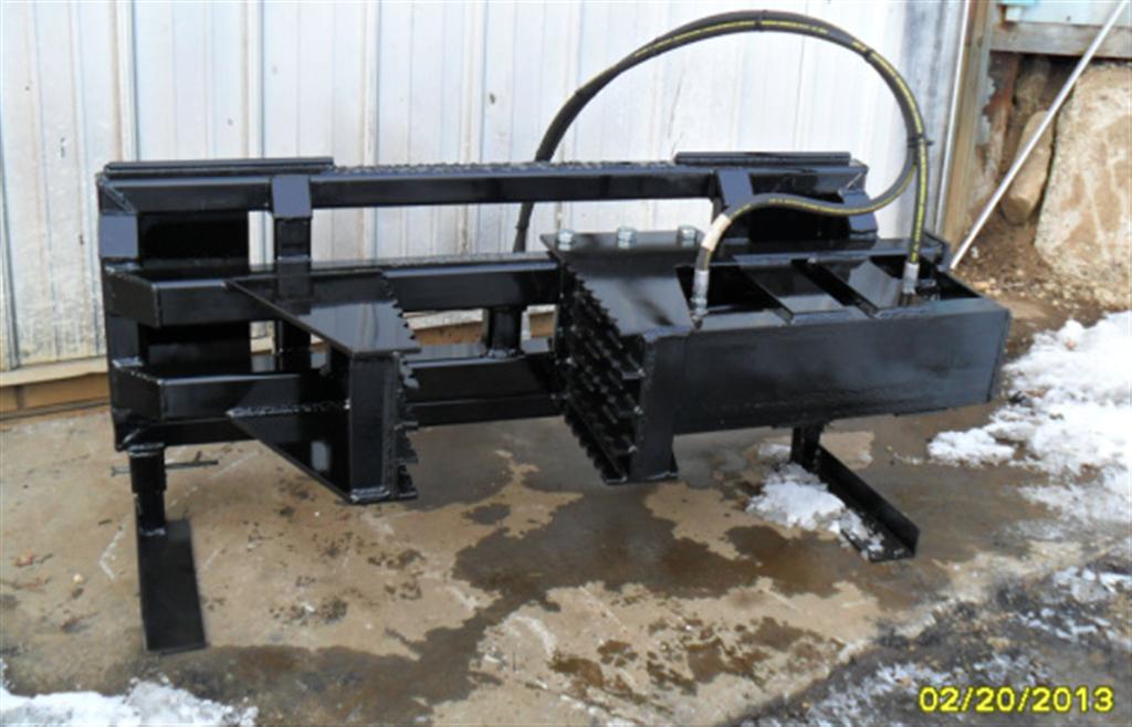

2) Has anyone used either the Brushgrubber Tree/Post Puller or the BucketSolutions Post Puller or anything similar? http://www.tractorbynet.com/forums/attachments/277824-tree-puller.html
If so, can you share your thoughts?, I have a Brush Grubber BG-20, too slow and too heavy at 36 pounds, to use for very long.

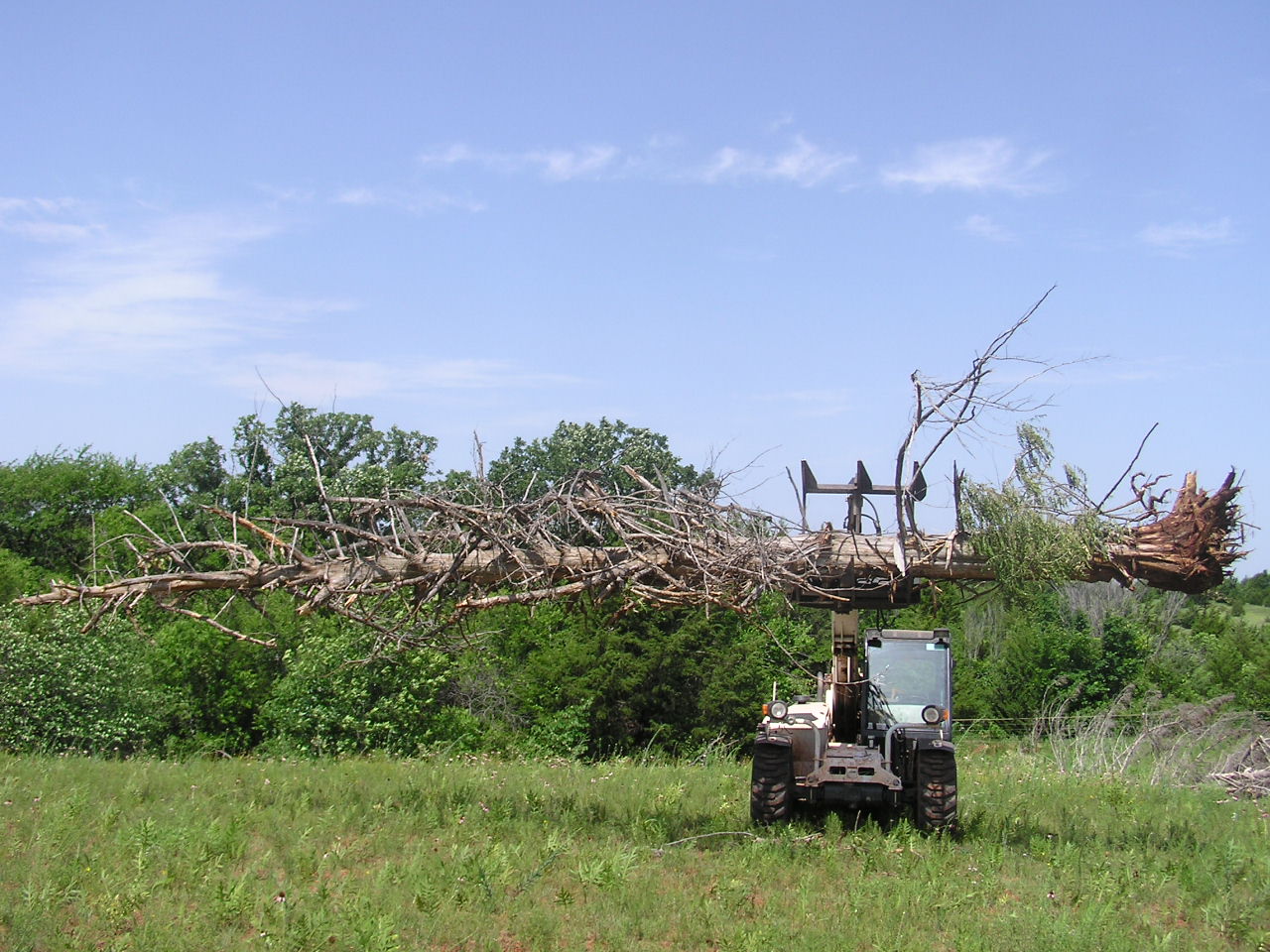

5) If I go narrower, am I going to regret that decision when it comes to picking up the fallen trees in the woods? No, lift at the balance point.

Buckthorn Puller - Custom built Skid Steer attachments to fit almost any need you may have.

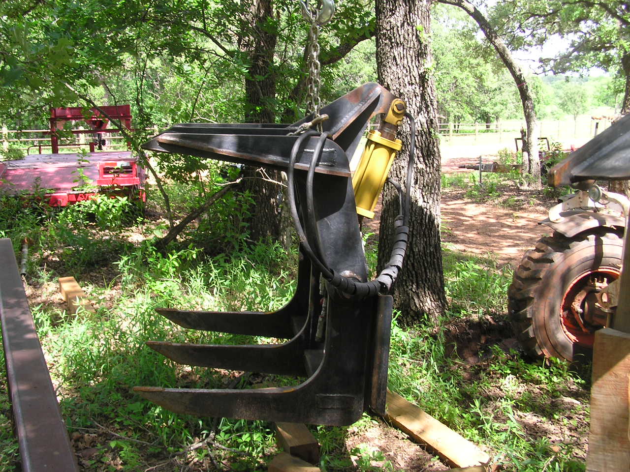

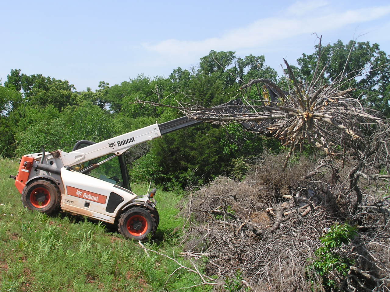

Answers above.

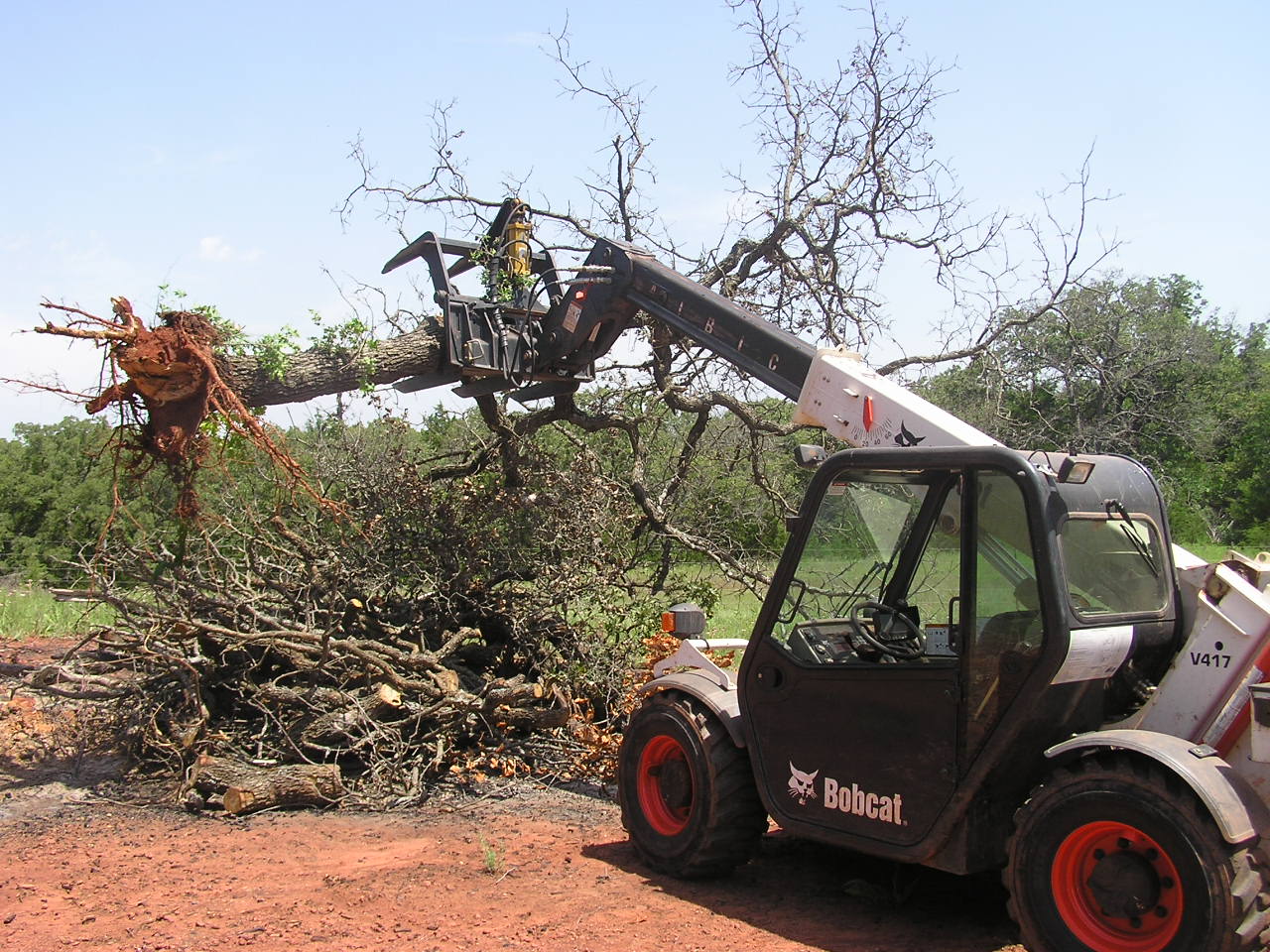

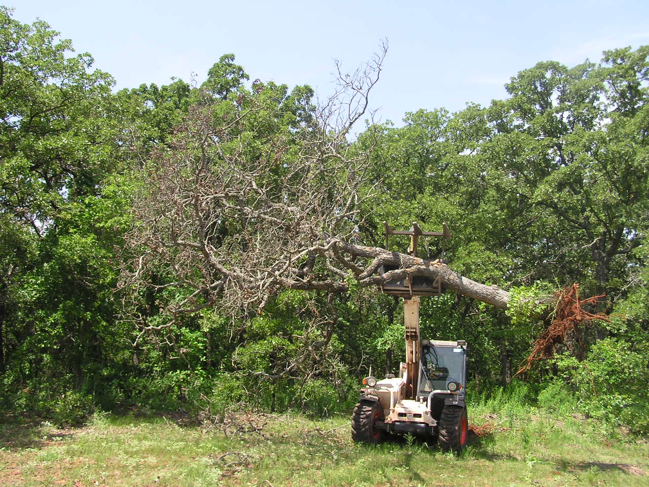

Question #5, narrow grapple 44" wide, notice that the top tines are up.

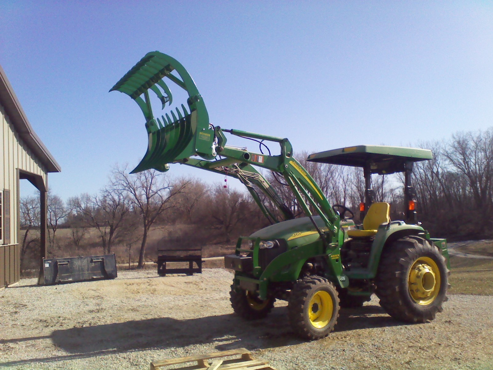

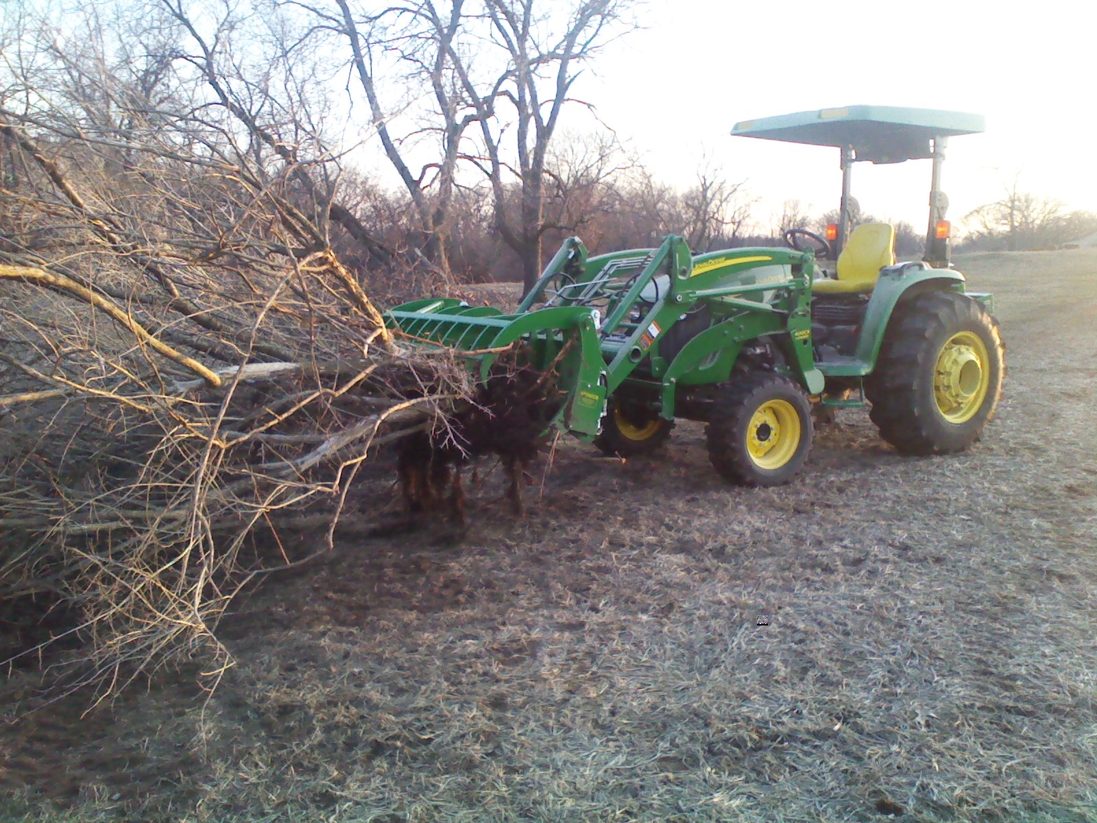

I think you would want a "no brace" design to allow the tines to sink in a little better. I prefer a single lid for grubbing out brush because the center of the grapple is covered better. I have a BoDozer grapple and it works great for honeysuckle. I don't think you need to go as wide as the wheel track...it would be nice, but may get a little too heavy for the 300cx.
Here is a picture of my BoDozer with a honeysuckle in the jaws.

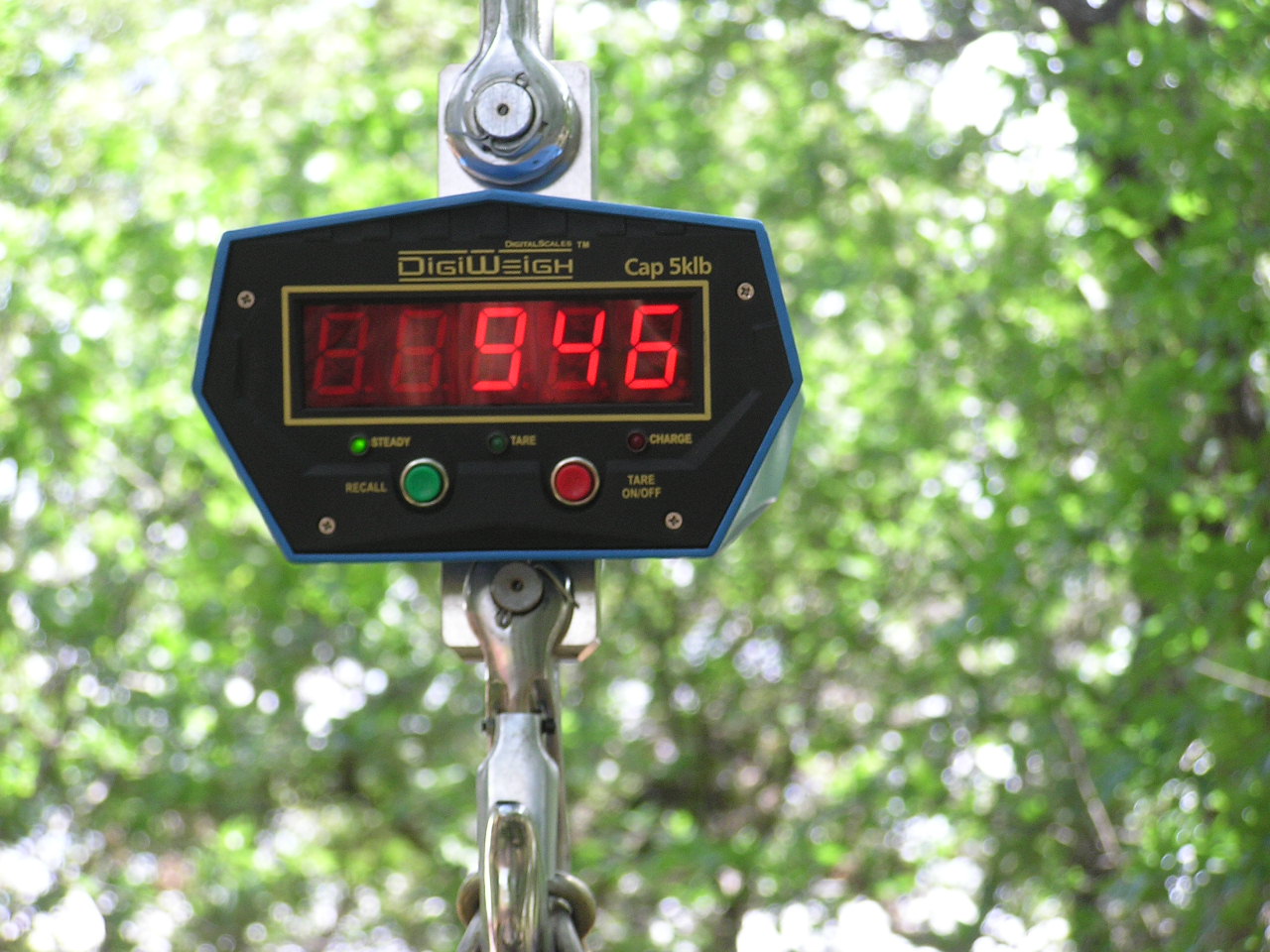

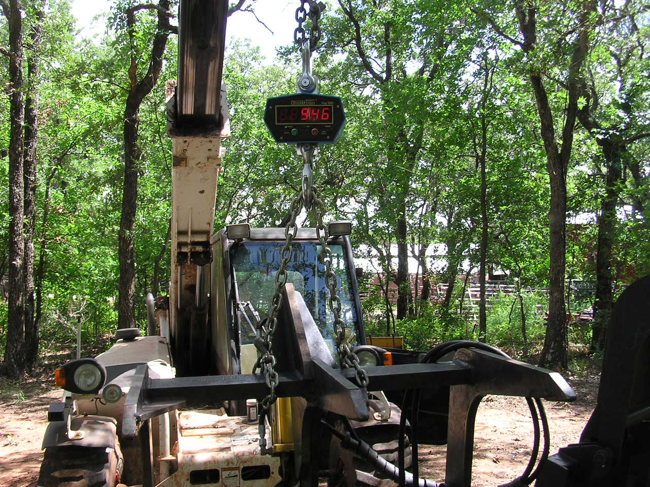

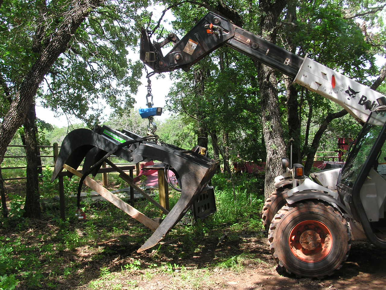

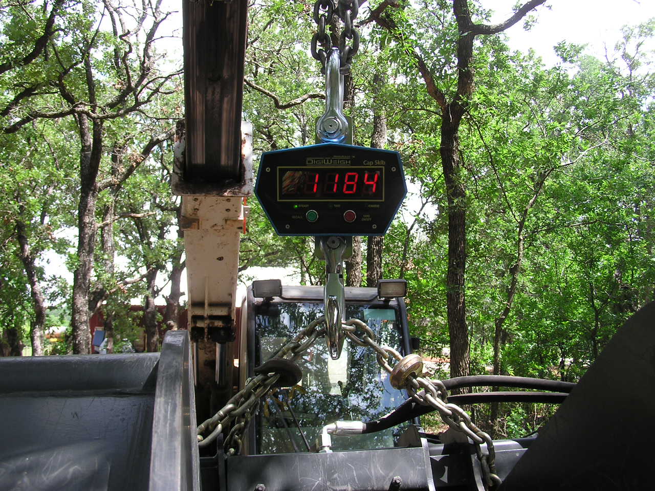

Be sure you ask them how much it weighs.
My little one is 946 pounds.

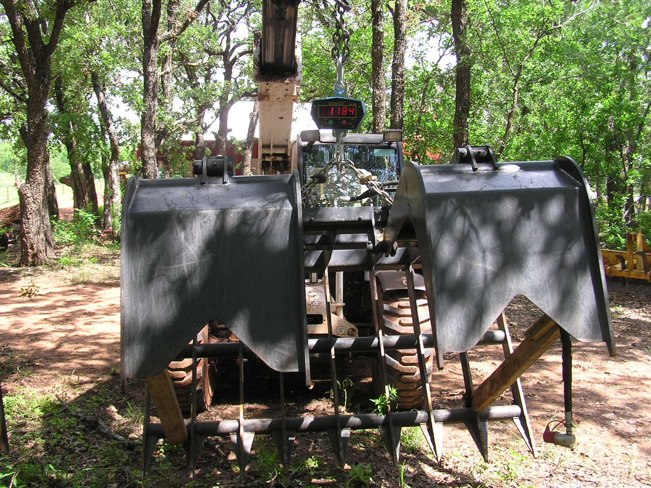

The 6' wide Monster Grapple is 1184 pounds.
