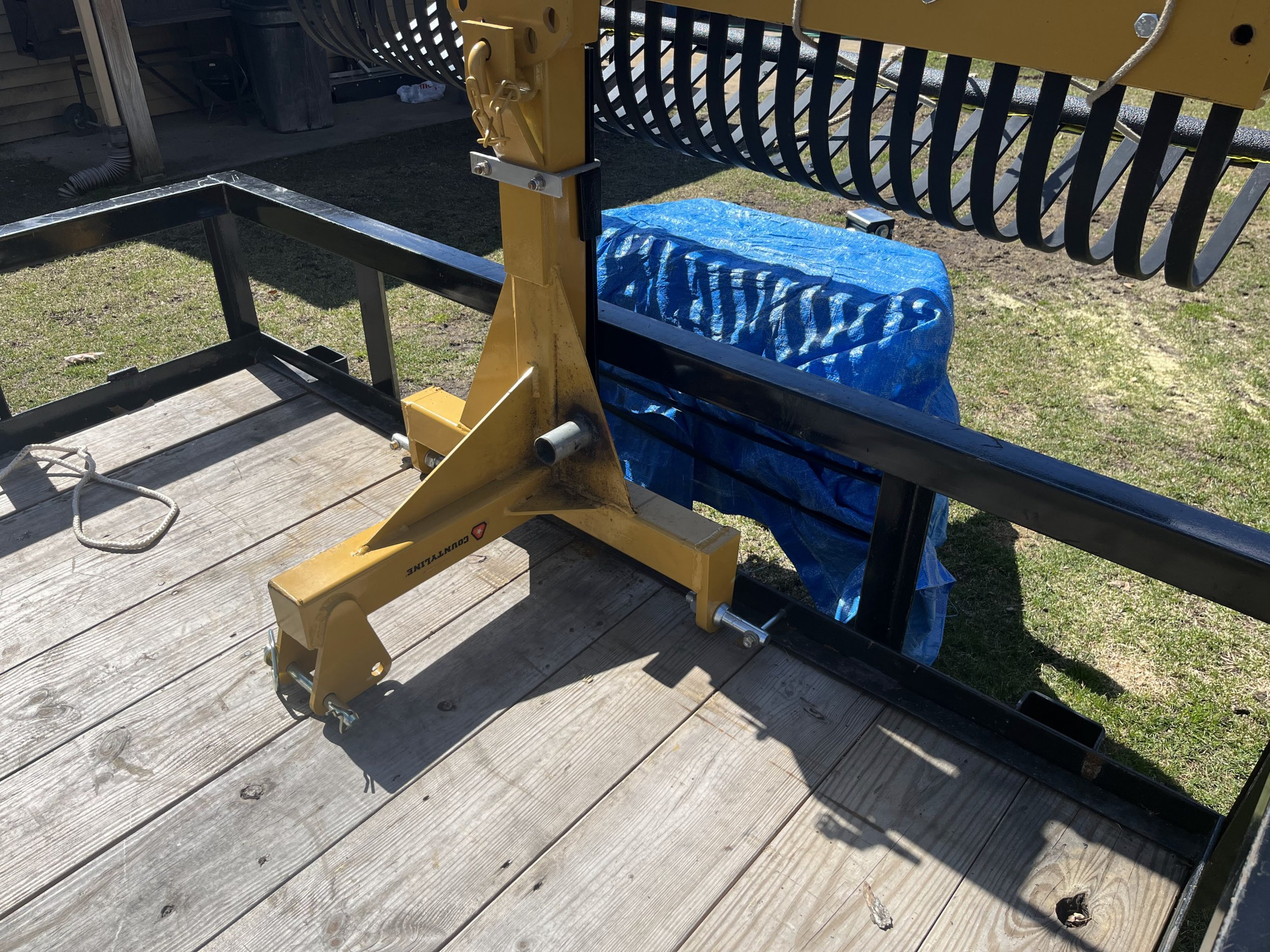

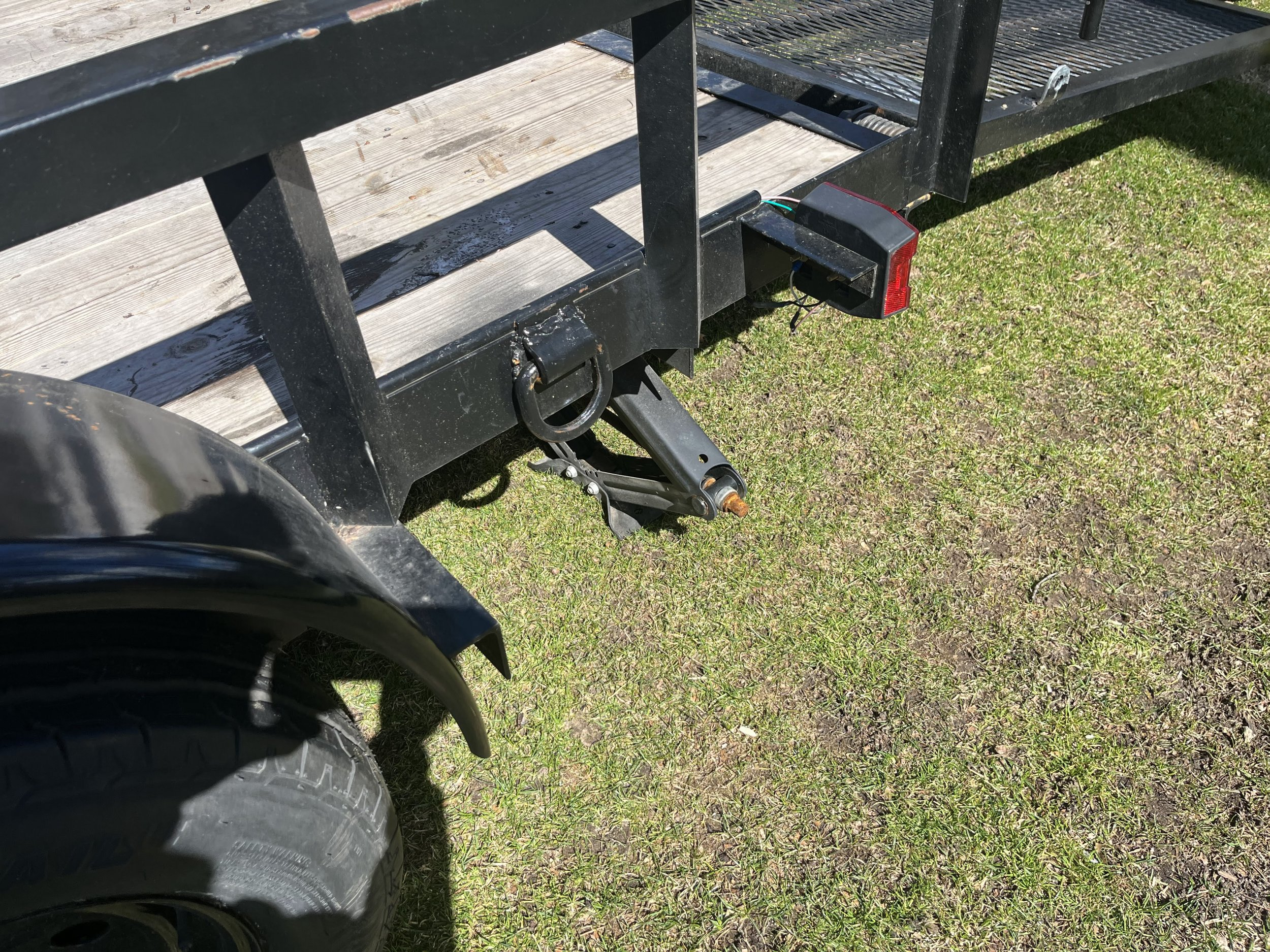

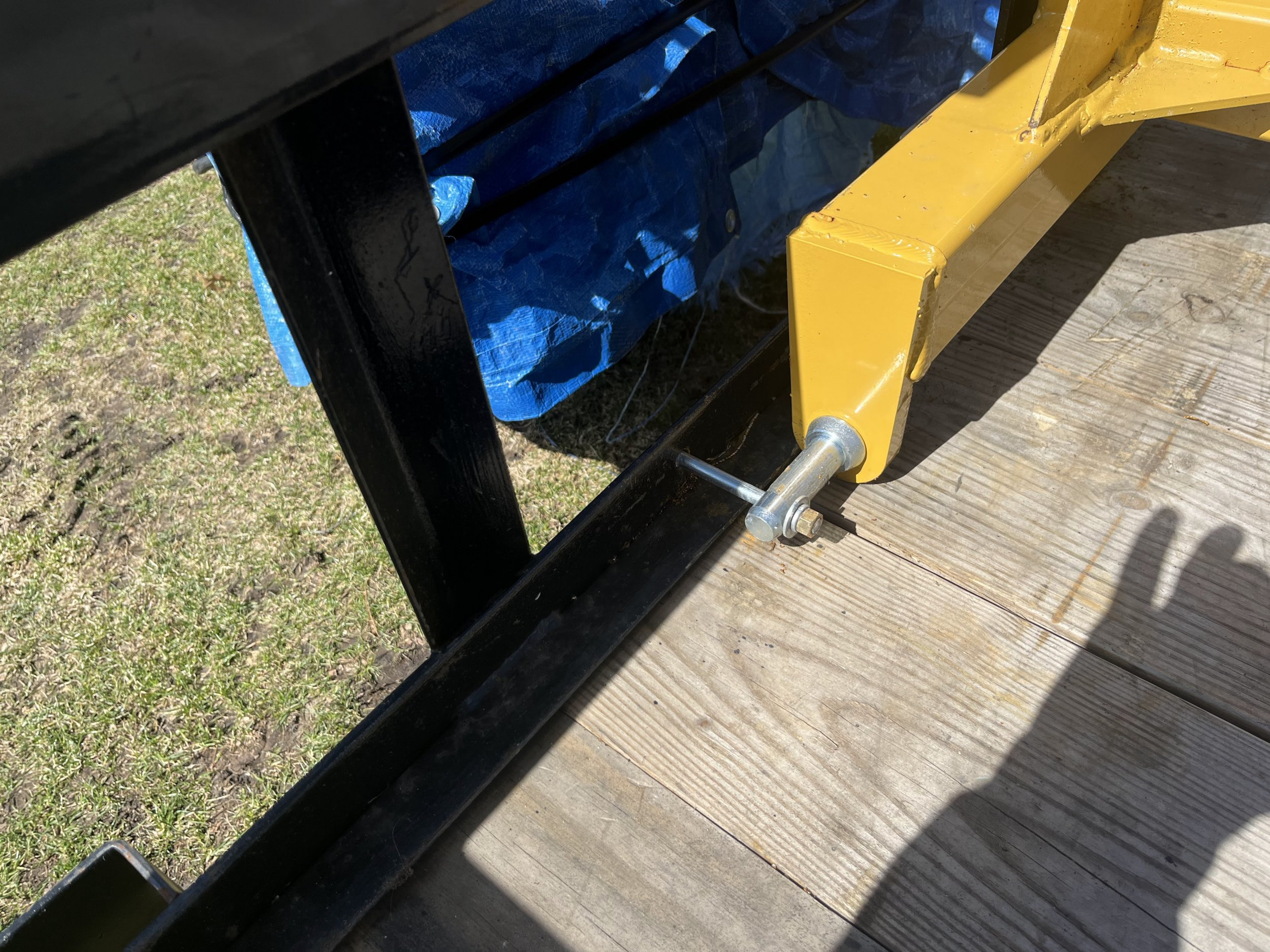

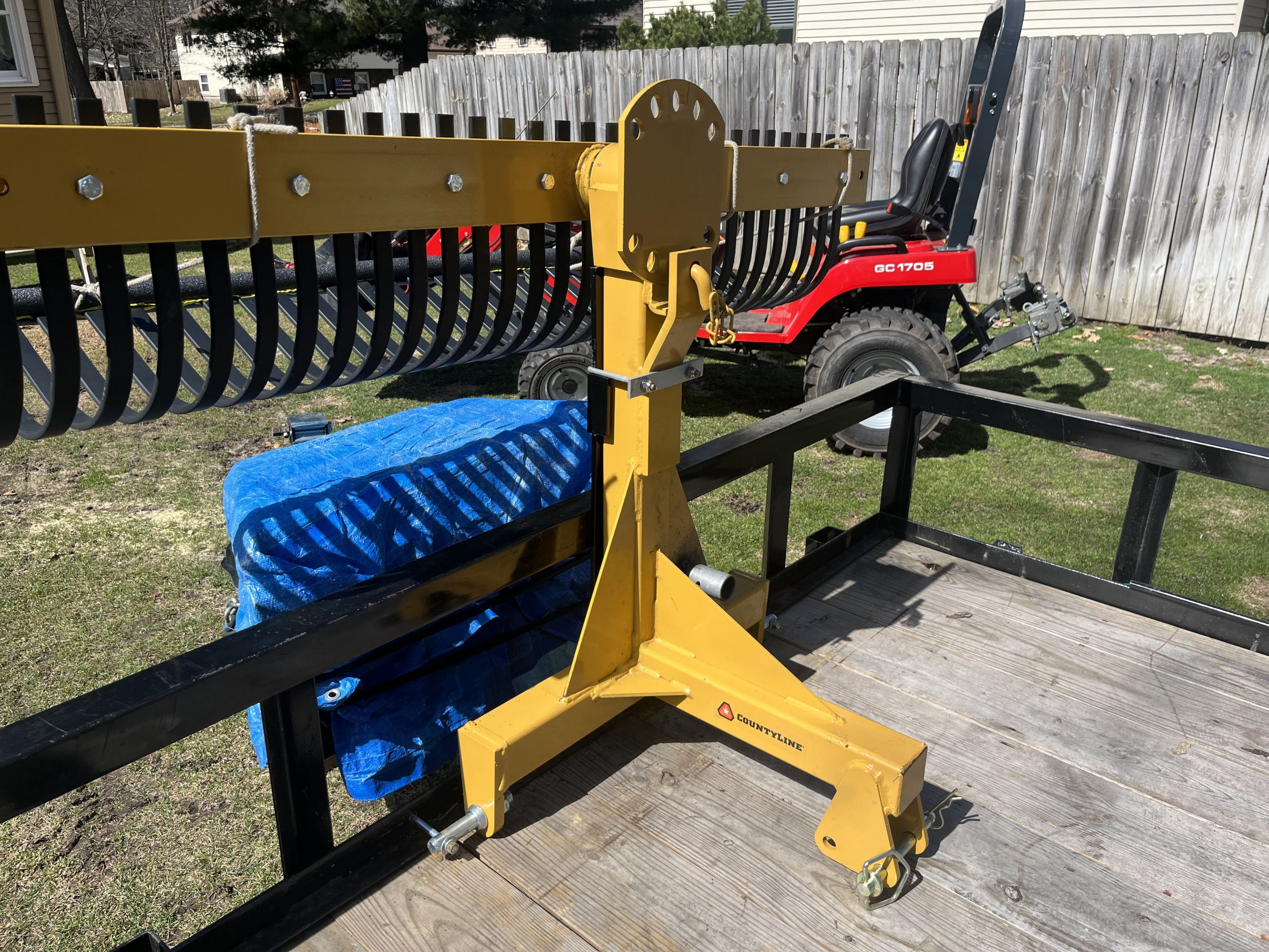

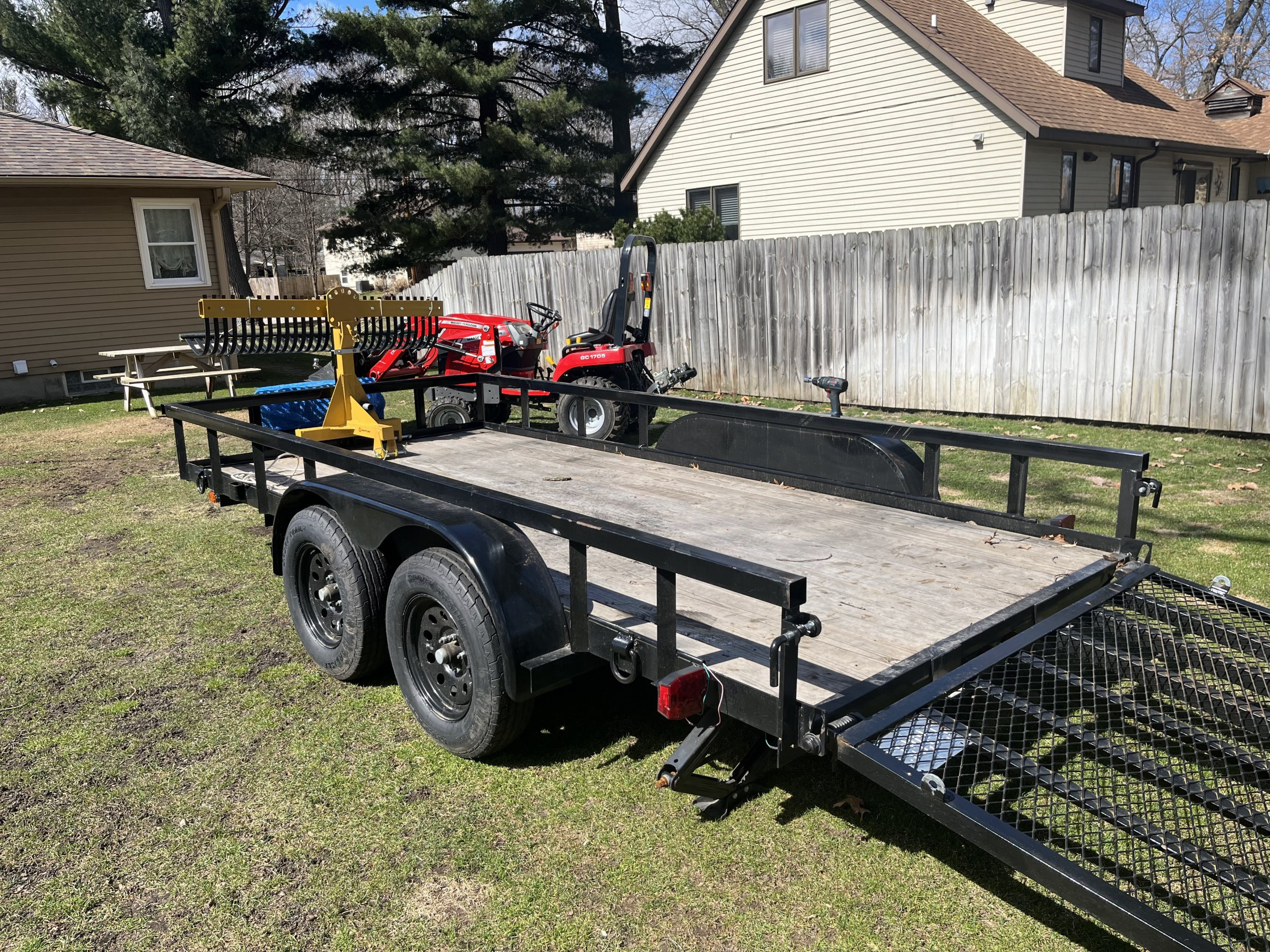

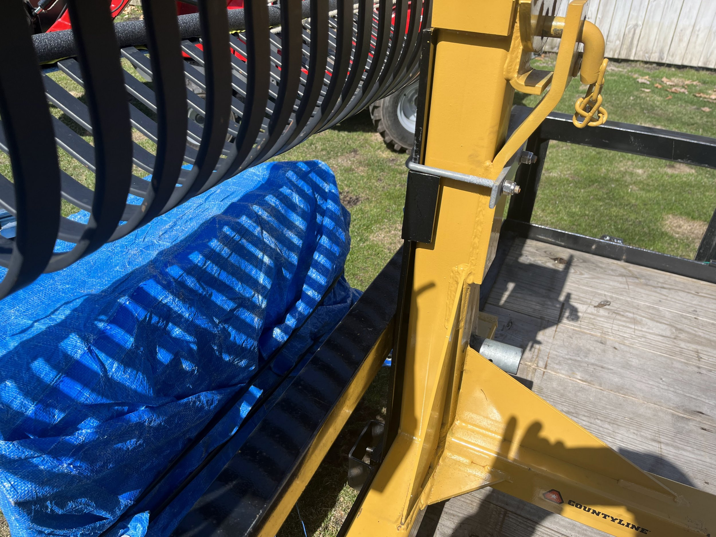

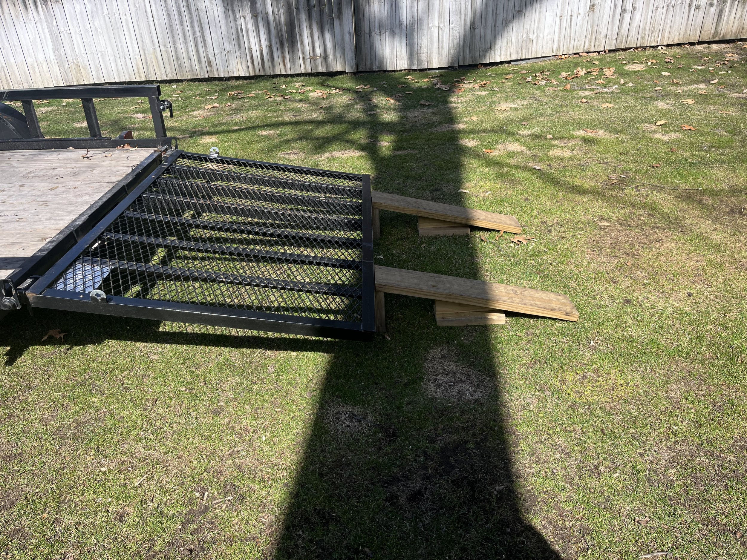

A 14' dual axle/brakes works for me. Not how I would like but I have done a few things to help overcome its shortness. Fabricated a bracket to secure the landscape rake for travel. Replaced the jack handle with a nut assembly that I can run up and down with drill as well as the rear jack stands. Tailgate is too short so I added 2' ramps so now the tiller doesnt drag when loading
