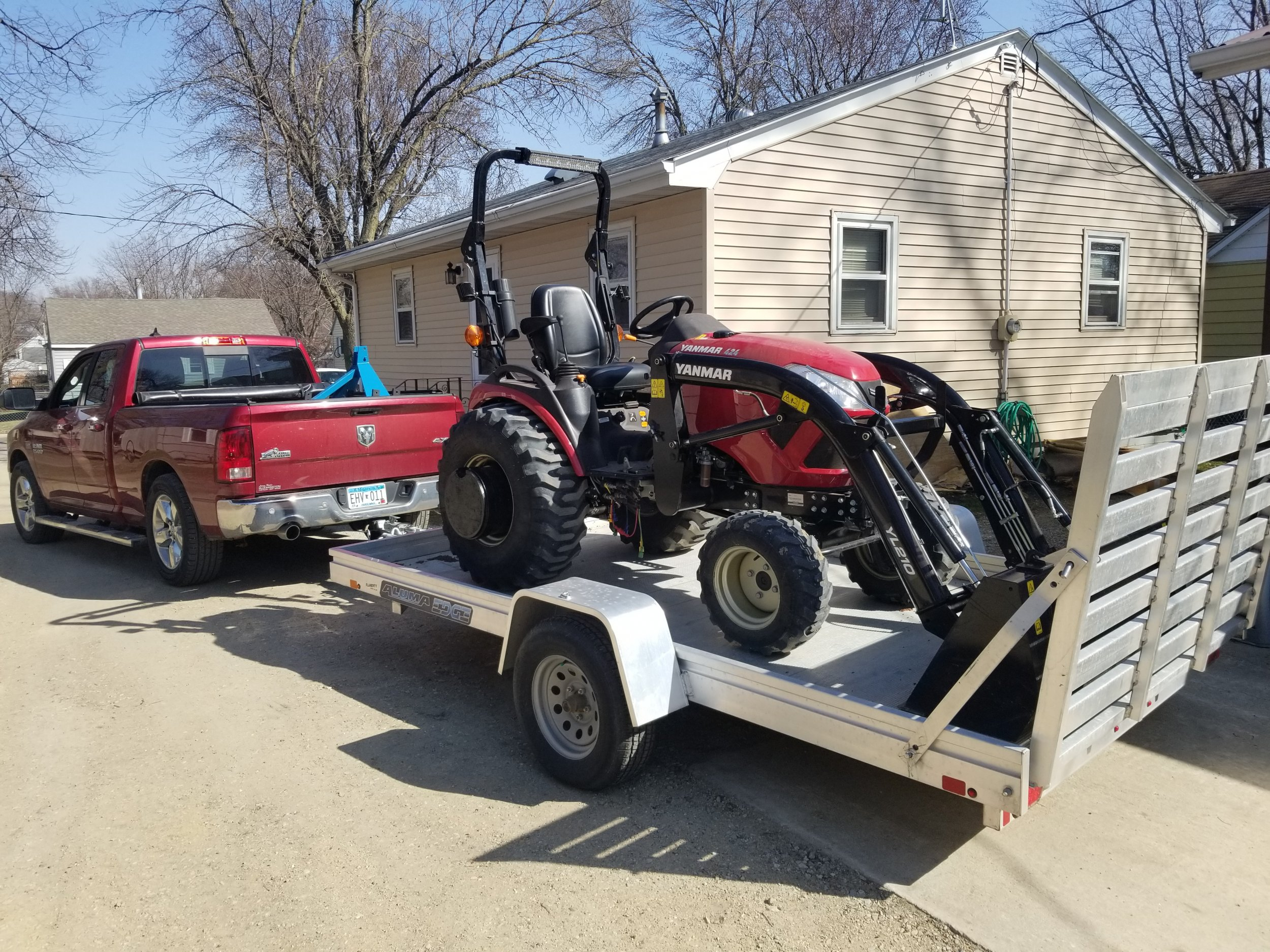

Here is a picture of my Yanmar 424 on a 12' trailer. I have to take the bucket off and run the loader arms into the bucket to make it fit, so I highly doubt you could put a bigger tractor on a 12' trailer unless you overhang somewhere. A CK3510 shows the tractor itself at around 10' long, while my 424 is only 8'9".

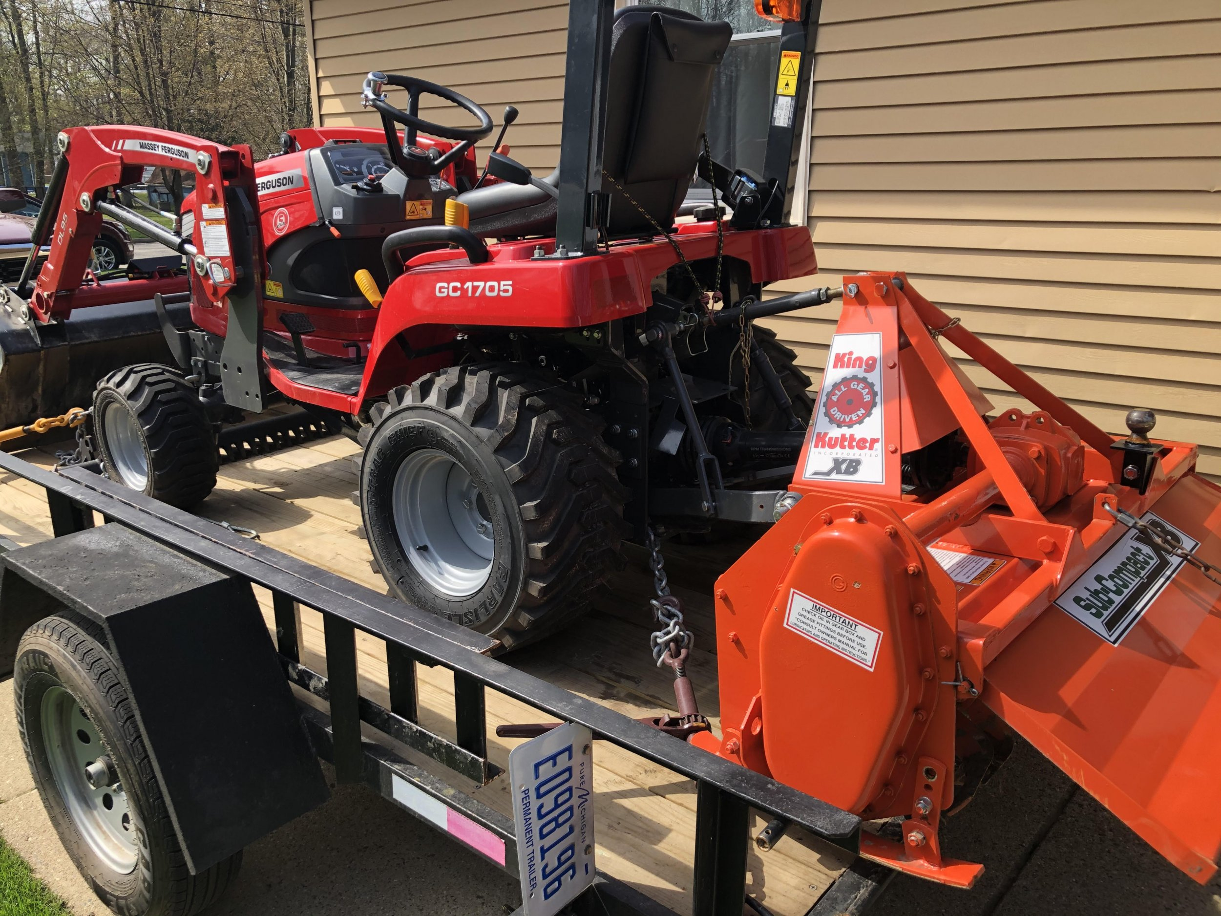

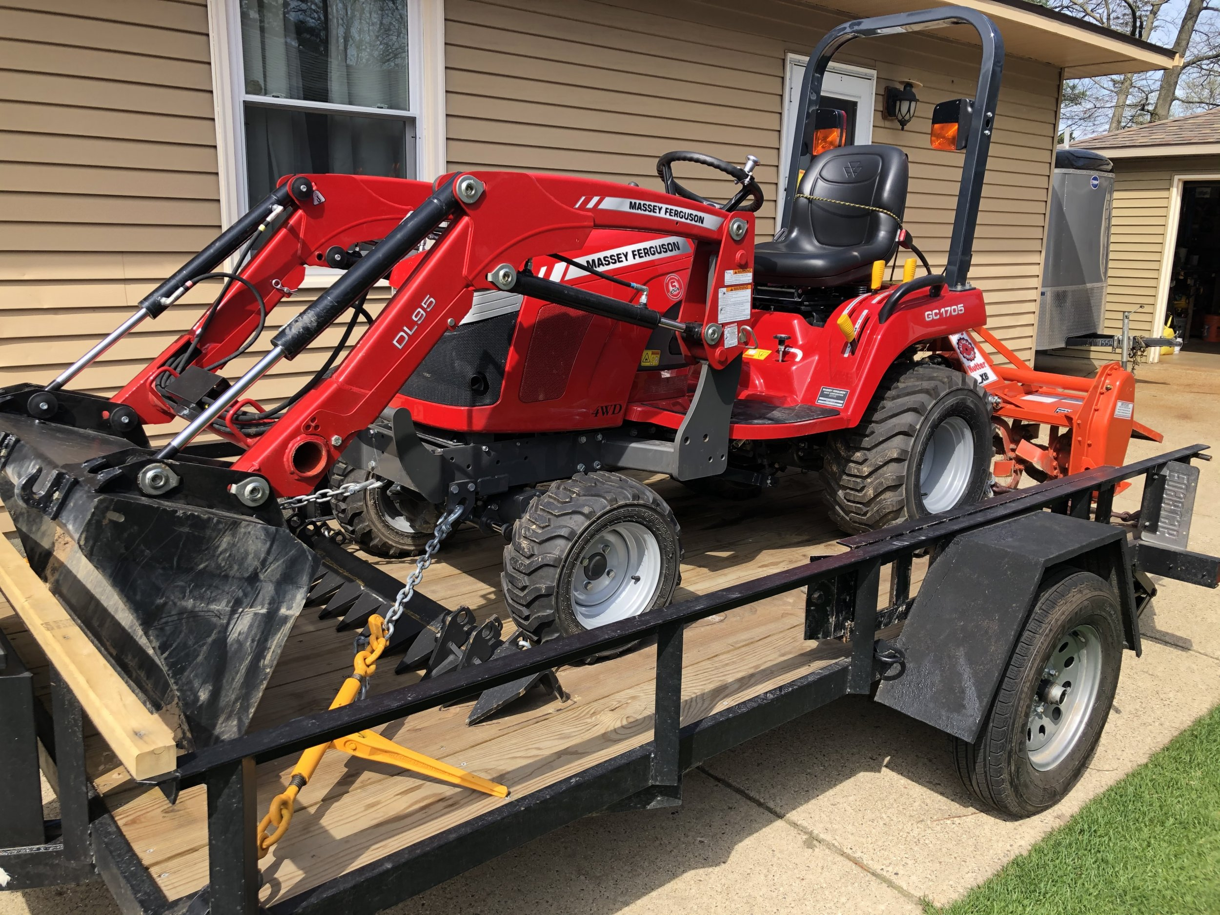

Built this at 12” but I immediately regretted not going dual and 14’

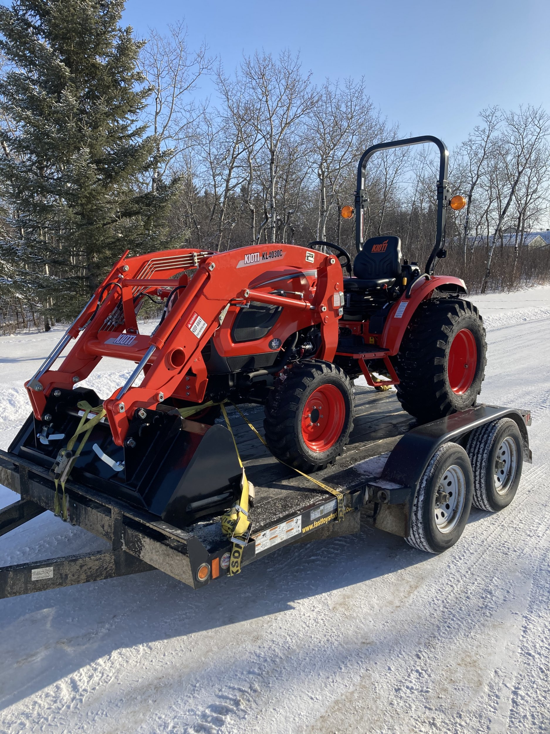

Here is my ck2610 on a 12ft trailer. It was extremely tight but balancing seemed ok with loaded tires
