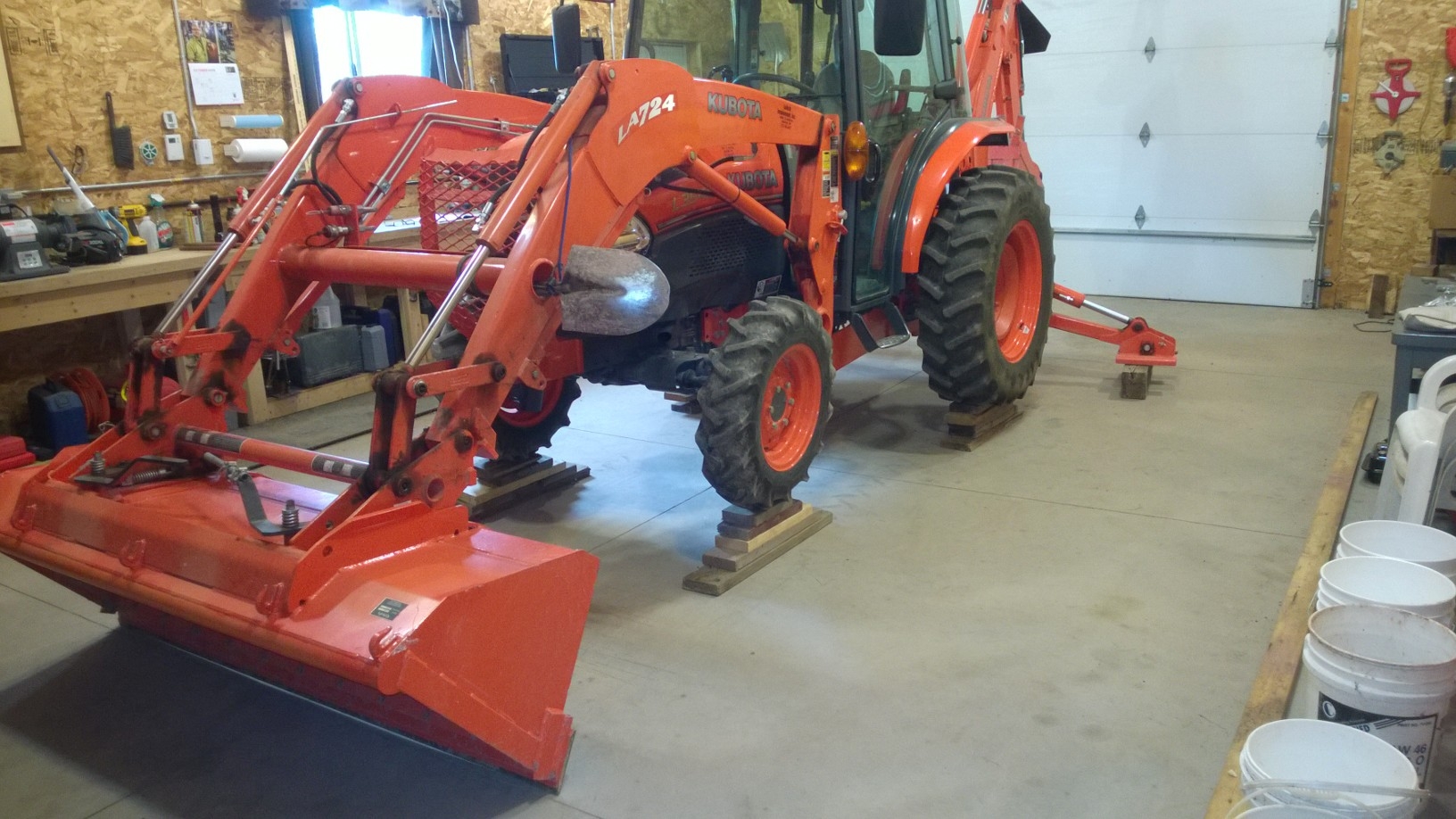

When I change engine oil I just put a couple of drain pans under the engine to drain both sides of oil pan and filter.
When I change my hydraulic oil I have 4 ramps made from 2x6. My tractor isn't high enough to put 5 gal pails under it. I have 3 drain plugs, I drain the back two first and get about 1 1/2 gals each, then I drain the front one and get almost 5 gals. Total is 11 or more, so almost 3 gals remains. I've done this twice now and will do it again this spring.
