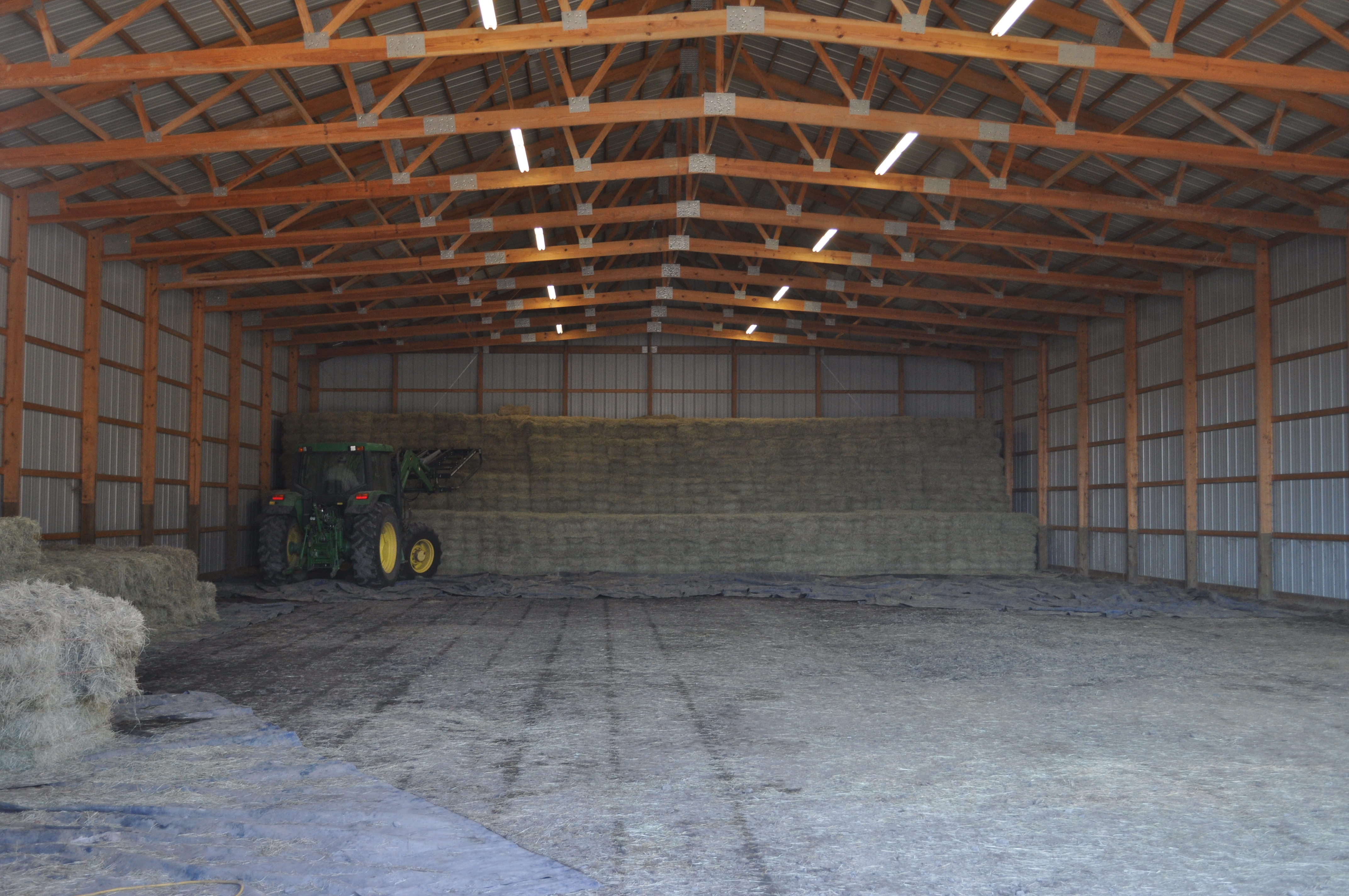

Seeking collective wisdom on how much working space is desirable/necessary around a tractor-loader-backhoe parked in a building. The overall length from the tips of the FEL tooth bar to the backhoe bucket in travel position is 20'08". With the dipperstick in and boom lowered so the curled bucket is on the ground or with the dipperstick vertical the length over all is approx. 23'08". While I am sure more room is nicer, would 30' from front to rear allow comfortable pass-by and working space? The width of the tractor is 6'00", widest implement likely 8'00", should bay be wider than 14'?

When this guy gets all the hay out, he will have barely enough room to work on his tractor.

Bruce's pic of the hay storage shed looks just about right. My tractor sits in a LARGE carport with three enclosed sides. There is at least five feet around the tractor on the three enclosed sides. This is OK if I'm checking engine oil level or to top up the fuel tank. If I'm going to get serious and bust knuckles and get grease on my elbows - the tractor comes out and sits in the middle of my lawn.
