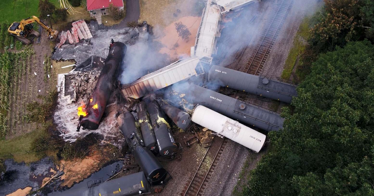

Interesting article. They say one problem with trains 1~2.5 miles long is when braking, light empty cars up front get shoved off of curves if most of the weight is in the final third of the train.
The final part of the article has several examples.
   / Working rail roads and their tracks. #2,700
What, they never took a physics class?
