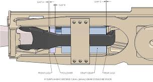

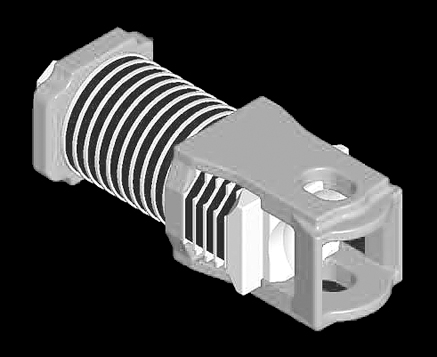

In case anyone cares to see what a draft gear looks like. These take the shock of braking cars.
or
