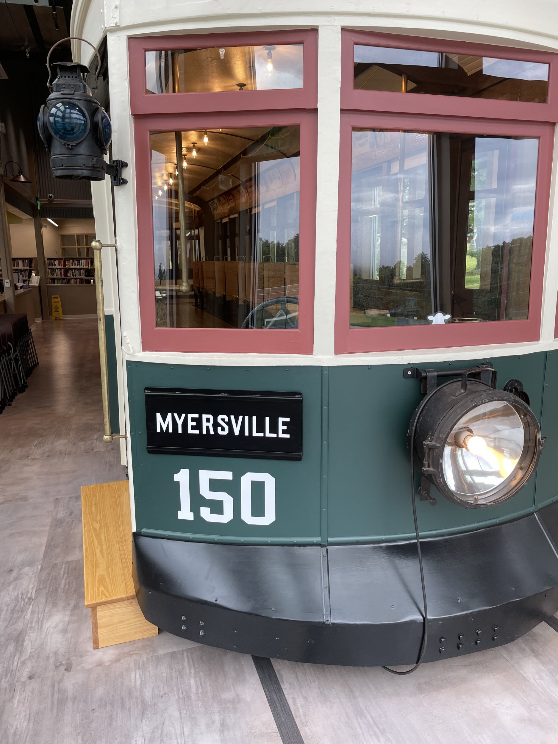

This trolley used to travel over our farm before it was divided. It is running between Frederick and Hagerstown MD

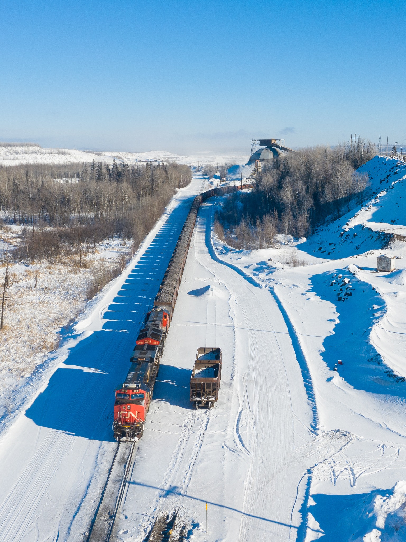

A recent photo taken in the ironrange of MN.
A pair of GEVO's are on the point of a raw ore shuttle as it crawls forward, loading the last cars of the train through the dumper at the Thunderbird Mine in Eveleth, Minnesota. Once loading is complete, the crew will tone up dispatch for a light down the Missabe Sub to the Fairlane Taconite Plant. View attachment 793256
To get some perspective on the size of that mine VS the area around it google earth it and turn on 3D. Amazing holes out there.
