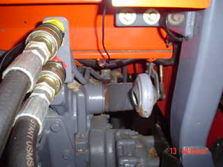

I have a 2008 CK35 HST with Woods backhoe. The dealer put on the round work light, the conection is located on the left side as you are looking forward. I have to take the seat off the backhoe to try and take a picture.
The picture does not make it real clear as to were it is. Will try to get a better one tomorrow.

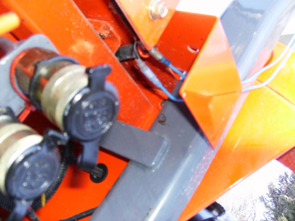

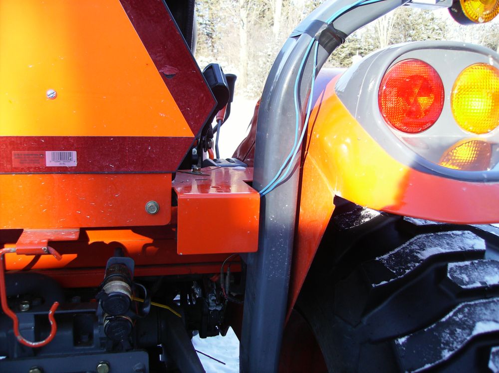

Took a couple more pics of my lights on the 2008 CK35 today. Not sure were you have mounted your switches, I put my chrome plated toggle switches behind the tool box area behind the seat. One is in the middle back of the tool box and the other is to the right of the tool box.

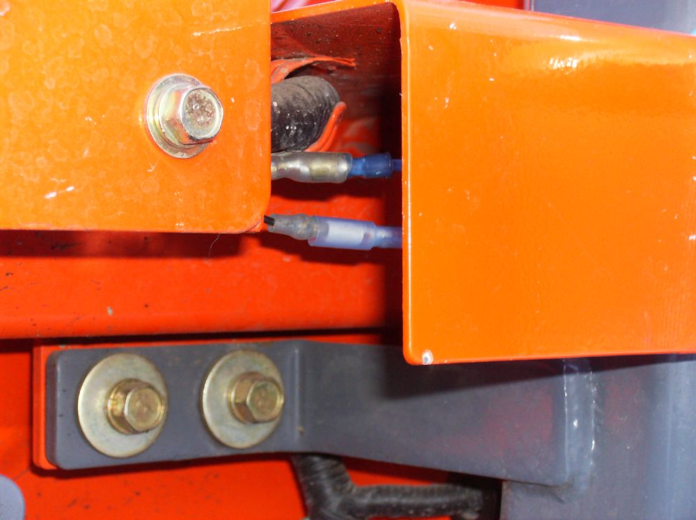

This site seems to only let you post 4 pictures at a time so will post 4 more now.

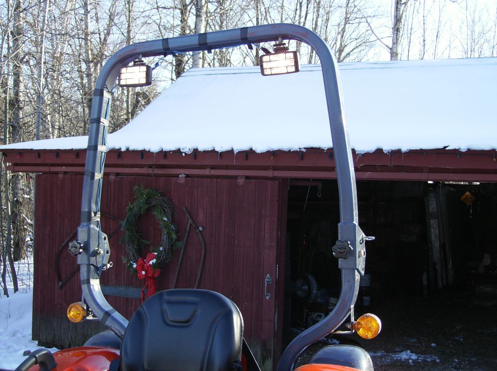

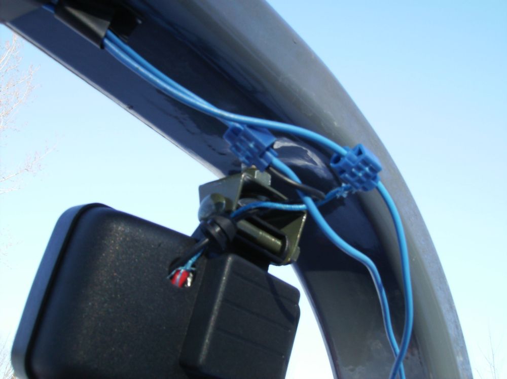

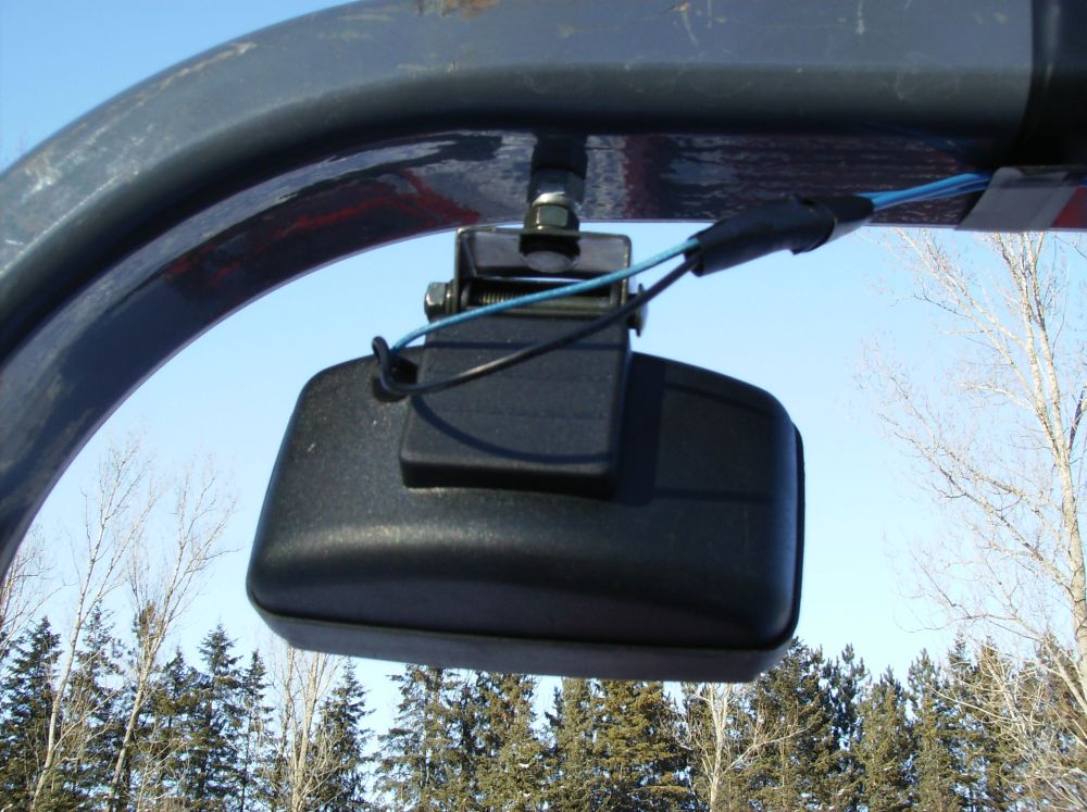

I finally got a couple of shots of the lights I installed. For now I only have two lights, which can face either way, and they are on one switch. I used magnets from Harbor Freight to hold a metal strip to which the lights are attached. One shot shows the switch and where I plugged in to the customer use line.

Yes they are small but give out tons of light. I have two more but will wait a bit to install them, to get a better idea of what I need. I believe they are the car drive lights that are normally mounted near bumper.
