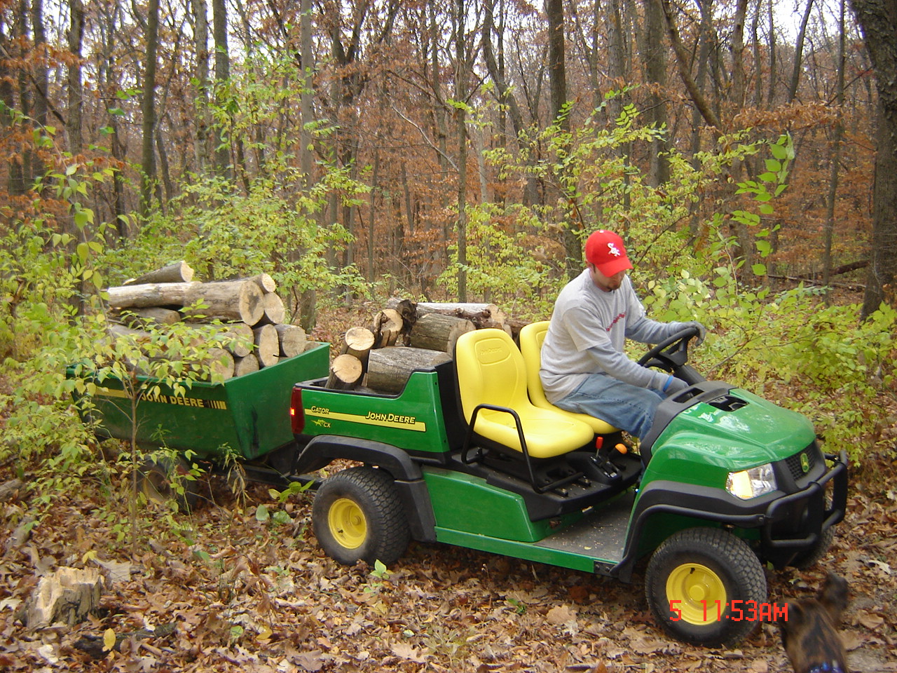

You should like the Gator. We have the small compact Gator CX. It will be 11 years old this year and has 1,800+ hours on it, Does what we need and has never needed anything but a set of tires.
