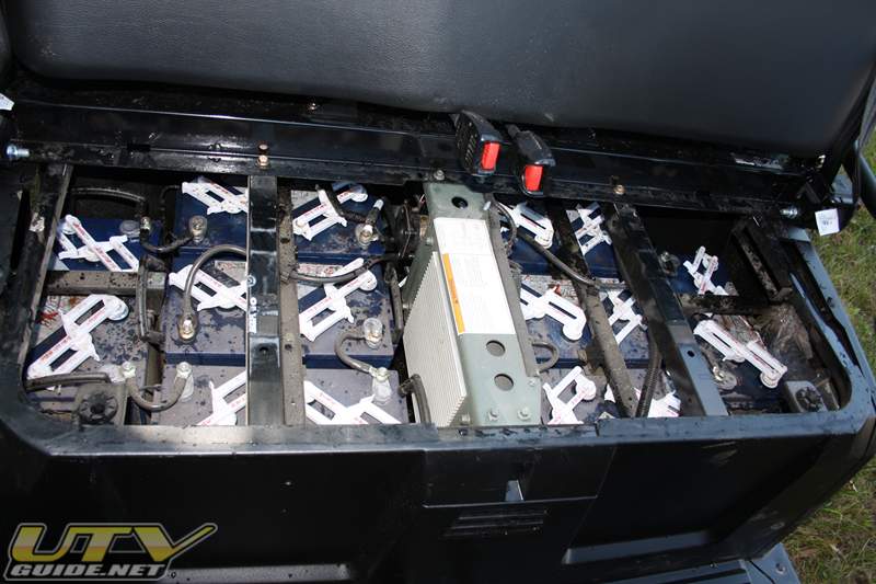

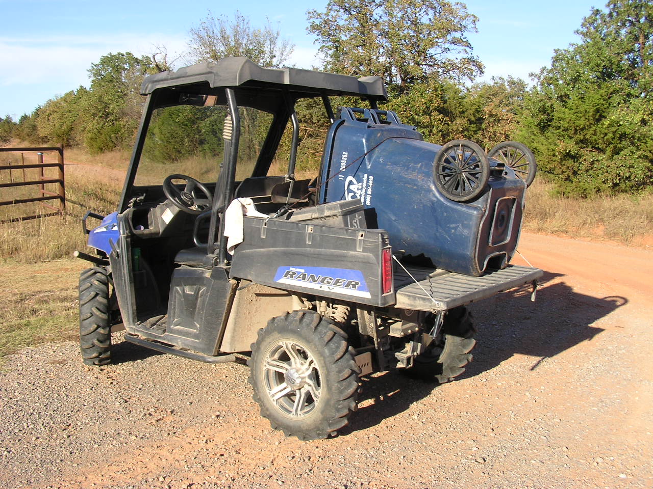

Guess I should tell "The Rest Of The Story". :D
Wife didn't like the noisy diesel, so traded it in on the Polaris EV two years ago.
Eight 12 volt deep cycle batteries and a Sevcon 650 amp motor controller under the seat.

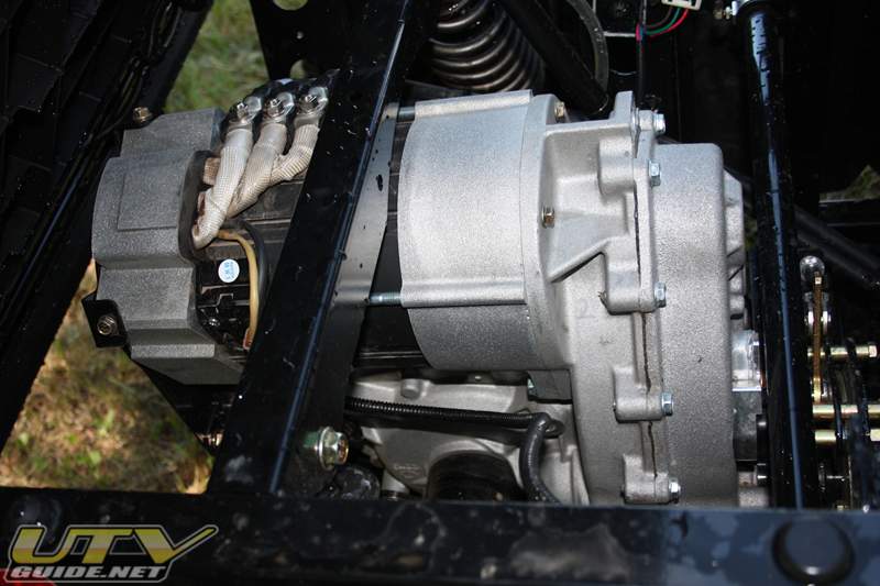

30 horsepower three phase AC motor, over the rear axle.

How long does a charge last? It depends on speed and terrain. The Max Range position is 15 mph and supposed to give 25 miles.
How long does a charge take? 12 hours with the factory charge algorithm, longer if changed to one that doesn't boil the batteries as much.
top speed? 25 mph.
How much grunt compared to diesel? Much more, due to max torque off the line. :thumbsup:
Honestly...electric vehicles are starting to come of age. Torque same at 1 rpm or many rpm...but the charge lasting.
Yep, I will probably go to lithium ion batteries next.
