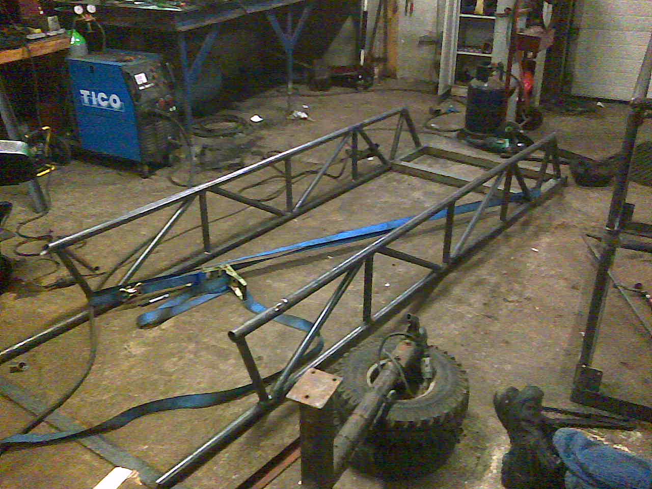

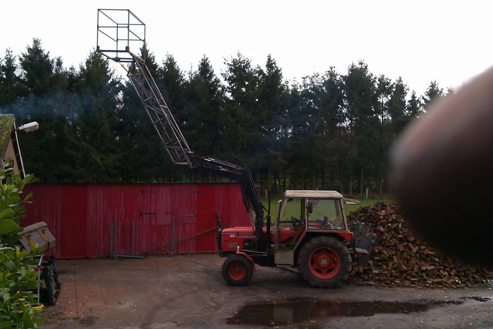

It’s got nothing to do with not wanting to do things ourselves. It’s simply a horribly designed contraption. It’s actually designed in such a way that it WILL fail if used with much regularity. It’s not even a question. If it wasn’t built in such a way that it’s constantly trying to tear itself apart due to simple gravity, no one would have said much.

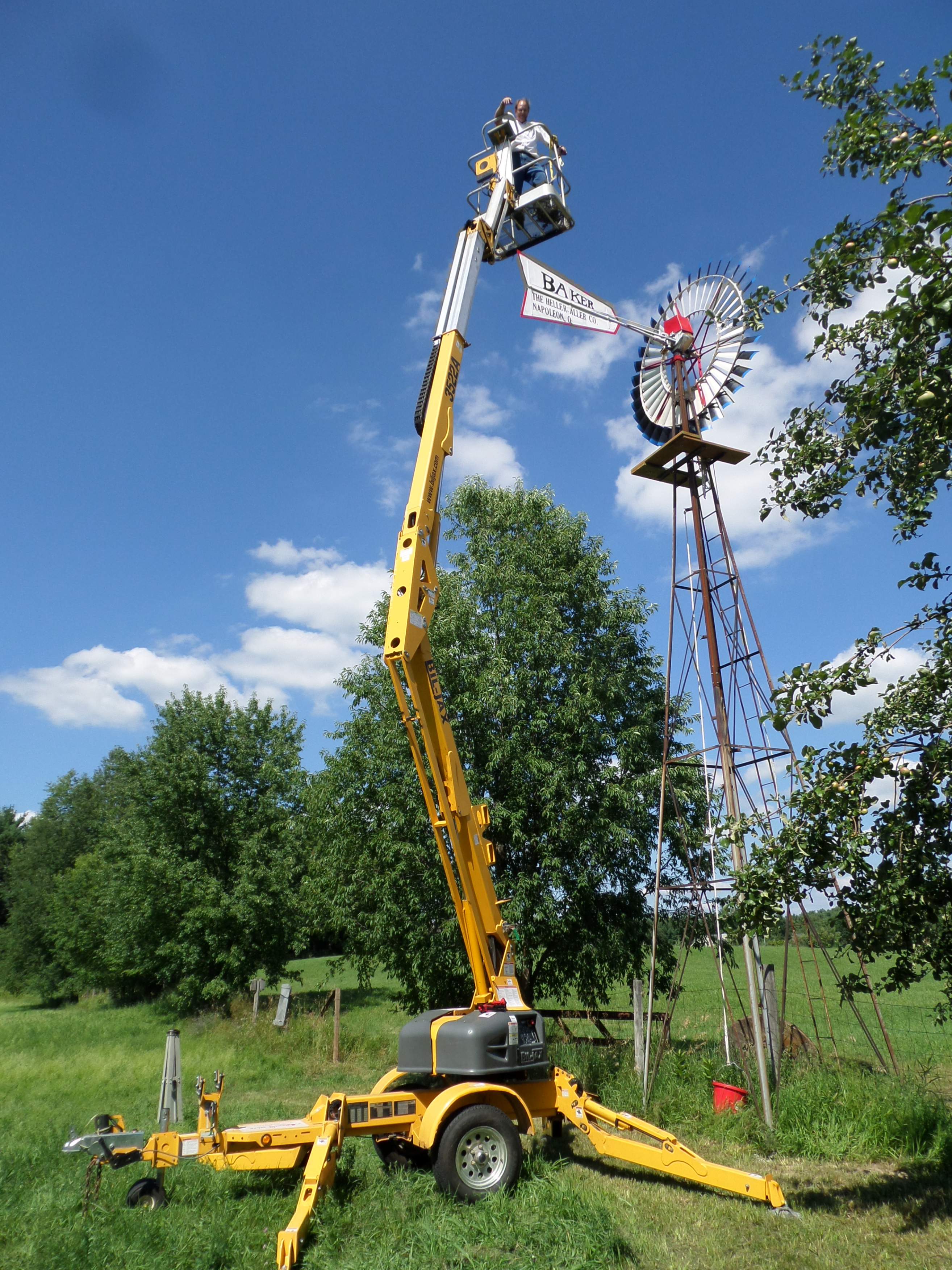

On my JLG, there is a tap into the hydraulic lift line which feeds the work platform pitch angle. The pitch cylinder is sized such that a horizontal work platform position is maintained no matter what the elevation. Mine also has a yaw angle rotator so that I can square up the platform angle with the wall of a building or sneak around a limb as necessary.
As long as you are comfortable with your lift, one or both of these features could be added. I'd also suggest adding some baseboards aound the base of the platform. Sometimes you have tools and cans of gas/oil/paint, etc. that you don't want to roll overboard.

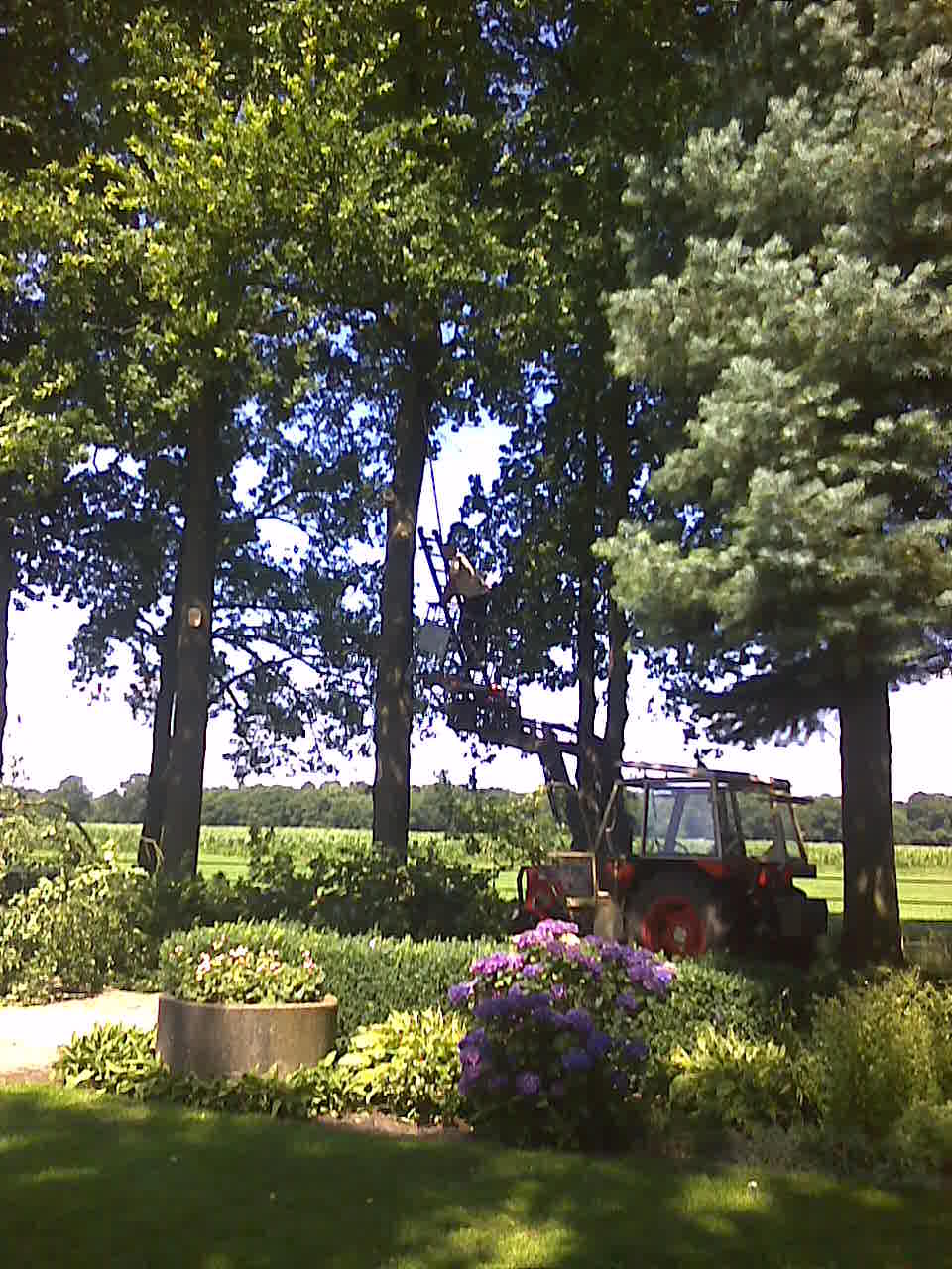

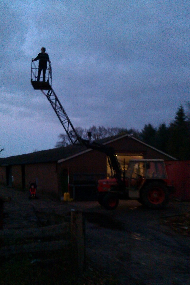

Yes, we did add a baseboard just above the floor. I needed that when my brother leaned me out of reach and the relief valve blew over, dropping me down 3 meters at a velocity that gave me time to stop the chainsaw, put it behind the baseboard and hold on to the rail. Unless you try to reach too far by putting the boom horizontal, being in the bucket with the boom 60 degrees up, while driving, the boom lift feels more secure than the commercial lifts i have used professionally, because the construction is stiffer (though more labour intensive to build) than commercial booms made of single rectangular tubing.
As said, hydraulically the critical point is at ground level with the boom flat on the ground, when the depth of fall is little (designed that way) Once upright it is very stable, especially with the tractor on duals for a wider stance.
