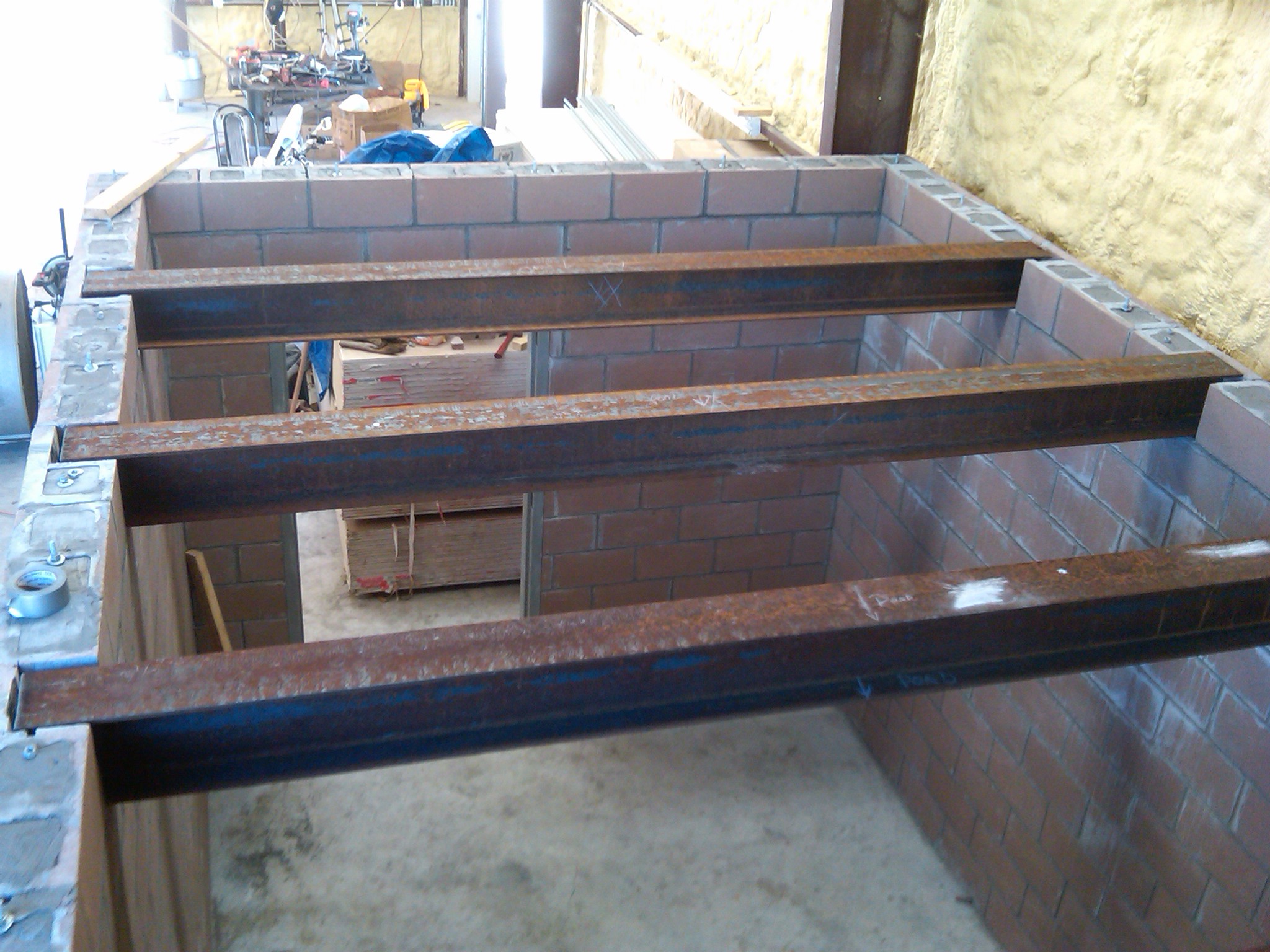

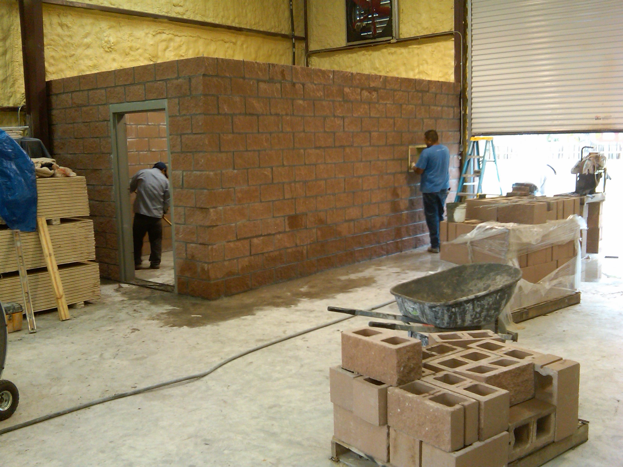

While thinking of ideas for a bathroom with shower for my new shop I figured why not make it a storm shelter/safe room beings we live on the Texas gulf coast and evacuating for a hurricane is not an option..

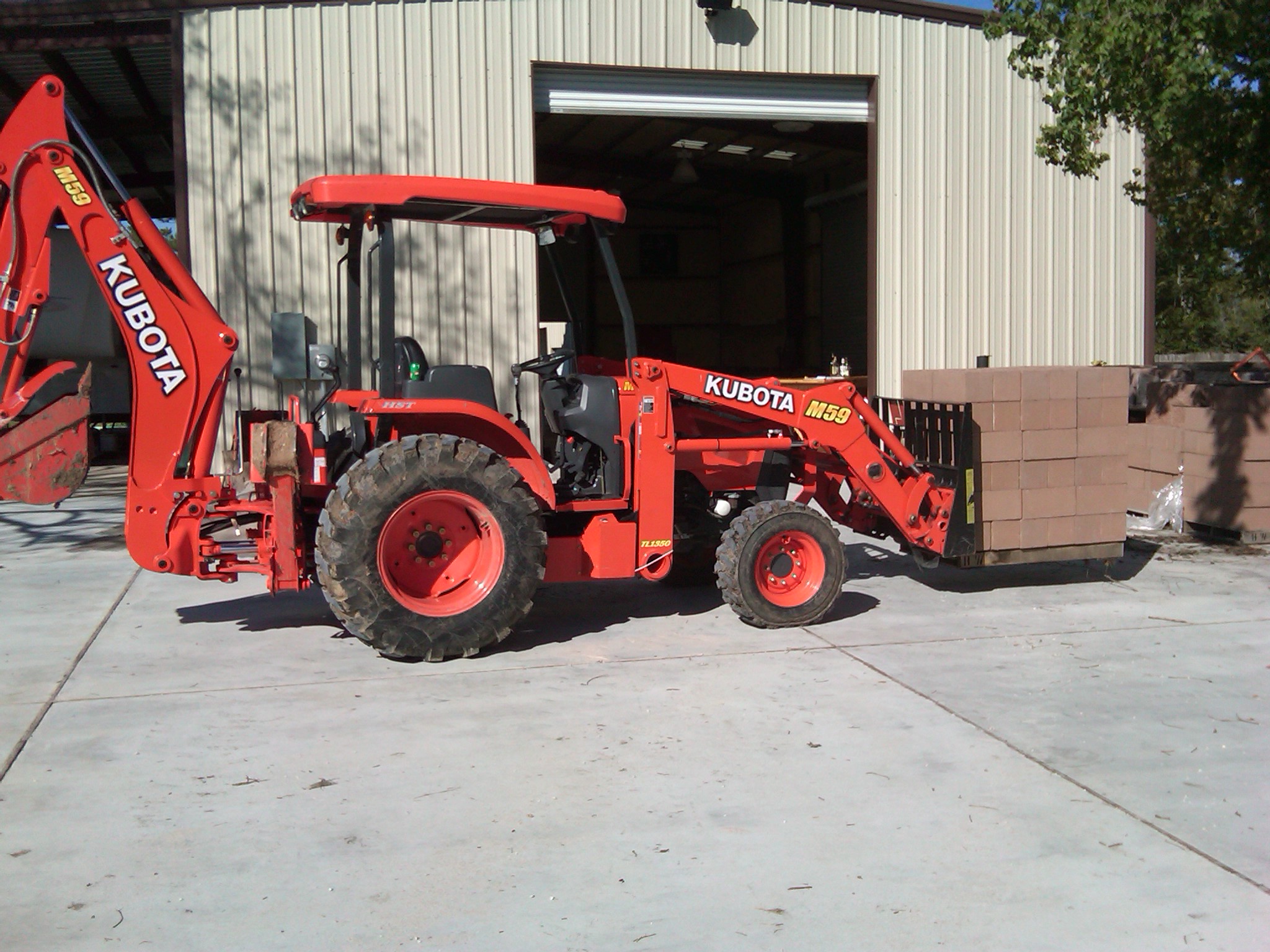

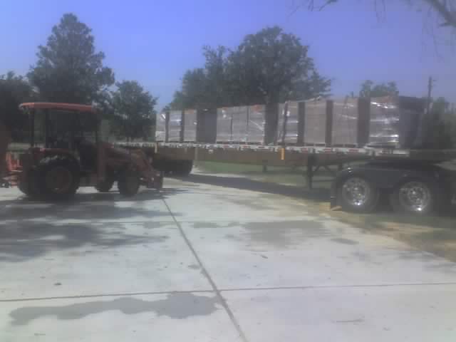

I considered solid concrete walls but that was too expensive. I am not a fan of cider blocks even when filled with mortar. I found industrial CMU split faced blocks that seemed much stronger than a cinder block and weighed in at ~37# each vs ~25# for same size cinder block on craigs list for 2.00 each. An online calculator helped me figure how many blocks needed.
I dont know how I would have unloaded the blocks off the truck if the M59 would not been able to, the truck did not come with a "spyder" forklift...
I did have a close call due to a low tire while lifting a pallet of blocks that almost caused me to ruin a pair of underware...:eek:

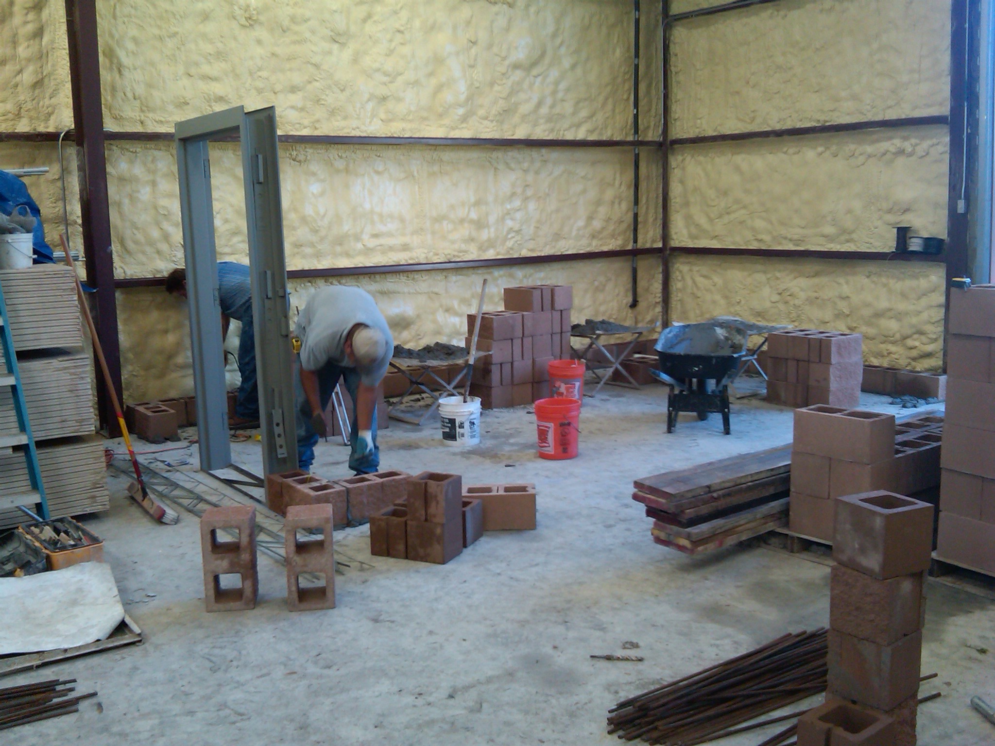

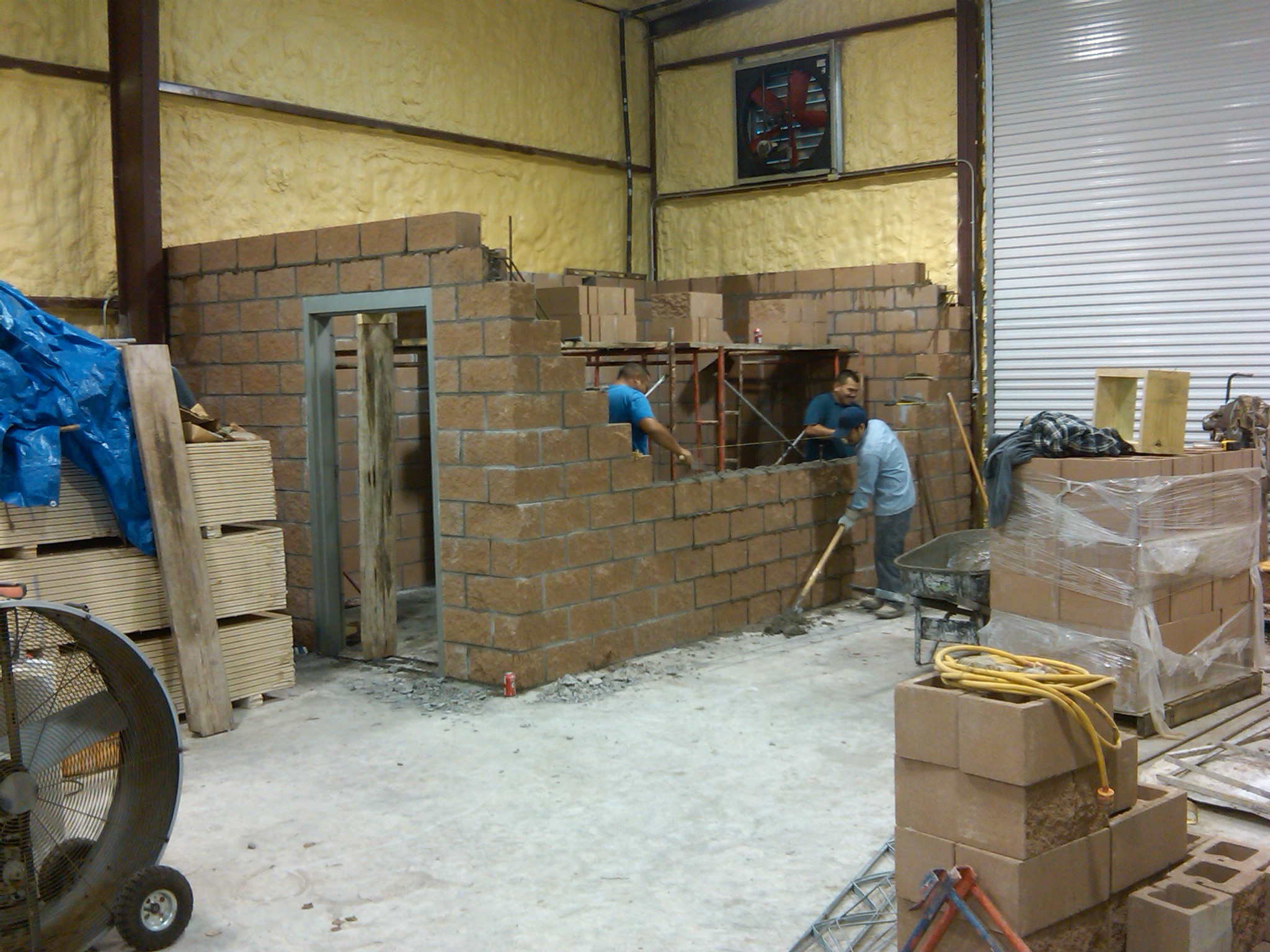

Watching the brick layers work was impressive.. I am very glad I did not attempt this myself.

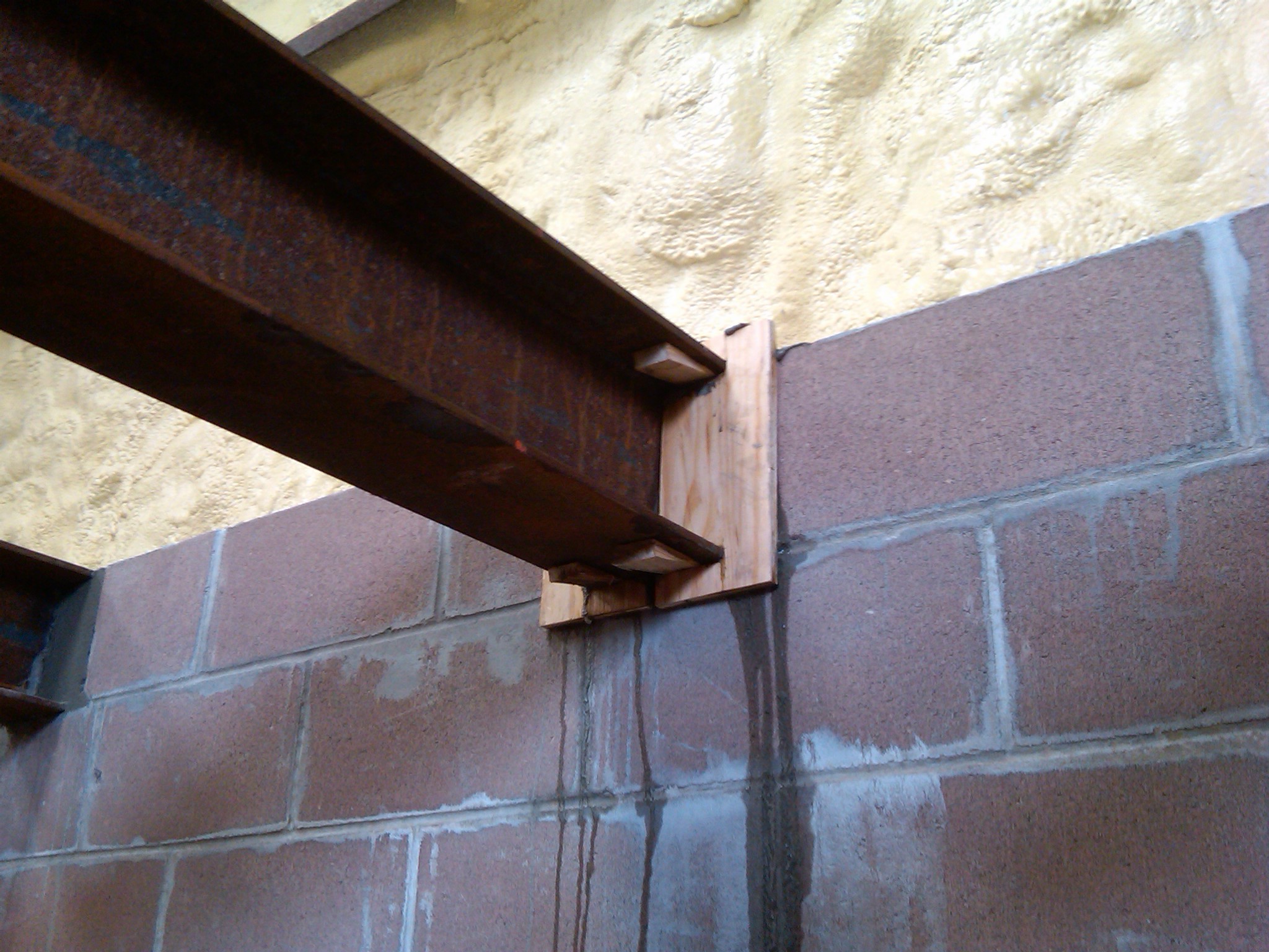

The idea I came up for the roof was pretty much over kill but the brick layers had no problem handling my request and set 4 8" long by 1/2" diam. J bolts for each beam. I got the 24# 8" I beams for fair price. I use the 8" so they would be even atop the wall for the upcoming .250" steel plate roof.
More pixs to come as progress allows... I wont attach the pictures of the make shift boom pole that we used to set the I beams in place for fear of being tar and feathered by the Saftey Police :)

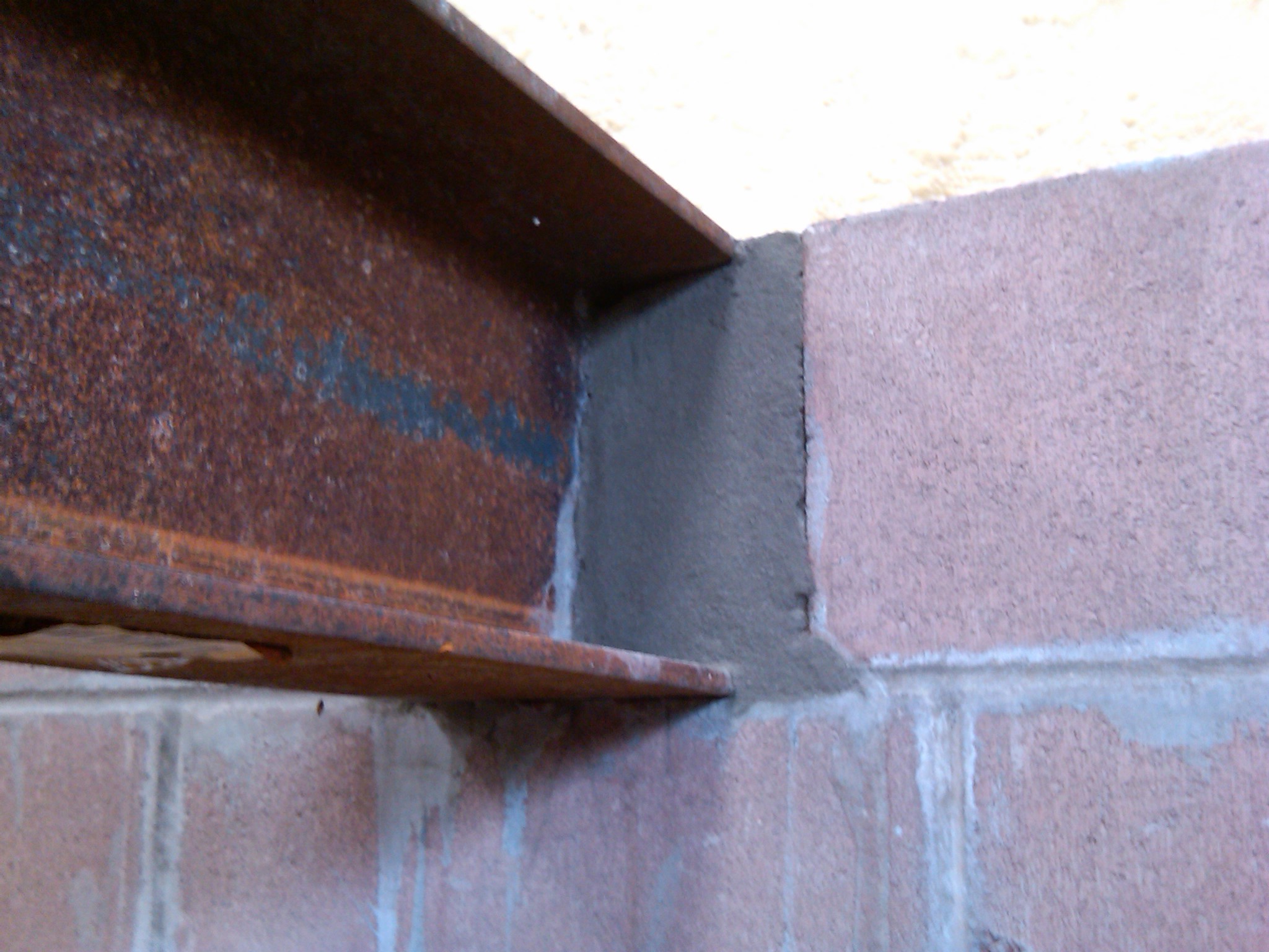

/ Work in progress, office/Storm shelter...
Managed to make a little progress to the office on my days off. While tightening the anchor bolts I was not pleased how easily a few of the galvenized j-bolts nuts stripped nor the look of void area.
We decided to grout them in for looks and added strength.

I like your idea and I second the reinforced concrete ceiling over your safe room. 1/4" plate is stout stuff for mere mortal humans; but I suspect hurricanes and tornadoes would just laugh at it.
I like the spray in insulation as that should insulate far better than batt fiberglass, and it sounds like your getting good advice to cover it with something to starve any potential fires of a fuel source.
Keep the pictures coming.
Thanks for the compliments and input. Unfortunately it seems I believed the sales pitch that the closed cell foam would stop burning if the flame source was removed. After reading that information I now have my doubts. I have quite a bit of 5/8 sheetrock in the shop I may look into using it in the shop instead of the up coming house.

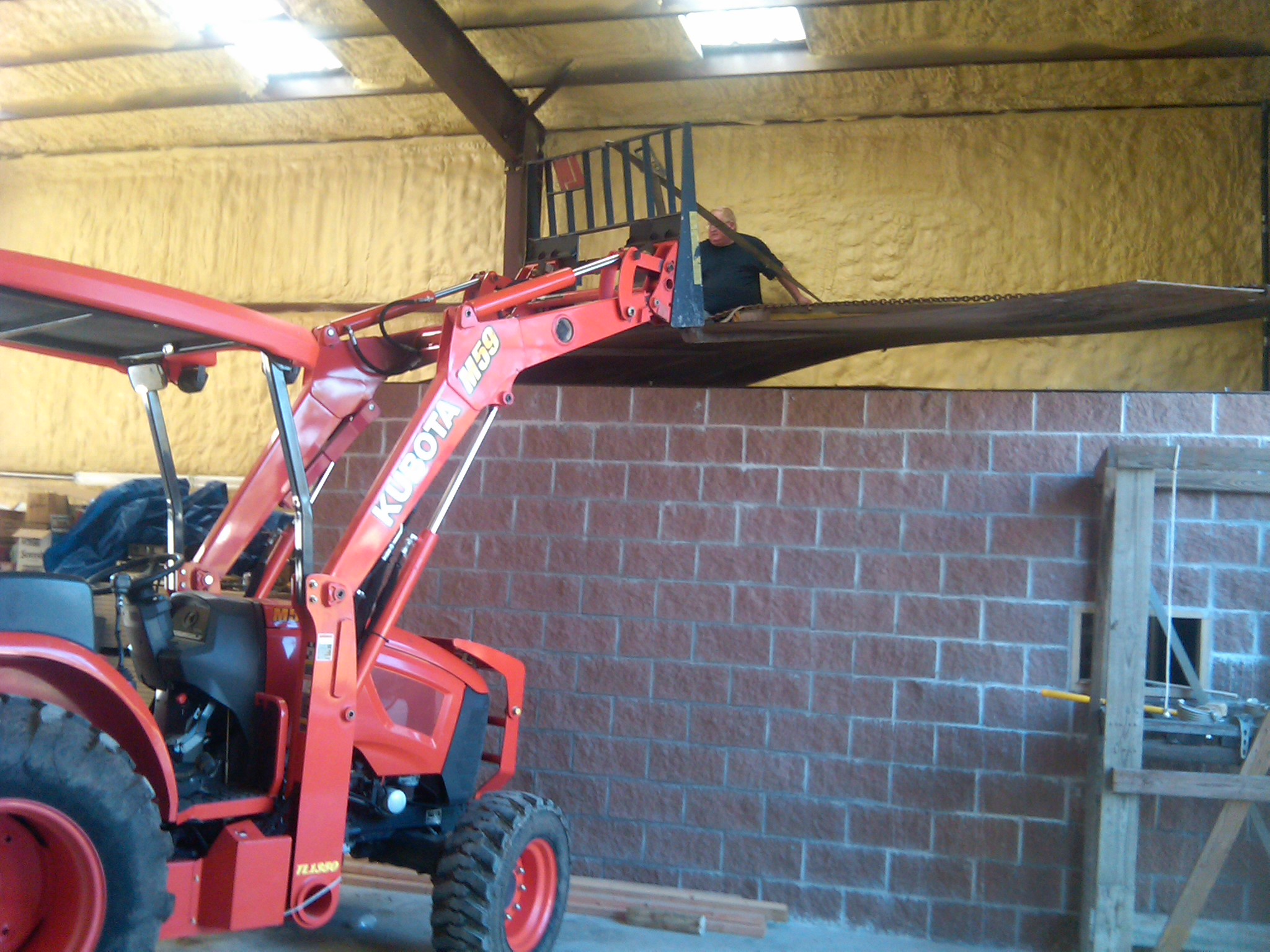

The concrete roof is an interesting idea but to be honest I am already over budget so bad on the shop project in general I am not sure if it will happen. I realize it would only take a couple of yards but I know from experience pump trucks are expensive. Although it is only シ plate the span between the beams is less than 5遅 11 I plan to weld some healthy tacks to the overhead beams. I have enough steel plate I may double it?mmmm
The door opening inward is how it was installed just for the reasons mentioned. Some folks pointed out it would be stronger opening out ward but my concern of it being block by some debris caused me to install it as it is. I do not recall the gauge of the door and frame. We started off with a normal industrial 3? wide door and decided to move up a couple gauges on both the frame and door.

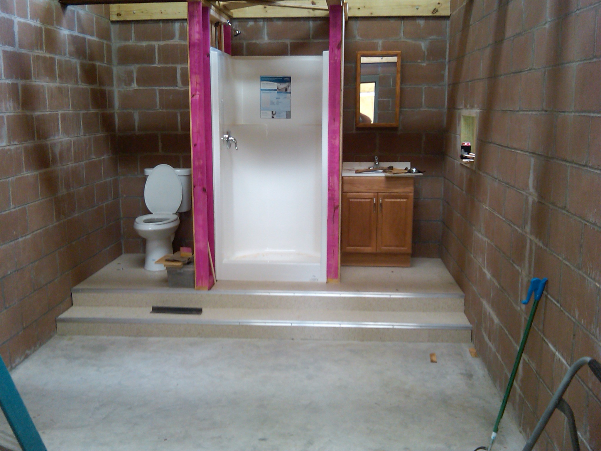

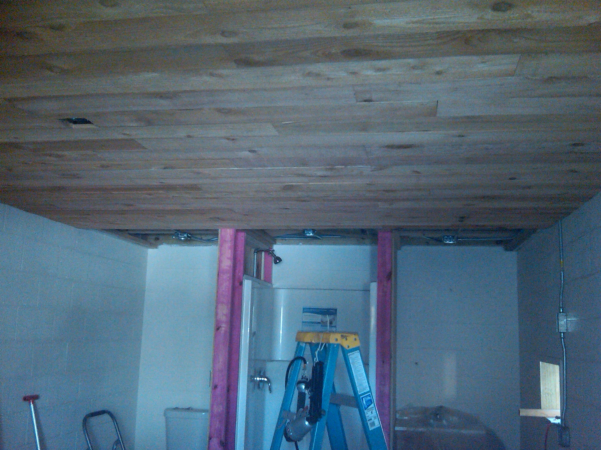

Had some health issues been gone a while from the forum.. Anyhow here is a few more pics for those who whrere interested in this project...
Although the plate was only 1/4" it is heavy and hard to manuvere
#17

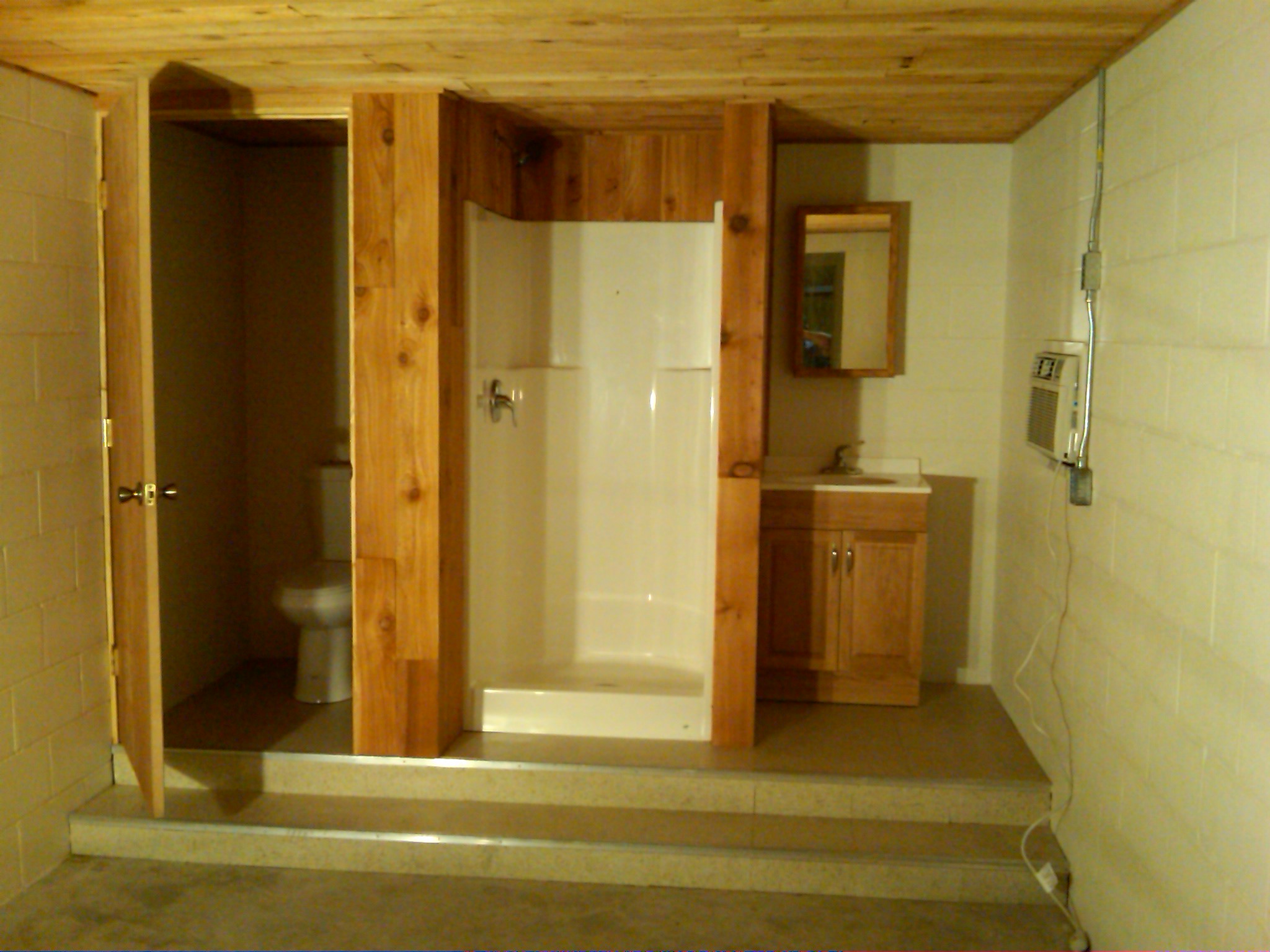

Wife wanted cedar but after pricing cedar 1x4" and 1x6" I went with cedar fence pickets and ripped some for trim.

Chuck, glad you are back, hope your health is back to normal (good) now. You've done a fine job with the shelter, that was using the ole noggin to kill two birds with one stone too! Have a couple questions though.... How did you secure the first course of blocks to the pad? Also, did you finish out the structure with a steel door?
#20
Thanks Kebo, prostrate cancer at 50 years old sucks but life goes on..
The brick layers used a hammer drill and set 5/8" rebar every 3' and epoxy them into the slab. They also used mortar between the floor and first course. In hind site I wished I would have had them needle gun the pad area under the first course to give the grout more to adhere to.
I had some extra rebar so a length of rebar was dropped in every hole then filled completely with mortar.
I forget the gauge but yes we finished it out with a commercial metal door. What ever the industry norm. was I went one gauge heavier for piece of mind.

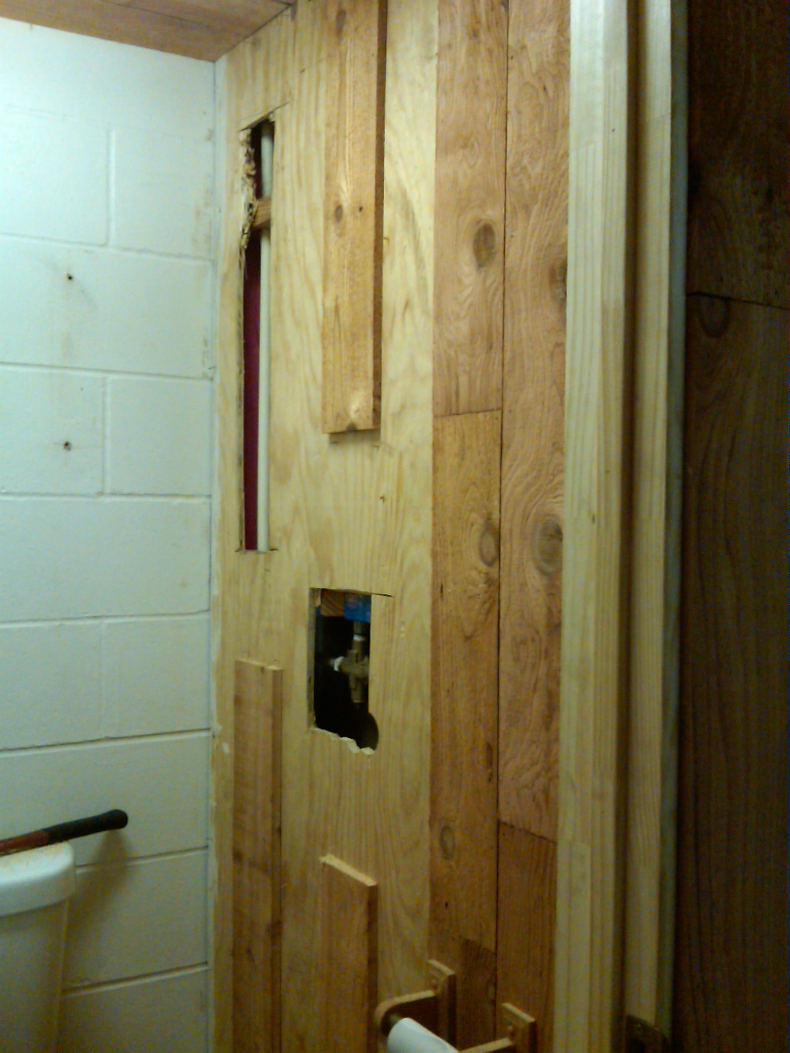

My luck never seems to change..
Finally got aroud to installing my hot water heater and plumbing it in, turned on the water only to have water running out from the deck....
The next problem was to try an figure out where the leak was..
I some how managed to center punch a hot water line with my nail gun :confused2:
Well maybe on my next days off I can get back on it and see what I screw up next :ashamed:...
