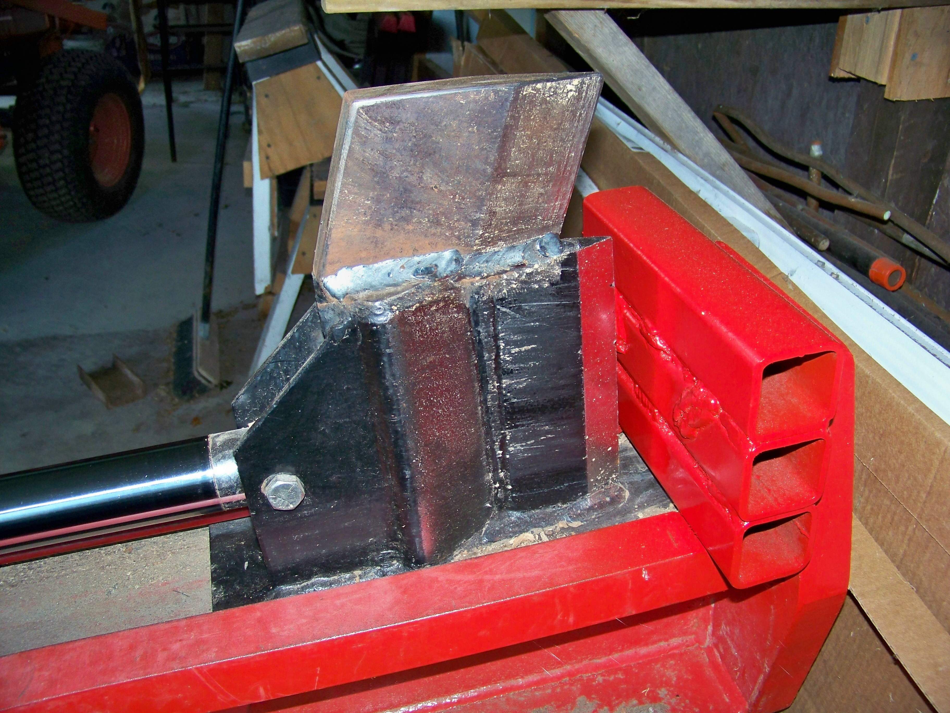

I have a 22 ton Huskee splitter. I woulkd like to add a few inches of height to the splitting wedge. Seems as though my trees are getting fatter and require me to take two hits to split. Anyone done this? sure would like some input. Called Huskee/Speeco with expected results......NOT! Thanks, smoker

This is kind of my Sons idea as he is the loader and I am the handle operator :). His idea was to weld a peice of 3/4 sharpened steel to the top of the wedge but set it back an inch or so, so that it does'nt get the full force of the beginning split. Hmmm, still thinkin. smoker
/ Woodsplitter Question #6
Smoker I used one for twenty years that was extended the way your son suggested and it worked fine.
In my area we split alot of oak and hickory cuts and I like the quick pop of a wide wedge as opposed to the long slow cut of a knife like edge. Now I know everyone seems to disagree with me on that but if the splitter is up to the force required I think that quick pop takes away the need for that tall wedge if we are talking a few inches. Now if you got a foot to make up (lol) u need a taller wedge... I would tack on some angle iron wings to the current wedge and see what happens, they are easy to remove if the splitter dosent have the power, and if they do work it is an easy quick solution.

These are good questions and the answer is yes. A taller wedge would be harder on the splitter and esp harder on the wedge slider unless you move the line of action up to center the push point. Not a huge issue tho, so add to the wedge as is if you want. I seldom have much trouble tho getting a good split on even 40 inch stuf with my 7 inch wedge. When I have trouble I use a hatchet to cut the stringers. Truly full travel of the wedge is needed vanishingly seldom. I think it would remove some options, and would rather just space the anvil if necessary.

This is a picture of the wedge in question. I thought going to 1/2" steel would leave a small reveal for welding and then make the profile match the top dimensions. Hope this picture loads. smoker

I added 4" to the top of my wedge. Never looked back. Tilt it slightly forward to keep your log from riding up. Wish I would have done it 10 years ago. The 4 way attachments work for hardwood too ( hardwood splits better than soft wood) But it made way too small of pieces. Take a piece of 5/8 plate and make you wedge extension and enjoy..

I think your sons idea has merit and I think it will work. You just will need to add gussets for back force. I'd put the higher wedge right on the larger part of your wedge and add side gussets from new wedge all the way down to the old gussets.

While your idea is a good one, it will most likely tear up the moveable wedge. I built my own splitter with a ram that pushes into a fixed wedge. Far better for your idea. My neighbor has one similar to yours, and he has twice had me weld up the moveable wedge as the poor factory welds tore apart.

Here's what I ended up with. I want to thank you all for helping. smoker
